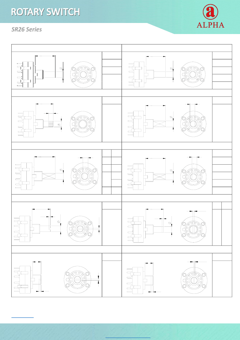

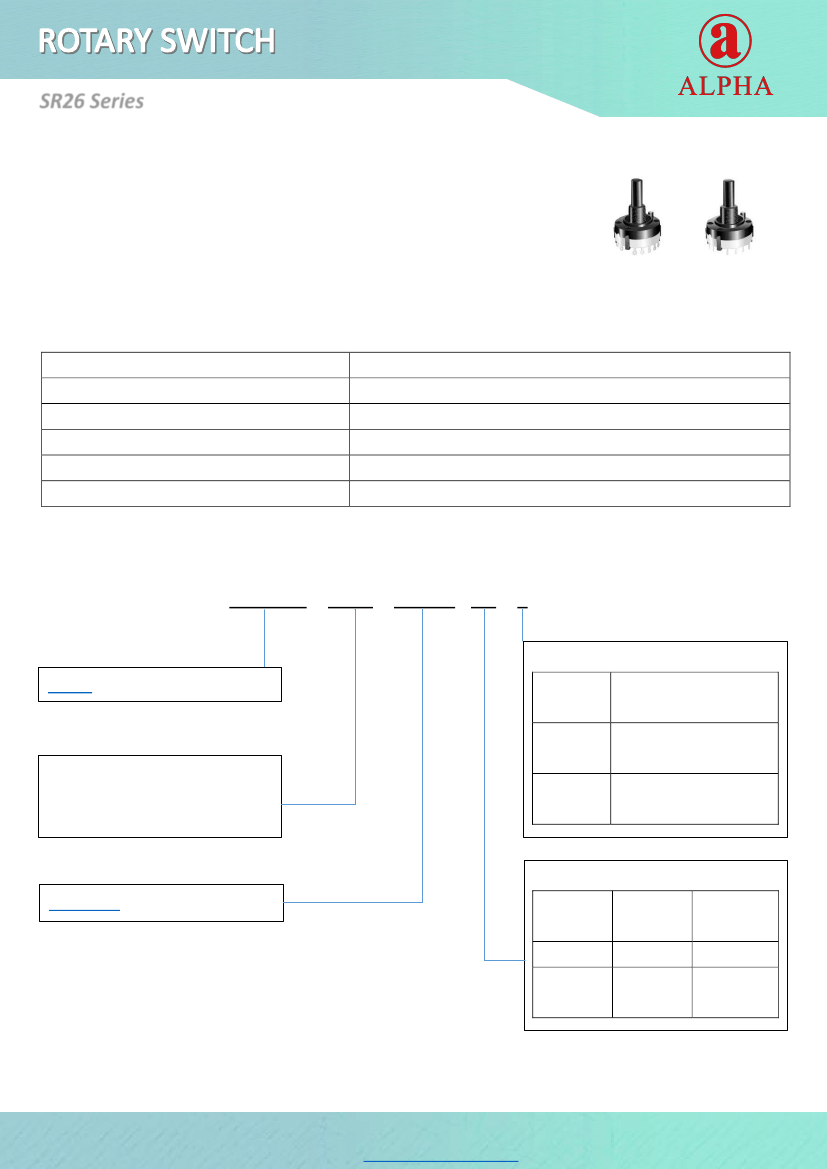

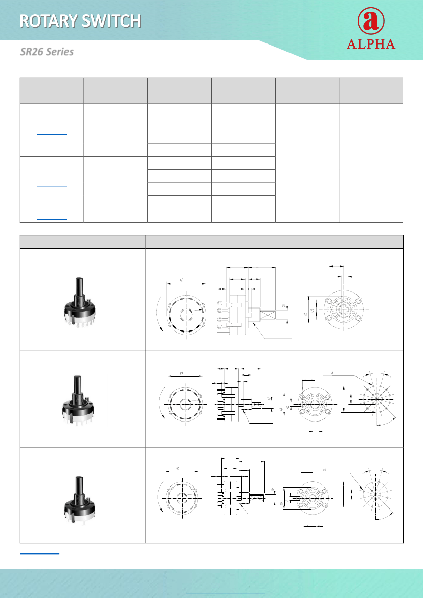

SR26 Series
Application
TV/Video, Audio, Home appliance, Precision apparatus,
Automotive, Musical instruments, Industrial control, Others
Feature
Up to 12 positions general use rotary switches with optional plastic
shafts.
Specification
Rating
Withstand Voltage
Contact Resistance
Insulation Resistance
Rotational Torque
Operating Life Cycle
How to order
125V AC 0.3A
500V AC - 1 minute
50 mΩ Max.
500V DC - 100MΩ Min.
0.2 kgf.cm
10,000 cycles
SR2612F – 0102 – 15F5B – D8 – S
Timing
Model
Order
Code
Number of Pole & Position
Ex. 0102 – 1 pole 2 positions
0402 – 4 poles 2 positions
N
Shorting
(make-before-break)
Non-shorting
(break-before-make)
Bushing Type
Shaft Type
Order
Code
D1
D8
Bushing
Length
8mm
8mm
Bushing
Diameter
M10*0.75
3/8”-
32NEF
TAIWAN ALPHA ELECTRONIC CO., LTD.
Contact:
sales@taiwanalpha.com.tw
