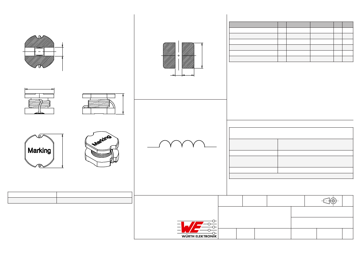

Product Marking:
Start of Winding
Marking
1R0 (Inductance Code)

Typical Inductance vs. Current Characteristics:
1.2

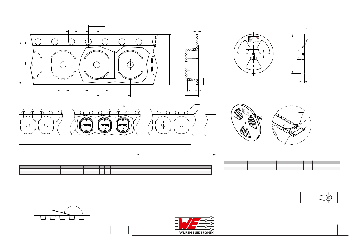

Packaging Specification - Tape and Reel: [mm]
P0
D0
P2
E1
W3
W1
close to center
N
W2
E2
B0
top cover
tape
D1
A0
P1
K0
T2
Carrier tape
Cover tape
T1
detail B
Cover Tape
Chip Cavity
Sprocket Hole
End
Feeding direction
Start
No Component
min. 160 mm
Components
No Component
min. 100 mm
Cover Tape
min. 400 mm
Embossment
Packaging is referred to the international standard
IEC 60286 -3:2013
tolerance
size
A0 B0 B1 G W
typ. typ. typ. typ. +0,3/ -0,1
3521 3.25 3.60 4.30
12.00
T1 T2 K0 P0 P1 P2 D0
typ. typ. typ. typ. ±0,1
+0,1/ -0,0
0.30 0.06 2.65 2.45 4.00 8.00 2.00 1.50
D1 E1
typ. +0,1
1.50 1.75
-0,0
E2
Tape Type 2a
min.
10.25 5.50
VPE / packaging unit
pcs.
3000
tolerance
Tape width
12 mm
± 2,0
330.00
min.
1.50
min.
12.80
min.
20.20
N
min.
60.00
W1
+2
12.40
W2
max.
18.40
W3
min.
11.90
W3
max.
15.40

Pull-of force
Tape width
12 mm
0,1 N - 1,3 N
