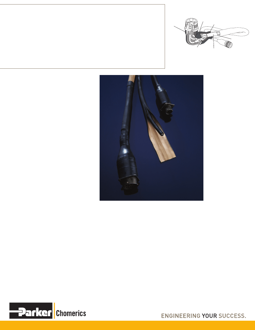

CHO-SHRINK
1120
Commercial Grade Conductive Heat
Shrinkable EMI Cable Shielding System
Tubing • Connector Boots • Cable Transitions • Boot Adapters
CHO-BOND
Adhesive/Sealant
CHO-SHRINK 90° Boot (Conductive Side)
CHO-BOND Adhesive/Sealant
CHO-SHRINK Tubing
(Conductive Inside)
Conductive Grommet
For Shield Grounding
CHO-SHRINK Continuity Splice (Conductive Outside)
Customer Value Proposition
Chomerics’ Silver Plated Copper CHO-SHRINK
1120 is formulated and manufactured for
commercial EMI cable shielding applications
to provide a low cost, light weight, 360° EMI
shielding for cables, transitions, connectors and
terminations. CHO-SHRINK’s ease of application
reduces assembly costs and provides a reliable,
professional looking EMI cable shielding solution
for electronic equipment. CHO-SHRINK also
provides an effective shielding solution which
simplifies connector and termination designs.
The product consists of polyolefin heat shrink-
able tubing, connector boots, and transition
pieces that are coated with Chomerics’ unique
silver-plated copper filled coating system.
The CHO-SHRINK cable shielding system al-
lows for relatively easy assembly of shielding
systems for complex cable wiring harnesses
using conventional heat shrink tubing heating
devices. The system offers excellent shielding
and significant weight savings over traditional
metal braid cable shielding systems.
In addition, CHO-SHRINK offers an environ-
mental shield against dust, moisture and other
contaminants. CHO-SHRINK's unique flexible
coating remains intact even after maximum
shrinkage to support any necessary cable rout-
ing. Easy repair or rework of cables is facilitated
by cutting off the CHO-SHRINK material and
installing new material.
CHO-SHRINK materials are ideal for installa-
tion on cabling for medical device electronic
assemblies which require reliable EMI shield-
ing performance and may benefit from silver’s
antimicrobial properties.
Typical applications include automotive cable
assemblies, laboratory equipment, medical
electronics, and telecom cabling.
Product Features
• Good 360°
cable
shielding effectiveness
performance, 50 - 60 dB attenuation
above 500 MHz
• Provides professional looking appearance
to cable shielding solutions
• Simplifies connector and transition
shielding designs
• Easy installation and assembly with
conventional heat guns and ovens
• Professional appearance
• Excellent seal against moisture and
contaminants
• Complex cable assembly EMI shielding
possible with a wide selection of cable
transitions, including T, Y, and other
custom shapes
• Standard (stocked) lengths for tubing
are 4 feet. Transition tubing sections are
available for longer lengths.
• Unique coating system can be applied
internal or external to the heat
shrinkable tubing
• Weight savings from 40 – 65% vs.
conventional braided mesh shielding
systems with labor savings as well
• CHO-SHRINK cable assemblies remain
flexible after installation
• CHO-SHRINK connector boots provide
EMI shielding, cable shield grounding,
and strain relief at connector backshell
terminations.
• CHO-SHRINK boots shrink to a wide
range of cable diameters (shrink ratio
is 4:1 at the cable end). They can be
supplied with a conductive hot melt
adhesive/sealant applied to each end.
• Mil-R-46846 Polyolefin Tubing and Boots
