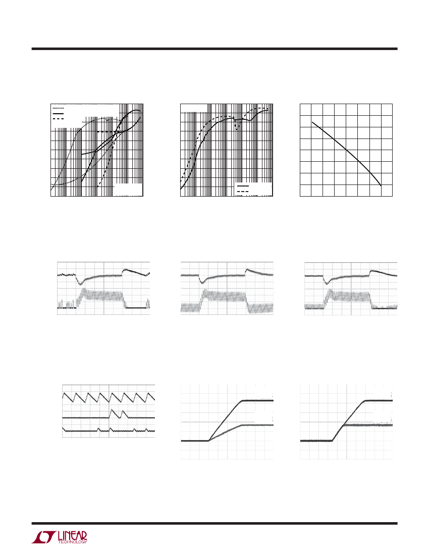

LTC3826
30µA I
Q
, Dual, 2-Phase
Synchronous Step-Down Controller
DESCRIPTION
The LTC
3826 is a high performance dual step-down
switching regulator controller that drives all N-channel
synchronous power MOSFET stages. A constant frequency
current mode architecture allows a phase-lockable fre-
quency of up to 650kHz. Power loss and noise due to the
ESR of the input capacitor are minimized by operating the
two controller output stages out of phase.
The 30μA no-load quiescent current extends operating
life in battery powered systems. OPTI-LOOP compensa-
tion allows the transient response to be optimized over
a wide range of output capacitance and ESR values. The
LTC3826 features a precision 0.8V reference and a power
good output indicator. A wide 4V to 36V input supply range
encompasses all battery chemistries.
Independent TRACK/SS pins for each controller ramp the
output voltage during start-up. Current foldback limits
MOSFET heat dissipation during short-circuit conditions.
The PLLIN/MODE pin selects among Burst Mode opera-
tion, pulse skipping mode, or continuous inductor cur-
rent mode at light loads. For a leaded package version
(28-lead SSOP), see the LTC3826-1 data sheet.
L,
LT, LTC and LTM are registered trademarks of Linear Technology Corporation.
Burst Mode and OPTI-LOOP are registered trademarks of Linear Technology Corporation.
All other trademarks are the property of their respective owners. Protected by U.S. Patents,
including 5481178, 5929620, 6177787, 6144194, 5408150, 6580258, 6304066, 5705919.
Wide Output Voltage Range: 0.8V ≤ V
OUT
≤ 10V
Ultralow Operating I
Q
: 30μA (One Channel On)
Out-of-Phase Controllers Reduce Required Input
Capacitance and Power Supply Induced Noise
OPTI-LOOP
Compensation Minimizes C
OUT
±1% Output Voltage Accuracy
Wide V
IN
Range: 4V to 36V Operation
Phase-Lockable Fixed Frequency 140kHz to 650kHz
Selectable Continuous, Pulse Skipping or
Low Ripple
Burst Mode
Operation at Light Loads
Dual N-Channel MOSFET Synchronous Drive
Very Low Dropout Operation: 99% Duty Cycle
Adjustable Output Voltage Soft-Start or Tracking
Output Current Foldback Limiting
Power Good Output Voltage Monitor
Output Overvoltage Protection
Low Shutdown I
Q
: 4μA
Internal LDO Powers Gate Drive from V
IN
or V
OUT
Small 5mm
5mm QFN Package
APPLICATIONS
n
n
n
Automotive Systems
Battery-Operated Digital Devices
Distributed DC Power Systems
TYPICAL APPLICATION
High Efficiency Dual 8.5V/3.3V Step-Down Converter
IN
4V TO 36V
4.7μF
IN
TG1
3.3μH
0.1μF
BOOST1
SW1
BG1
LTC3826
SENSE1
0.015Ω
OUT1
3.3V
5A
SENSE1
FB1
62.5k
150μF
220pF
20k
15k
TH1
SENSE2
FB2
TH2
220pF
15k
20k
192.5k
INTV
CC
TG2
EFFICIENCY (%)
BOOST2
SW2
BG2
PGND
SENSE2
0.015Ω
OUT2
8.5V
3.5A
150μF
0.1μF
7.2μH
22μF
50V
90
FIGURE 13 CIRCUIT
0.1
0.00001 0.0001 0.001 0.01
0.1
OUTPUT CURRENT (A)
3826 TA01b
Efficiency and Power Loss
vs Load Current
10000
1000
POWER LOSS (mW)
TRACK/SS1 SGND TRACK/SS2
0.1μF
0.1μF
3826 TA01
3826fc
