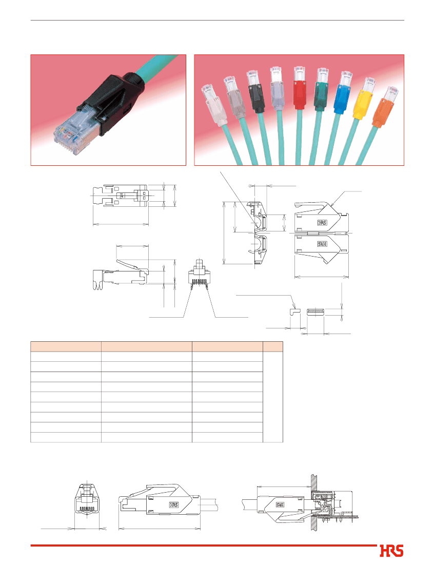

Modular Plug Connectors Compliant to Enhanced Category 5 Standards
TM21P Series (Shielded Type)
TM22P-88P (Non-shielded Type)
Nov.1.2018 Copyright 2018 HIROSE ELECTRIC CO., LTD. All Rights Reserved.
1. Supports High-Speed LAN Transmission
Conforms to requirements of TIA/EIA-568B data
wiring standard, meeting transmission performance
of Enhanced Category 5.
Supports Gigabit Ethernet (1000BASE-T) and Fast
Ethernet (100BASE-TX) high-speed LAN
transmission.
Protected latch tab
2. EMI protection (TM21*P-88P)
360
coverage of the engagement area with a metal
shield assures protection against electromagnetic
interference. When mated with corresponding
connector the shield surfaces are securely
connected to provide continuous circuit.
3. Protected latch tab (TM21P-88P)
Flexible case extends over the release tab
preventing the possibility of breaking-off during
handling of the complete cable assembly.

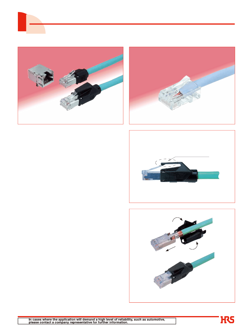

4. Termination of conductors
Self located 24 AWG conductors (solid or stranded)
are terminated against pre-inserted contacts using
simple tooling.
5. Simplified termination (TM21*P-88P)
Removeable one piece cover allows easy access to
the termination areas.
6. Conforms to the ISO 8877 Standard
(ISDN Interface Connector)
Telecom Hubs, Routers, Bridges and ATM
Transmission Equipment, Ethernet Switches and
Networking Equipment, Test and Measurement
Equipment and other equipment requiring this type of
simple and reliable connection.
Cover Installation Procedure
