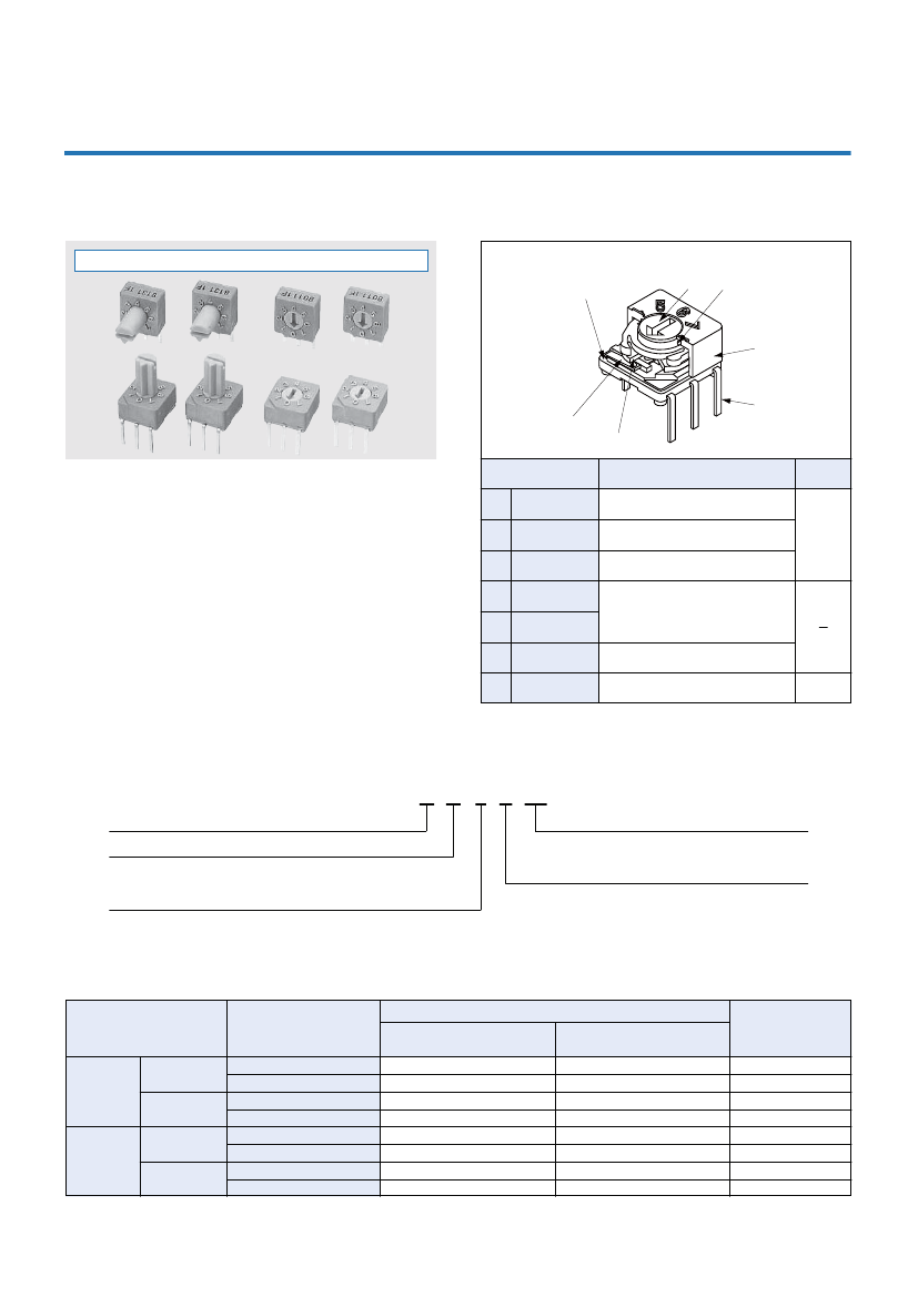

ROTARY CODED SWITCHES
S-8000
INTERNAL STRUCTURE
RoHS compliant
Part name
Material
Polyoxymethylene
Silicone rubber
Polybutyleneterephthalate
UL94HB
Flammability
O
RoHS compliant
O
3 bits 8 positions type
O
Protection against dust and washable after soldering
O
DIP-pin configuration: 2.54 mm pitch
Rotor
“O” ring
Base
Terminal pin
Copper alloy, Gold-plated
Contact
P.C.B.
Housing
Gold-plated epoxy board
UL94HB
PART NUMBER DESIGNATION
S - 8 0 1 0 W
Series name
Shape of rotor
Without knob
With knob (extended shaft)
Form of packaging
Tray packaging
Blank
Plastic bag
Setting position
Top setting
Side setting
Code format
Real code
Complementary code
LIST OF PART NUMBERS
Binary coded octal
Shape
Form of packaging
Tray packaging
Plastic bag
Tray packaging
Plastic bag
Tray packaging
Plastic bag
Tray packaging
Plastic bag
Real code
S-8010W
S-8010
S-8110W
S-8110
S-8011W
S-8011
S-8111W
S-8111
Complementary code
S-8030W
S-8030
S-8130W
S-8130
S-8031W
S-8031
S-8131W
S-8131
Pieces in package
50 pcs./tray
100 pcs./pack
50 pcs./tray
100 pcs./pack
50 pcs./tray
100 pcs./pack
50 pcs./tray
100 pcs./pack
Without knob
Top setting
With knob
Without knob
Side setting
With knob
Verify the above part numbers when placing orders.
Tray version can be supplied only in tray units.
