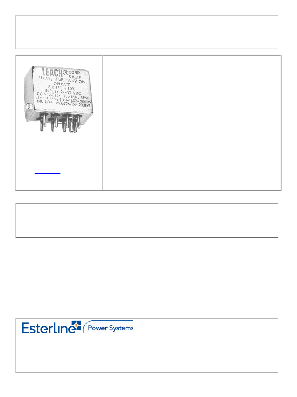

TDH-1609
ENGINEERING DATA SHEET
OPERATE-FIXED 28VDC
1PSTNO (SSO)
q
q
q
q
q
q
q
Small size and weight
High-reliability design
Hermetically sealed
High transient immunity
Qualified to MIL-PRF-83726/24
Compatible with M12883/52 & /53 socket module and track mount
Reverse Polarity Protection
PRINCIPLE TECHNICAL CHARACTERISTICS
Enclosure:Hermetic Sealed per MIL-STD-
883, Method 1014 Condition B,C
Finish: per MIL-T-10727
Terminals:
Gold Plate per MIL-G-45204
Type II, Class 2, Grade C
Weight
Yes
Tin Plate
Plug-in
M12883/52 = SOCKET
M12883/53 = TRACK
0.56 Ounce max.
APPLICATION NOTE:
101
APPLICABLE SOCKETS:
SM-1000-003
DESCRIPTION
The TDH-1609 Time Delay Relays have been designed with thick film hybrid microelectronics timing circuits and
are packaged in a hermetically sealed military style enclosure. The TDH-1609 series are qualified to MIL-PRF-
83726/24 and designed to withstand severe environmental conditions encountered in military/aerospace
applications. These relays are suited for use in power control, communication circuits and many other
applications where power switching and high reliability are required over a wide temperature range.

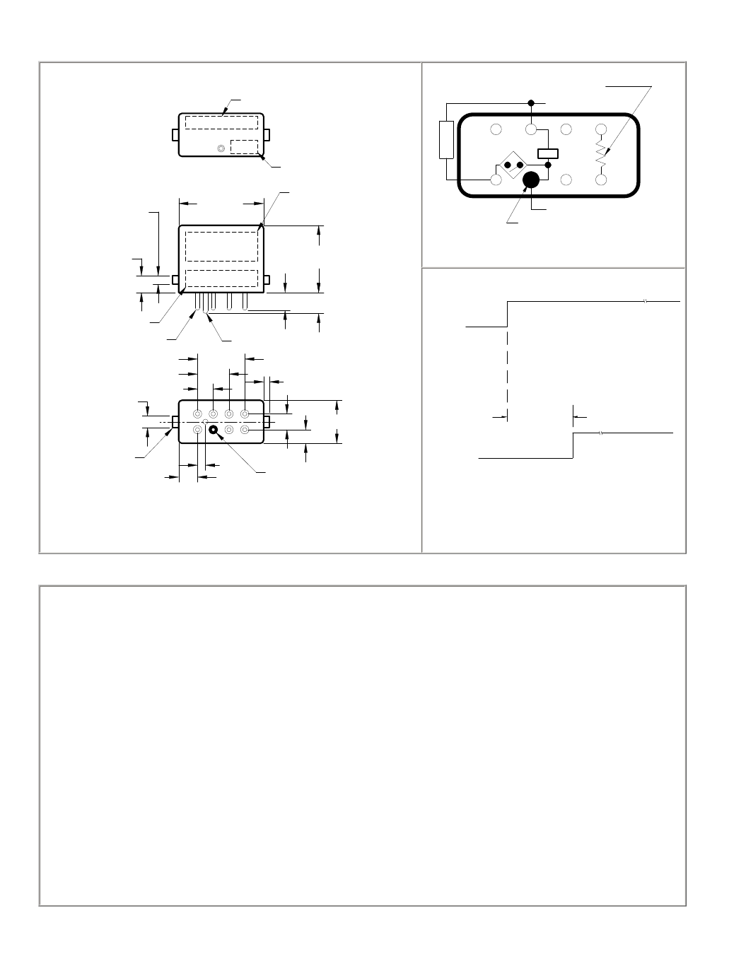

MECHANICAL SPECIFICATIONS
TDH-1609
RESISTOR INTERNALLY
CONNECTED
COMMON(-)
X2
TD
MILITARY PART NUMBER & DATA
B1
10K
A1
LOAD
SERIAL NUMBER
NAMEPLATE (FAR SIDE)
CIRCUIT DIAGRAM (NEAR SIDE)
A3
X1
.080 ±.005
2 PLACES
.810 MAX
20-32 VDC(+)
CONTRASTING BEAD
.158 ±.003
FROM FACE
OF HEADER
2 PLACES
.640
MAX
FIXED TIME DELAY
20-32 VDC
0 VDC
X1-X2
.170
8 PLACES .200
DATE CODE (NEAR SIDE)
.040 ±.001 DIA, 8 PINS
FINISH: PARA 3.4.2.
.450
.300
.150
.110 ±.005
2 PLACES
.15
.13
.010-.015R
4 PLACES
.18
.410 MAX
.055 ±.005
2 PLACES
.050 ±.001 DIA POLARIZING PIN
INPUT
VOLTAGE
TIME DELAY
OUTPUT DE-ENERGIZED
A3-X2
ENERGIZED
.07
CONTRASTING BEAD
DIMENSIONS ARE SHOWN IN INCHES.
TIME DELAY ON OPERATE
NOTES
[1] The accuracy specification applies for any combination of operating temperature and voltage.
[2] The accuracy will not be affected by power interruptions up to 1 millisecond, spaced at least 10 milliseconds
apart. Transient and power loss specifications are based on a maximum duty cycle of 1/50.
[3] EMI test limits will not be exceeded during the timing interval or when continuously energized under steady
state conditions, per paragraph 3.23, MIL-PRF-83726C.
[4] Terminals X1, X2, A1, B1 and A3 must be connected together during the test. Dielectric withstanding voltage
and insulation resistance are measured at sea level between all mutually insulated terminals and between all
terminals and case.
[5] Recycle time is defined as the minimum time power must be removed from terminal X1 to assure that a new
cycle can be completed within the specified timing tolerance.
[6] A four digit number defines the time delay in seconds (or milliseconds). The first three digits are significant
figures, used to define the specific time delay. The fourth digit represents the number of zeros to follow the first
three digits.
Examples:
- 1001 = 1 second (1,000 milliseconds)
- 2502 = 25 seconds (25,000 milliseconds)
- 5000 = 0.5 seconds (500 milliseconds)
[7] Quality level as specified in MIL-R-83726, paragraph 3.1.1, 3.1.2 and 3.1.3.

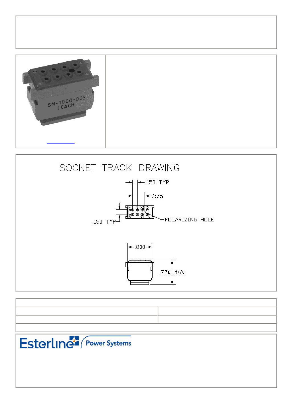

SM-1000-003
TRACK MOUNT RELAY SOCKET
5 AMP
BASIC SOCKET SERIES DESIGNATION FOR:
Series X (Track Mount)
Series TD-1609, TD-1610 (Track Mount)
QUALIFIED TO:
MIL-DTL-12883/52-001
APPLICABLE TRACK:
MT-3000-03
GENERAL CHARACTERISTICS
1. Supplied with No. 20 contacts and No. 20 crimp.
2. Standard tolerances
3. Weight
4. Used in conjunction with MT-3000-003
AMERICAS
6900 Orangethorpe Ave.
P.O. Box 5032
Buena Park, CA 90622
Tel: (01) 714-736-7599
Fax: (01) 714-670-1145
EUROPE
2 Rue Goethe
57430 Sarralbe
France
Tel: (33) 3 87 97 31 01
Fax: (33) 3 87 97 96 86
ASIA
Units 602-603 6/F Lakeside 1
No.8 Science Park West Avenue
Phase Two, Hong Kong Science Park
Pak Shek Kok, Tai Po, N.T.
Hong Kong
Tel: (852) 2 191 3830
Fax: (852) 2 389 5803
.xx ±.01; xxx ±.005.
.016 lb. max.
Featuring
LEACH
power and control solutions
www.esterline.com
Data sheets are for initial product selection and comparison. Contact Esterline Power Systems prior to choosing a component.
