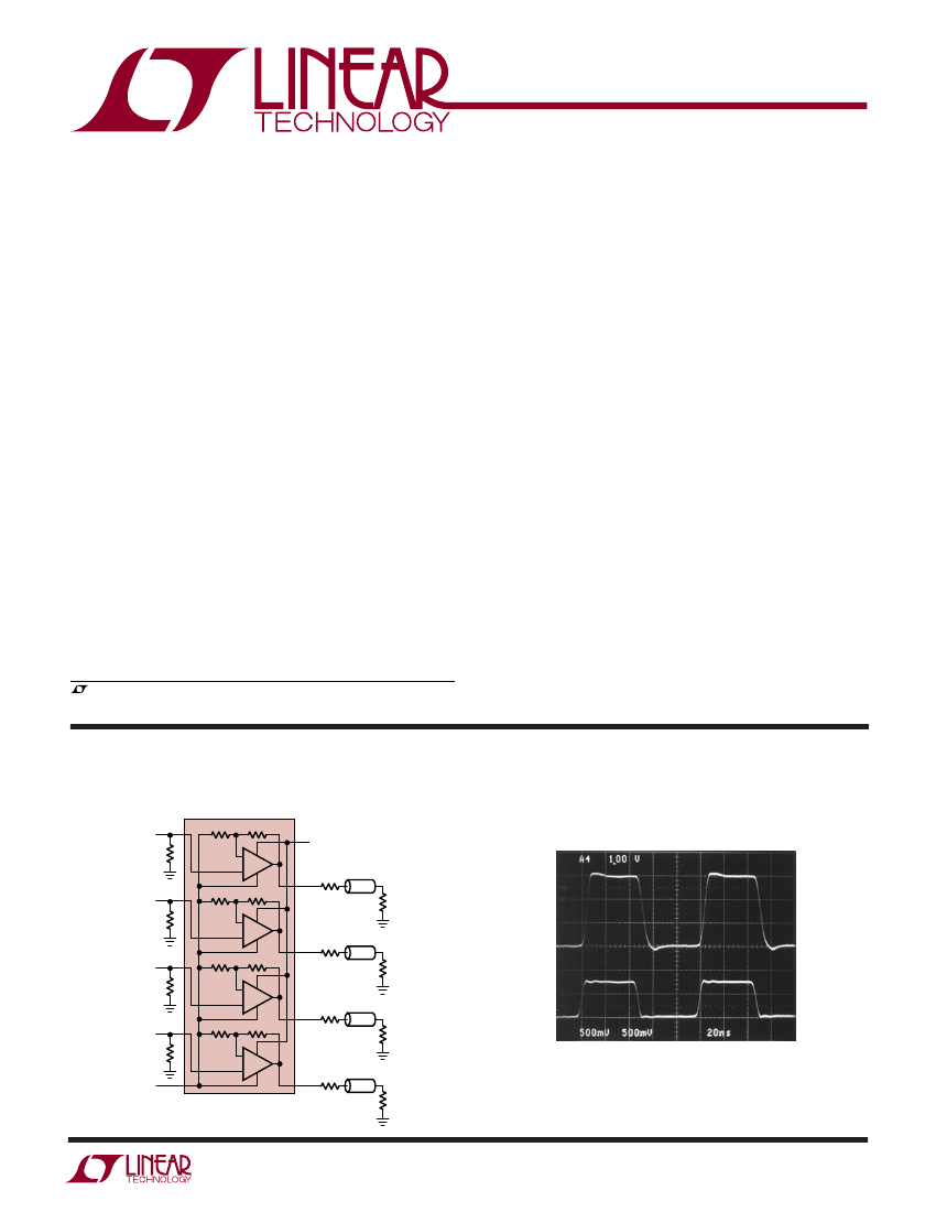

LT6550/LT6551
3.3V Triple and Quad
Video Amplifiers
DESCRIPTIO
Single Supply Operation from 3V to 12.6V
Small (3mm
5mm) MSOP 10-Lead Package
Internal Resistors for a Gain of Two
340V/µs Slew Rate
110MHz –3dB Bandwidth
30MHz Flat to 0.25dB
3% Settling Time: 20ns
Input Common Mode Range Includes Ground
Rail-to-Rail Output
High Output Drive: 60mA
Operating Temperature Range: – 40°C to 85°C
24-Bit RGB
The LT
6550/LT6551 are 3.3V triple and quad high speed
video amplifiers. These voltage feedback amplifiers drive
double terminated 50Ω or 75Ω cables and are configured
for a fixed gain of 2, eliminating six or eight external gain
setting resistors. The LT6550/LT6551 feature 110MHz
–3dB bandwidth, high slew rates and fast settling, making
them ideal for RGB video processing.
The LT6551 quad is designed for single supply operation
and the LT6550 triple can be used on either single or split
supplies. On a single 3.3V supply, the input voltage range
extends from ground to 1.55V and the output swings to
within 400mV of the supply voltage while driving a 150Ω
load. These features, combined with the ability to accept
RGB video signals without the need for AC coupling or
level shifting of the incoming signals, make the LT6550/
LT6551 an ideal choice for low voltage video applications.
Both the LT6550 and LT6551 are available in the small
10-Pin MSOP package and utilize a flow-thru pin out. The
small footprint results in a compact high performance
video amplifier solution.
APPLICATIO S
Automotive Displays
LCD and CRT Compatible
RGB Amplifiers
Coaxial Cable Drivers
Low Voltage High Speed Signal Processing
Set Top Boxes
, LTC and LT are registered trademarks of Linear Technology Corporation.
All other trademarks are the property of their respective owners.
TYPICAL APPLICATIO
LT6551
450Ω
IN
75Ω
OA
450Ω
IN
75Ω
OA
450Ω
IN
75Ω
OA
450Ω
SYNC
IN
75Ω
OA
450Ω
450Ω
450Ω
450Ω
3.3V Single Supply LT6551 RGB Plus SYNC Cable Driver
Output Step Response
3.3V
OUT
75Ω
75Ω
OUT
75Ω
75Ω
OUT
75Ω
75Ω
IN
0V
= 3.3V
IN
= 0.5V TO 1.25V
f = 10MHz
6550/51 TA01b
75Ω
SYNC
OUT
75Ω
6551 TA01a
GND
U
OUT
0V
65501fa
