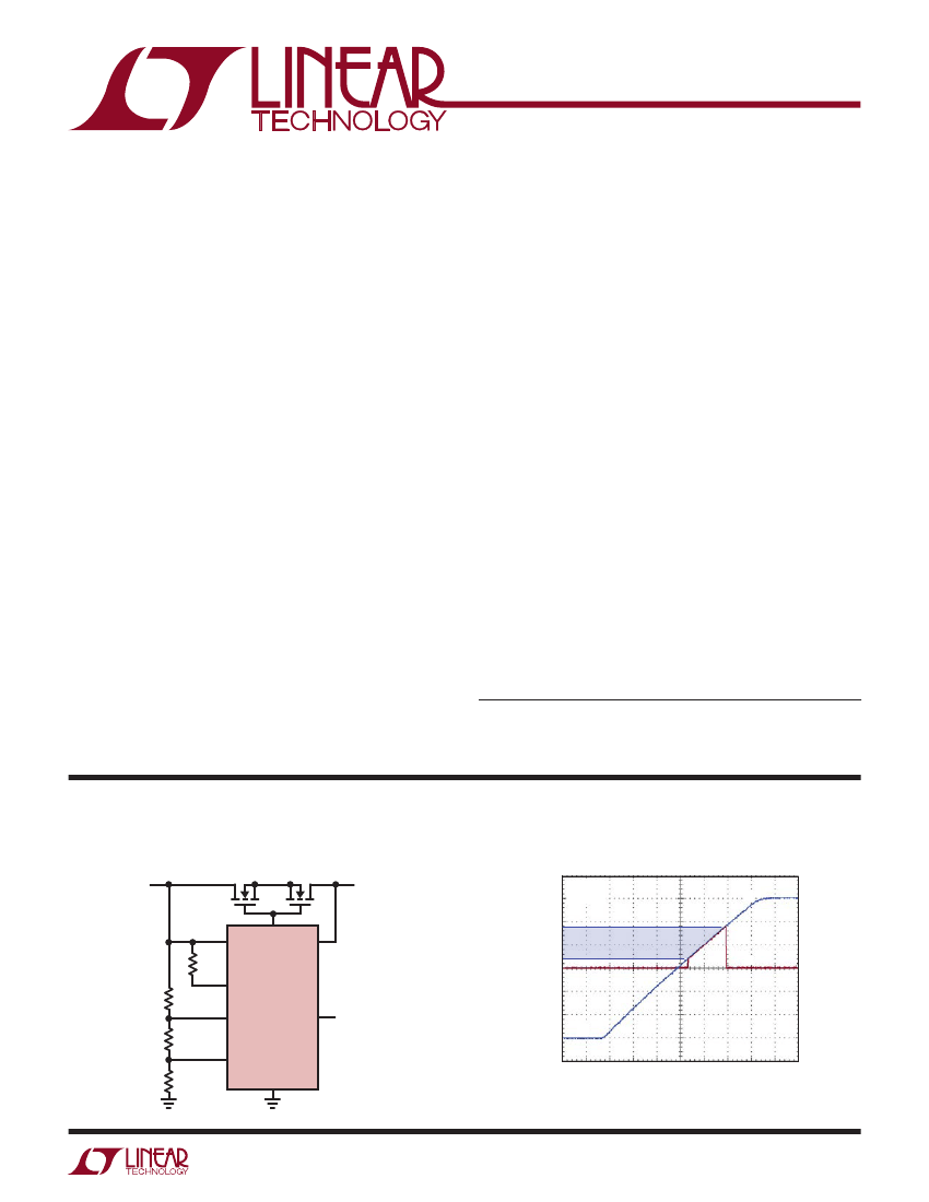

FeaTures
n
n
n
n
n
n
LTC4365
Overvoltage,
Undervoltage and Reverse
Supply Protection Controller
DescripTion
The
LTC
4365
protects applications where power supply
input voltages may be too high, too low or even negative.
It does this by controlling the gate voltages of a pair of
external N-channel MOSFETs to ensure that the output
stays within a safe operating range.The LTC4365 can
withstand voltages between –40V and 60V and has an
operating range of 2.5V to 34V, while consuming only
125µA in normal operation.
Two comparator inputs allow configuration of the over-
voltage (OV) and undervoltage (UV) set points using an
external resistive divider. A shutdown pin provides external
control for enabling and disabling the MOSFETs as well
as placing the device in a low current shutdown state. A
fault output provides status of the gate pin pulling low. A
fault is indicated when the part is in shutdown or the input
voltage is outside the UV and OV set points.
The LTC4365 has a 36ms turn-on delay that debounces
live connections and blocks 50Hz to 60Hz AC power. For
fast recovery after faults, the LTC4365-1 has a reduced
1ms turn-on delay.
L,
LT, LTC, LTM, Linear Technology and the Linear logo are registered trademarks and
ThinSOT and Hot Swap are trademarks of Linear Technology Corporation. All other trademarks
are the property of their respective owners.
n
n
n
n
n
Wide Operating Voltage Range: 2.5V to 34V
Overvoltage Protection to 60V
Reverse Supply Protection to –40V
LTC4365: Blocks 50Hz and 60Hz AC Power
LTC4365-1: Fast (1ms) Recovery from Fault
No Input Capacitor or TVS Required for Most
Adjustable Undervoltage and Overvoltage
Protection Range
Charge Pump Enhances External N-Channel MOSFET
Low Operating Current: 125µA
Low Shutdown Current: 10µA
Compact 8-Lead, 3mm × 2mm DFN and
TSOT-23 (ThinSOT™) Packages
applicaTions
n
n
n
n
Portable Instrumentation
Industrial Automation
Laptops
Automotive Surge Protection
Typical applicaTion
12V Automotive Application
IN
12V
Si4946
OUT
3A
Load Protected from Reverse and Overvoltage at V
IN
30V
VALID
WINDOW
GND
OUT
UV = 3.5V
OV = 18V
IN
IN
510k
1820k
UV
243k
OV
59k
GATE
LTC4365
OUT
OUT
SHDN
FAULT
10V/DIV
–30V
OV = 18V
UV = 3.5V
4365 TA01a
IN
GND
1s/DIV
4365 TA01b
4365fa
For more information
www.linear.com/LTC4365
