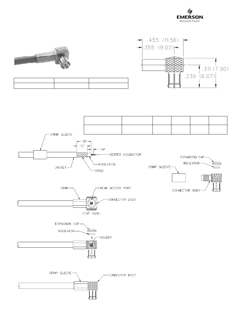

1. Identify connector parts. (4 piece parts except RG-
58)
2. Strip cable to dimensions shown. Do not nick braid or
center conductor. A wire stripper of correct size is
recommended for this step. Twist stranded center
conductor into tight bundle and tin (optional). Slide
crimp sleeve onto cable shown.
3. Flair braid and slide cable into body making certain that
the cable insulation bottoms on center contact. Arrange
braid uniformly around crimp stem. Slide crimp sleeve
over braid and crimp securely using recommended
crimp tool.
4. Solder center conductor to contact through rear access
port. Use a minimum amount of solder for a full fillet
joint.
.020 (0.51) diameter solder is recommended.
5. Assemble insulator if applicable then place expansion
cap in access port and seat with .156 (3.96) diameter
flat punch or MCX hand assembly tool 141-0000-908.
Shrink heat shrink tubing over crimp sleeve if applicable.

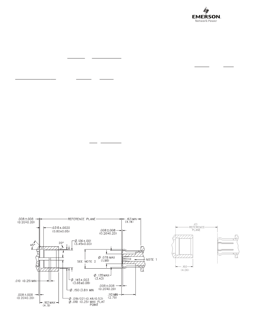

MATING ENGAGEMENT FOR MCX REVERSE POLARITY SERIES
PER FCC RULE 15 NON-STANDARD INTERFACE
JACK
PLUG
JACK
PLUG
†Avoid user injury due to misapplication.
See safety advisory definitions inside front cover.
** All gold plated parts include a .00005" min. nickel underplate barrier layer.
NOTES
1. ID of contact to meet VSWR mating characteristics and connector
durability when mated with a dia. .019-.021 (0.48-0.53) male contact.
2. Must meet the force to engage and disengage when mated with
mating part.
