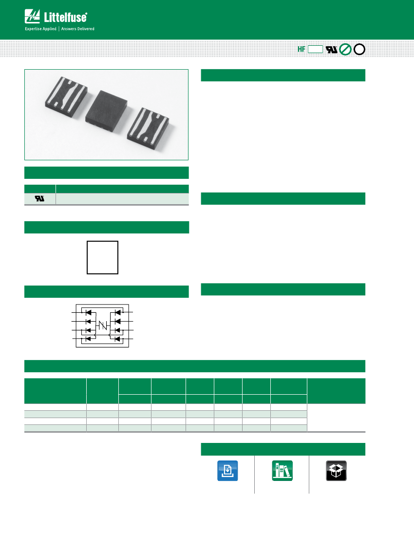

The new SEP (SIDACtor Thyristor Ethernet/PoE Protector)
series has a surge rating compatible with GR1089
Inter-building and ITU K.20/21 Enhanced protection
requirements. Targeted for high-speed applications such
as 10BaseT, 100BaseT, and 1000BaseT, the SEP series
maintains signal quality while providing robust protection
for Ethernet and PoE applications. This latest silicon design
innovation results in a capacitive loading characteristic
that is constant with respect to the voltage across the
device. This reduces distortion caused by typical solid-
state protection solutions. Offered in a surface-mount,
QFN package, the SEP provides small package size without
sacrificing power and surge handling capabilities.

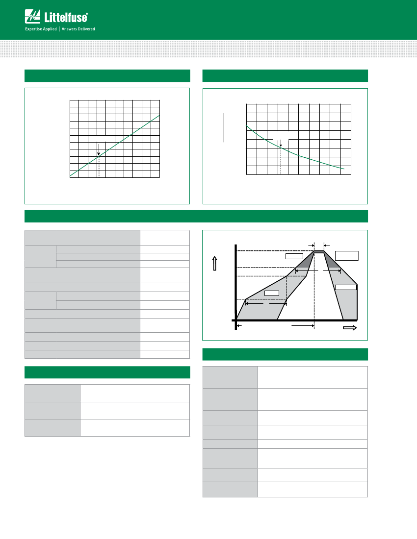

Normalized V
Change vs. Junction Temperature
Normalized DC Holding Current vs. Case Temperature
2.0
Percent of V
Change – %
-4
-6
-8
-40 -20
20 40 60 80 100 120 140 160
(T
= 25ºC)
1.8
1.6
1.4
1.2
0.8
0.6
0.4
-40
-20
100 120 140
160
25 °C
25°C
Ratio of
Junction Temperature (T
) – °C
Case Temperature (T
) - ºC

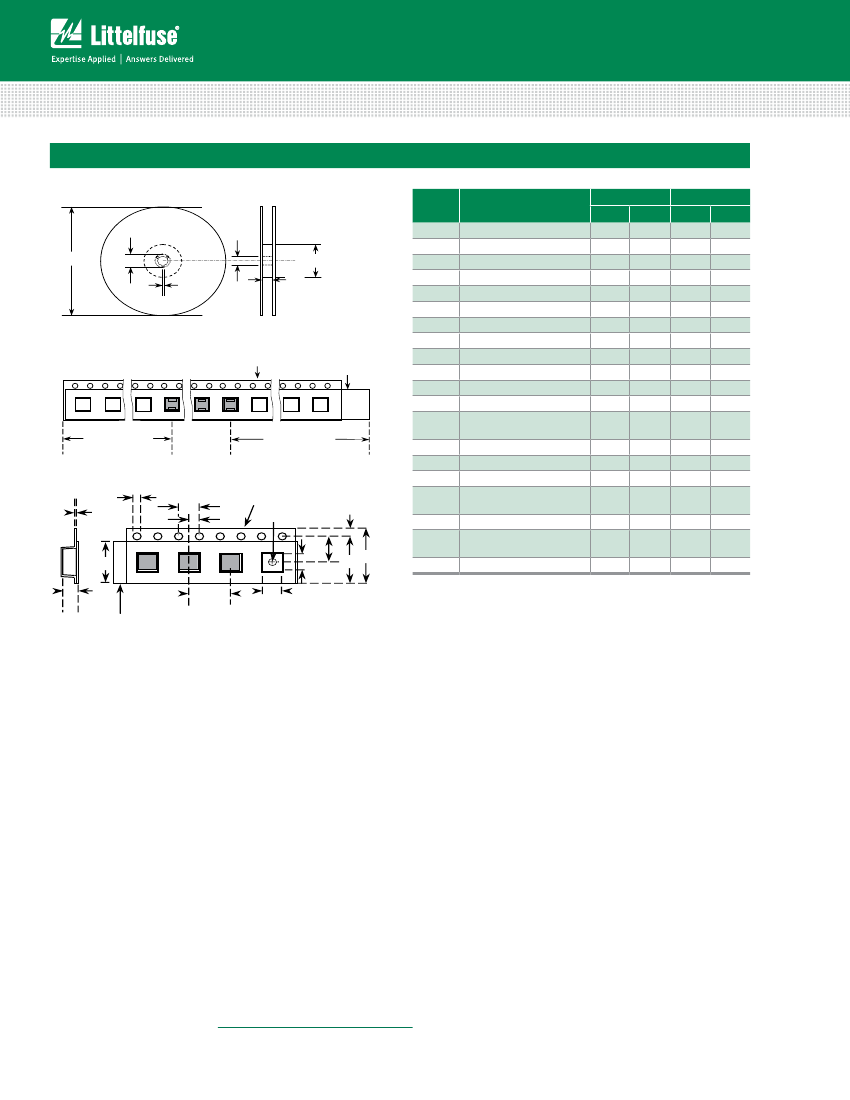

Tape and Reel Specifications — 5x6 QFN
Reel Dimension
Symbols
N
Tape Leader and Trailer Dimensions
END
CARRIER TAPE
COVER TAPE
START
N
K
TRAILER
160mm MIN
LEADER
400mm MIN
Tape Dimension Items
CARRIER TAPE
K
COVER TAPE
Min
Max
Min
Reel Diameter
N/A 12.992 N/A
Drive Spoke Width
0.059
N/A
1.50
Arbor Hole Diameter
0.504 0.531 12.80
Drive Spoke Diameter
0.795
N/A
20.20
Hub Diameter
1.969
N/A
50.00
Reel Inner Width at Hub 0.488 0.567 12.40
Pocket Width at Bottom 0.204 0.212 5.20
Pocket Length at Bottom 0.244 0.252 6.20
Feed Hole Diameter
0.059 0.063 1.50
Pocket Hole Diameter
0.059
N/A
1.50
Feed Hole Position 1
0.065 0.073 1.65
Feed Hole Position 2
0.400 0.408 10.15
Feed Hole Center -
0.212 0.220 5.40
Pocket Hole Center 2
Pocket Depth
0.067 0.075 1.70
Feed Hole Pitch
0.153 0.161 3.90
Component Spacing
0.311 0.319
.90
Feed Hole Center -
0.077 0.081 1.90
Pocket Hole Center 1
Carrier Tape Thickness
0.010 0.014 0.25
Embossed Carrier
0.460 0.484 11.70
Tape Width
Cover Tape Width
0.358 0.366 9.10
Inches
Millimeters
Max
330.0
N/A
13.50
N/A
N/A
14.40
5.40
6.40
1.60
N/A
1.85
10.35
5.60
1.90
4.10
8.10
2.10
0.35
12.30
