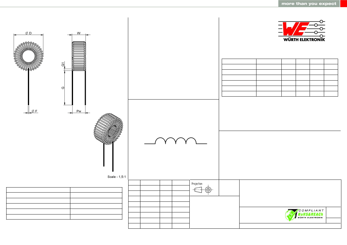

It is recommended that the temperature of the part does not exceed 105°C un-
der worst case operating conditions.
•Ambient temperature: -40°C to +65°C (refering to IR)
•Operating temperature: -40°C to +105°C
•Storage temperature (in tray packaging): -20°C to +40°C; 75% RH max.
•Test conditions of Electrical Properties: 20°C, 33% RH
if not specified differently
DESCRIPTION
ØD
W max.
G ±2
G1 min.
Pw ±1.5
Ø F ref.
32.0
16.5
12.0
13.0
5.0
4.0
REV
2015-05-20
2009-12-01
DATE
SSt
CZ
BY
HasA
CHECKED
Würth Elektronik eiSos GmbH & Co. KG
EMC & Inductive Solutions
Max-Eyth-Str. 1
74638 Waldenburg
Germany
Tel. +49 (0) 79 42 945 - 0
www.we-online.com
eiSos@we-online.com
