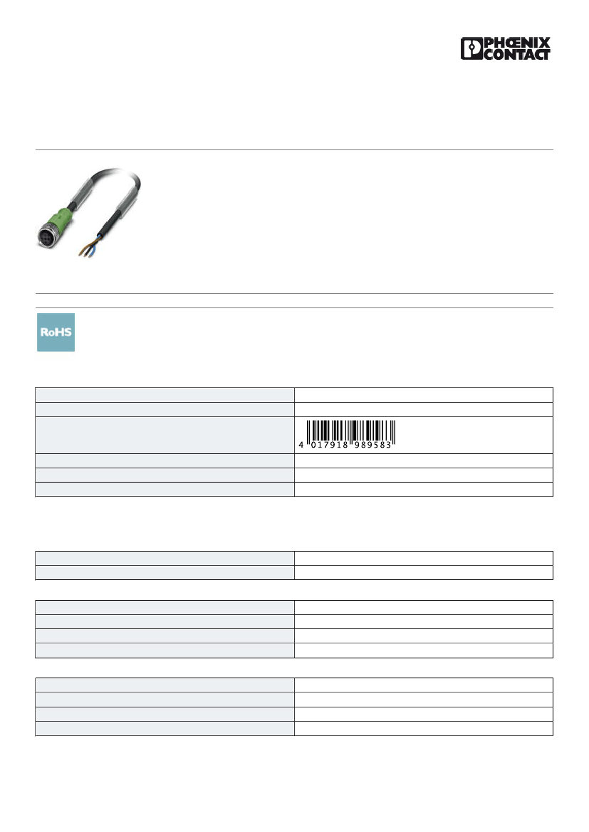

Sensor/Actuator cable - SAC-4P-25,0-PVC/M12FS VA - 1529454
Sensor/Actuator cable, 4-position, PVC, black RAL 9005, free cable end, on Socket straight M12, A-coded,
Cable length: 25 m
The illustration shows a 5-position
version

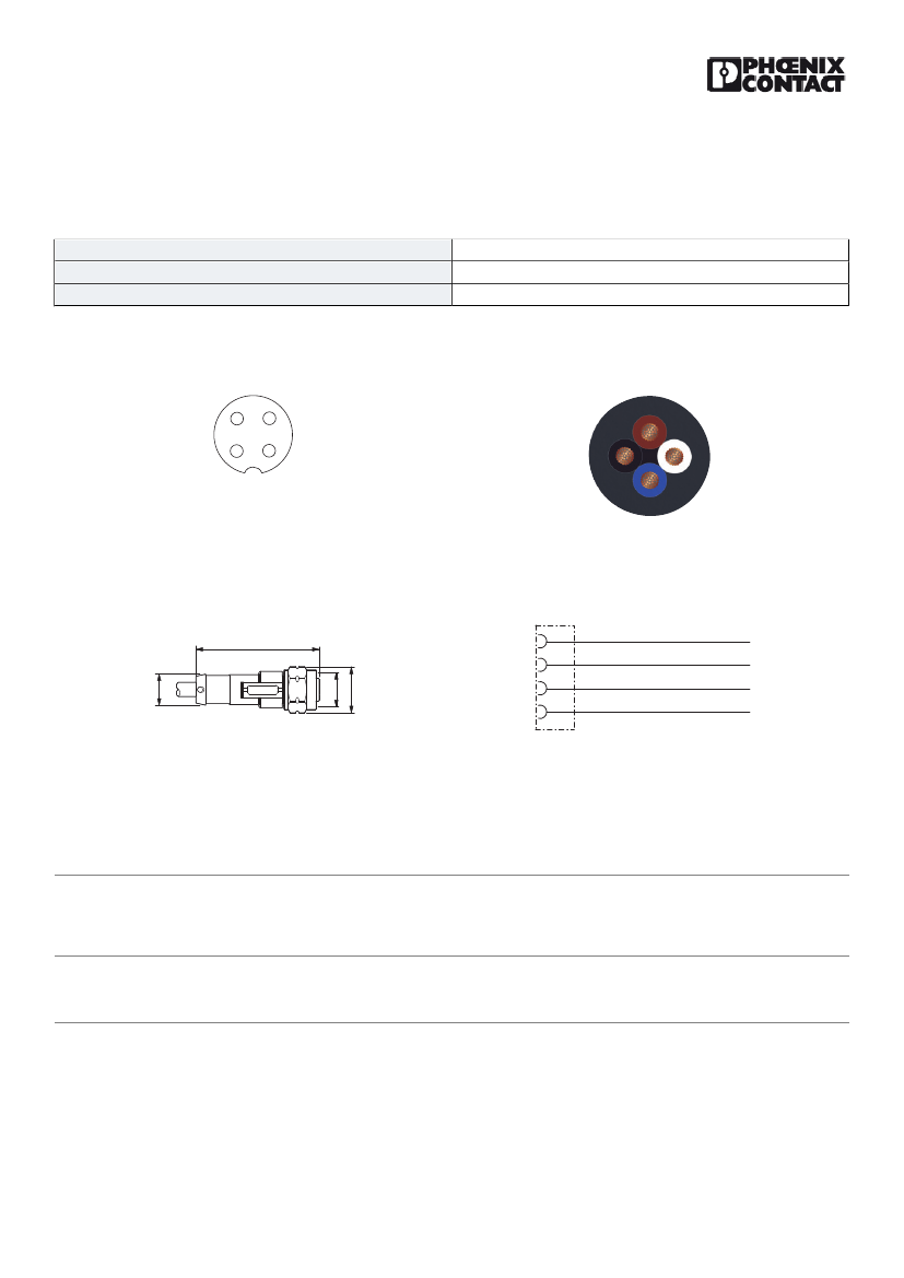

Drawings
Schematic diagram
Cable cross section
Pin assignment M12 socket, 4-pos., A-coded, view female side
PVC black [PVC]
Dimensional drawing
Circuit diagram
44
BN
WH
BK
BU
SW14
Ø11
M12
M12 x 1 socket, straight
Contact assignment of the M12 socket
