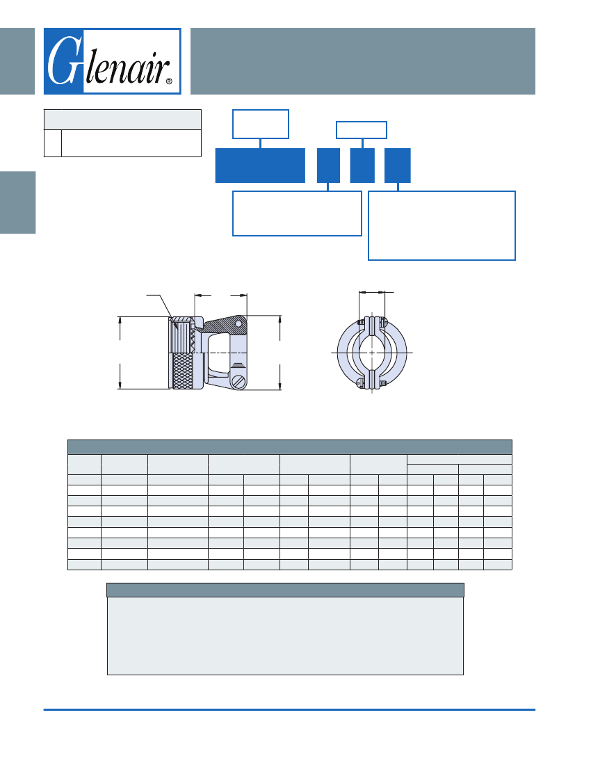

Self-Locking or Non-Self-Locking
CONNECTOR DESIGNATOR:
AS85049/38
Straight Strain Relief
AS85049
MIL-DTL-38999 Series III & IV
EN3645
Basic
Shell Size
FOR NEW DESIGN
USE AS85049/124
M85049/38
Material and Finish Designator
= Aluminum, Black Anodize
N
= Aluminum, Electroless Nickel
= 300 Series Steel, Passivated
= Aluminum, 500 Hour Cadmium
Olive Drab over Electroless Nickel
= Self-Locking
Use Dash for Non-Self-Locking
N
= Non-Detented
A Thread
Self-Locking
Only
Cable
Entry
Self-Locking Only
Note: Screw orientation shown is for
non-self-locking configuration. Screws
on self-locking configurations are on
the same side/face of the clamp.
TABLE I: Shell Size, Cable Entry and Backshell Dimensions
Shell
Size
17
19
21
23
Shell Size
Ref.
A Thread
Class 2B
M12 X 1 - 6H
M15 X 1 - 6H
M18 X 1 - 6H
M22 X 1 - 6H
M25 X 1 - 6H
M28 X 1 - 6H
M31 X 1 - 6H
M34 X 1 - 6H
M37 X 1 - 6H
Ø E Max
F Max
Self-Locking Only Self-Locking Only
.858
(21.8)
.91
(23.1)
.984
(25.0)
.91
(23.1)
1.157
(29.4)
1.01
(25.7)
1.279
(32.5)
1.06
(26.9)
1.406
(35.7)
1.16
(29.5)
1.516
(38.5)
1.41
(35.8)
1.642
(41.7)
1.51
(38.4)
1.768
(44.9)
1.66
(42.2)
1.889
(48.0)
2.76
(44.7)
Max
.85
(21.6)
.90
(22.9)
1.10 (27.9)
1.15 (29.2)
1.30 (33.0)
1.50 (38.1)
1.60 (40.6)
1.70 (43.2)
1.80 (45.7)
Cable Entry
Min
Max
.098 (2.5) .234 (5.9)
.153 (3.9) .234 (5.9)
.190 (4.8) .328 (8.3)
.260 (6.6) .457 (11.6)
.283 (7.2) .614 (15.6)
.325 (8.3) .634 (16.1)
.343 (8.7) .698 (17.7)
.381 (9.7) .823 (20.9)
.418 (10.6) .853 (21.7)
APPLICATION NOTES
1.
2.
3.
4.
Assembly to be identified with manufacturer’s name and part number, space permitting.
Cable Entry is defined as the accommodation entry for the wire bundle or cable.
Dimensions are not intended for inspection criteria.
For complete dimensions, see the applicable Military Specification.
Metric dimensions (mm) are in parentheses.
Dimensions in inches (millimeters) and are subject to change without notice.
