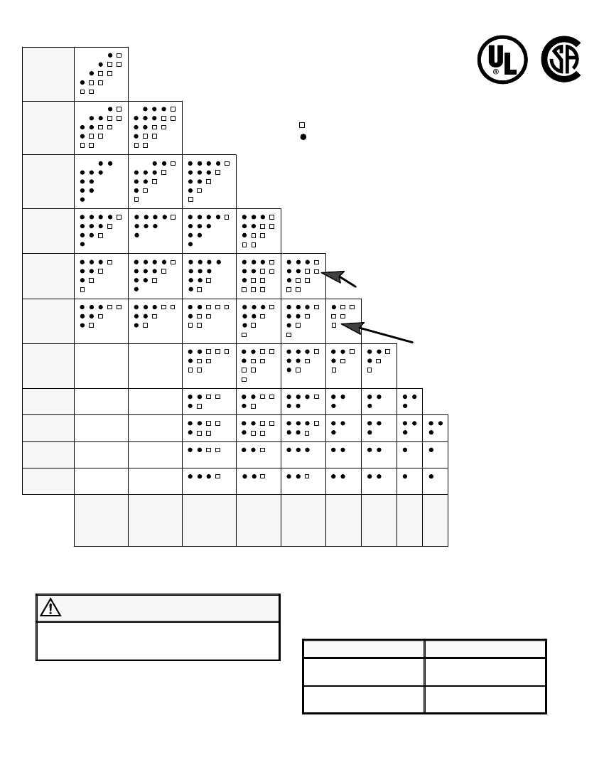

Insulated Electrical Spring
Connector 312
Data Sheet
Application:
Use a 312 connector to electrically connect two or more wire
ends in a pigtail application and insulate the connection, or to
insulate a single wire end.
Regulatory Agencies:
U.L. Listed — as a Pressure Cable Connector
Tested per UL Standard 486C
U.L. File No. E23438
Wire Range:
AWG Range
COPPER conductors only, No. 22 thru No. 10 solid or
stranded wire.
METRIC Range
COPPER conductors only, 0.75 mm
thru 4,0 mm
rigid
(solid or stranded) and flexible.
(See wire matrix for specific wire combinations.)
LISTED 540H
Canadian Standards
Association
Standard NO. 22.2
NO. 188–M1983
3M File NO. LR15503
Construction:
Spring
Insulator
–Spring steel, Corrosion resistant coating
–Flame retardant nylon, Color–Yellow
IEC Publications
685–1 and 685–2–4
3M File NO. E95240
Weight:
0.004 lb. (1.8 gm)
Abbreviations:
UL: Underwriters Laboratories
AWG: American Wire Gauge
CU: Copper sol.: solid, str.: stranded, mm: millimeters,
mm
: square millimeters,
_C:
degrees Celsius,
_F:
degrees Fahrenheit, gm: gram,
lb.: pound
OPERATING TEMPERATURE: 105_C (221_F)
VOLTAGE RATING: 600 volts maximum building wire;
1000 volts maximum in signs and lighting fixtures
(luminaries).
Federal Specification W–S–610:
Commercial Package Only
Class
Kind
cu
Style
Engineering Specification:
Electrical Spring Connector (3M™ part No. 312) shall be
capable of connecting wires within the range of No. 22 thru
No. 10 solid or stranded copper conductors, in a pigtail
application. The connector shall constructed of an active
(live) spring and covered by a nylon insulator. The spring
shall have a corrosion resistant coating. The connector shall
be UL Listed as a pressure cable connector, and be CSA
Certified. The connector shall be voltage rated 600 volts
maximum, building wire, 1000 volts maximum, signs,
fixtures and luminaries. The connector shall have a
maximum operating temperature of 105_C.
