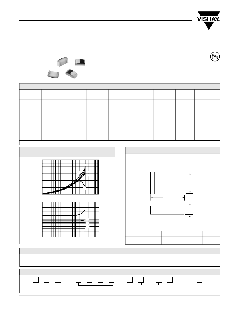

IFC-0603
Vishay Dale
High Q/SRF, Low Value Chip Inductors
High reliability
Surface mountable
High self-resonant frequency
2 % tolerance available
Temperature range: - 40 °C to + 125 °C (no load)
- 40 °C to + 85 °C (full rated
current)
Lead (Pb)-free terminations and RoHS compliant
RoHS
COMPLIANT
Q
100 MHz
100 MHz
MODEL
(nH)
TOL.
(Typ.)
IFC-0603
0.3 nH
1.8
0.3 nH
2.2
0.3 nH
2.7
0.3 nH
3.3
5 %, 10 %
3.9
5 %, 10 %
4.7
5 %, 10 %
5.6
5 %, 10 %
6.8
5 %, 10 %
8.2
5 %, 10 %
5 %, 10 %
5 %, 10 %
5 %, 10 %
5 %, 10 %
L, Q, SRF measured on HP-4291A and HP-8753D
Q
800 MHz
(Typ.)
38
35
38
41
36
38
38
38
38
34
36
32
Q
1700 MHz
(Typ.)
42
47
51
53
51
55
48
47
58
45
24
23
SRF
MHz
(Typ.)
> 15 000
> 15 000
14 000
13 000
10 000
8000
7000
5100
4900
3700
3600
3200
2600
2500
DCR
Ohms
(Max.)
0.06
0.06
0.08
0.12
0.15
0.20
0.21
0.29
0.32
0.35
0.42
0.50
0.60
0.75
RATED
DC CURRENT
(mA)
1000
1000
1000
1000
1000
PERFORMANCE GRAPHS:
INDUCTANCE AND Q VS FREQUENCY
90
INDUCTANCE (nH)
DIMENSIONS
in inches [millimeters]
3.9
3.3
6.8
8.2
Q
1000
FREQUENCY (MHz)
10 000
8.2
6.8
3.9
3.3
MODEL
1000
FREQUENCY (MHz)
10 000
0.020 ± 0.004
[0.50 ± 0.1]
0.015 Max.
[0.38 Max.]
IFC-0603
0.063 ± 0.004 0.031 ± 0.004
[1.60 ± 0.1]
[0.80 ± 0.1]
DESCRIPTION
IFC-0603
MODEL
10 nH
INDUCTANCE
VALUE
±5 %
INDUCTANCE
TOLERANCE
ER
PACKAGE
CODE
e3
JEDEC LEAD (Pb)-FREE
STANDARD
GLOBAL PART NUMBER
SIZE
N
TOL.
PRODUCT FAMILY
PACKAGE
CODE
INDUCTANCE
VALUE
www.vishay.com
86
For technical questions, contact: magnetics@vishay.com
Document Number: 34012
Revision: 10-Aug-06
