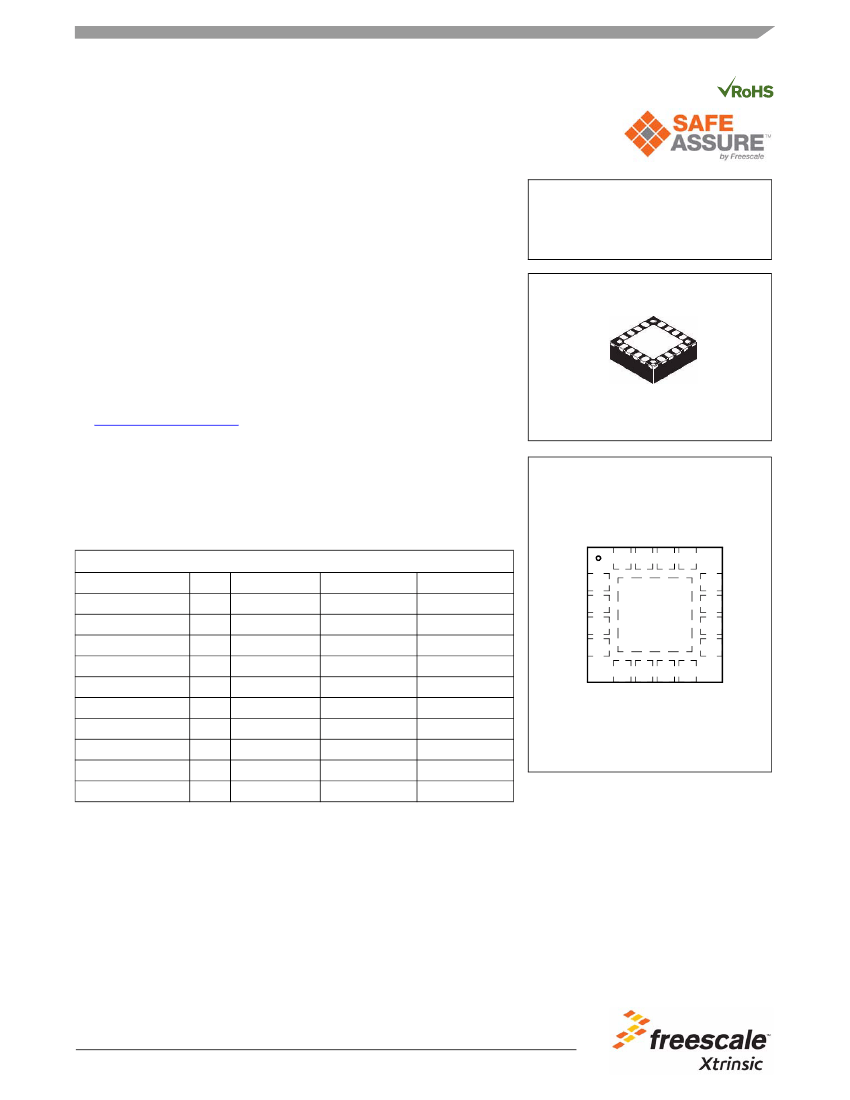

Xtrinsic MMA16xxNKW
DSI Inertial Sensor
The MMA16xxNKW family, a SafeAssure solution, includes the DSI2.5
compatible overdamped Z-axis satellite accelerometers.
±50g to ±312.5g Nominal Full-Scale Range
Selectable 180 Hz, 2-pole, 400 Hz, 4-pole, or 800 Hz, 4-pole LPF
DSI2.5 Compatible with full support of Mandatory Commands
μs
internal sample rate, with interpolation to 1 ms
-40°C to 125°C Operating Temperature Range
Pb-Free 16-Pin QFN, 6 by 6 Package
Qualified AECQ100, Revision G, Grade 1 (-40°C to +125°C)
(http://www.aecouncil.com/)
MMA16xxNKW
Bottom View
16-PIN QFN
CASE 2086-01
Typical Applications
• Airbag Front and Side Crash Detection
Top View
TEST7
TEST6
TEST5
12 V
SSA
11 C
REGA
10 TEST4
9 C
REG
PCM
BUSOUT
BUSIN
HCAP
ORDERING INFORMATION

16 15 14 13
TEST2 1
TEST3 2
TEST1 3
BUSRTN 4
17
PIN CONNECTIONS
For user register array programming, please consult your Freescale representative.
