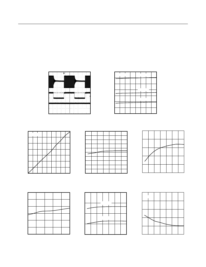

The MAX16814 consists of four identical linear current
source channels to drive four strings of HB LEDs. The
channel current is adjustable from 20mA to 150mA with
an accuracy of ±3% using an external resistor. The
external resistor sets all 4-channel currents to the same
value. The device allows connecting multiple channels
in parallel to achieve higher current per LED string. The
MAX16814 also features pulsed dimming control on all
four channels through a logic input (DIM). In addition,
the MAX16814A_ _ and MAX16814U_ _ include a unique
feature that allows a very short minimum pulse width as
low as 1µs.
