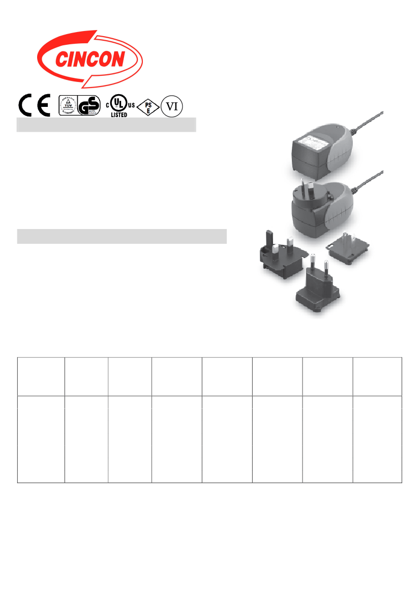

V19
* Universal Input Range 90~264VAC
* Two Color Case
* Meets EN55022 Class “B”
* Continuous Short Circuit Protection
* Interchangeable AC Plugs
* Over Voltage Protection
* Meet CoC V5 Tier 2 & DoE Level VI
(Output Cable Length
1800mm)
TR15RA SERIES
15W SWITCHING
ADAPTER

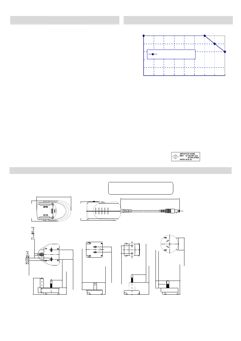

01: 720mm
02: 1220mm
03: 1800mm
11: 720mm with Ferrite Core
12: 1220mm with Ferrite Core
13: 1800mm with Ferrite Core
* 18AWG / UL1185
BE: Blue
GY: Gray
RD: Red
PE: Purple
OE: Orange
