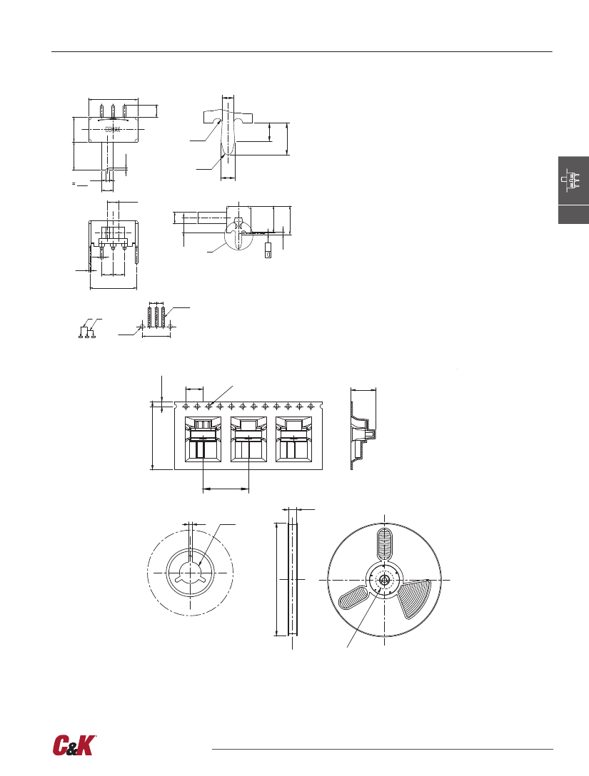

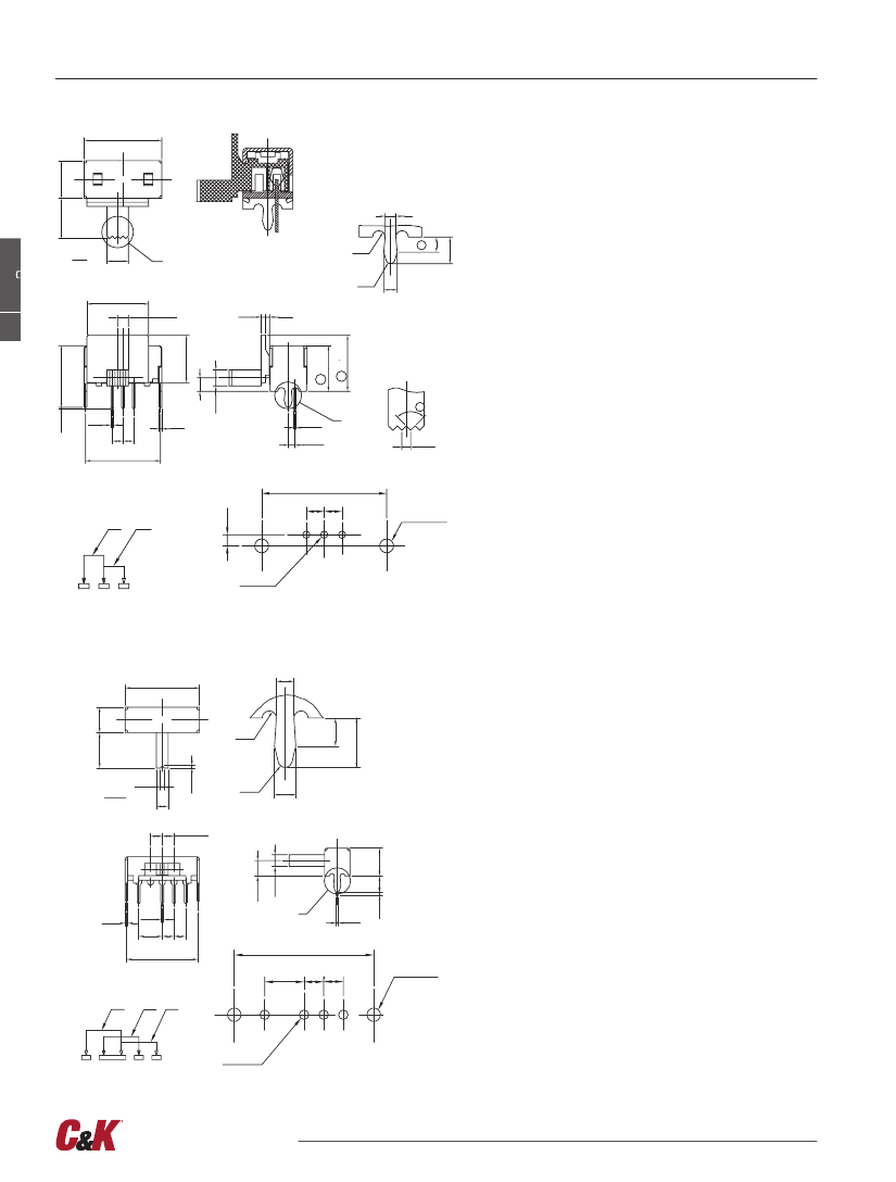

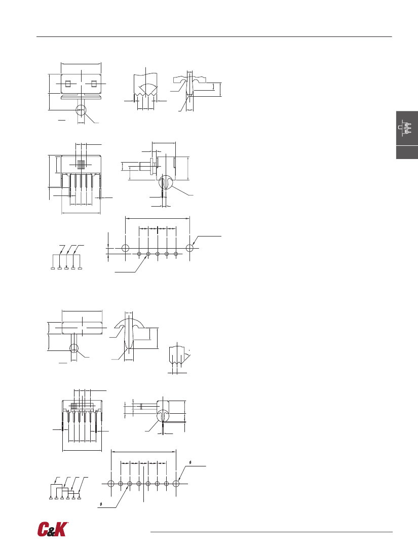

SK Series
Miniature Slide Switches - Side Knob
Features/Benefits
Broad range of products
Different travel - 2mm, 3mm & 4mm
Various circuit design - 1P2T/3T/4T &
2P2T/3T/4T
Various knob length & style
Shorting or non-shorting
Custom design available
RoHS compliant
Typical Applications
Consumer electronics
Computer peripherals
Telecommunication
Audio & visual equipment
Industrial
2MM TRAVEL
SK-12D04-G 3 NS
1P2T NON-SHORTING 3MM KNOB
SK-12D04-VG 3 NS
1P2T NON-SHORTING 3MM KNOB (VG)
8.6
Slide
Specifications
CONTACT RATING: 0.3A @ 30 VDC
INITIAL CONTACT RESISTANCE: 30 m ohms max.
INSULATION RESISTANCE: 100 M ohms min.
DIELECTRIC STRENGTH: 500 V AC (50-60 Hz) between open
terminals and between the frame and terminal.
OPERATING LIFE: 10,000 cycles with load
OPERATING FORCE: 250 ± 100 gf (2.45 ± 0.98N)
TRAVEL: 2 ± 0.3 mm
OPERATING TEMPERATURE: -20˚C to 70˚C
VG
FREE
4.3
0.6
VG
0.4
TRAVEL
Materials
KNOB: POM
FRAME: SPCC
CONTACT: Silver clad
0.4
2.6
4.7
TERMINAL: Silver plated
0.4
1P - 2T
2 2
3-ø0.8
SCHEMATIC
PIERCING PLAN
G knob style
90°
0.6
P DETAIL 2 : 1
3.3
22 feb 18
Dimensions are shown: mm
Specifications and dimensions subject to change
I–69
www.ckswitches.com
