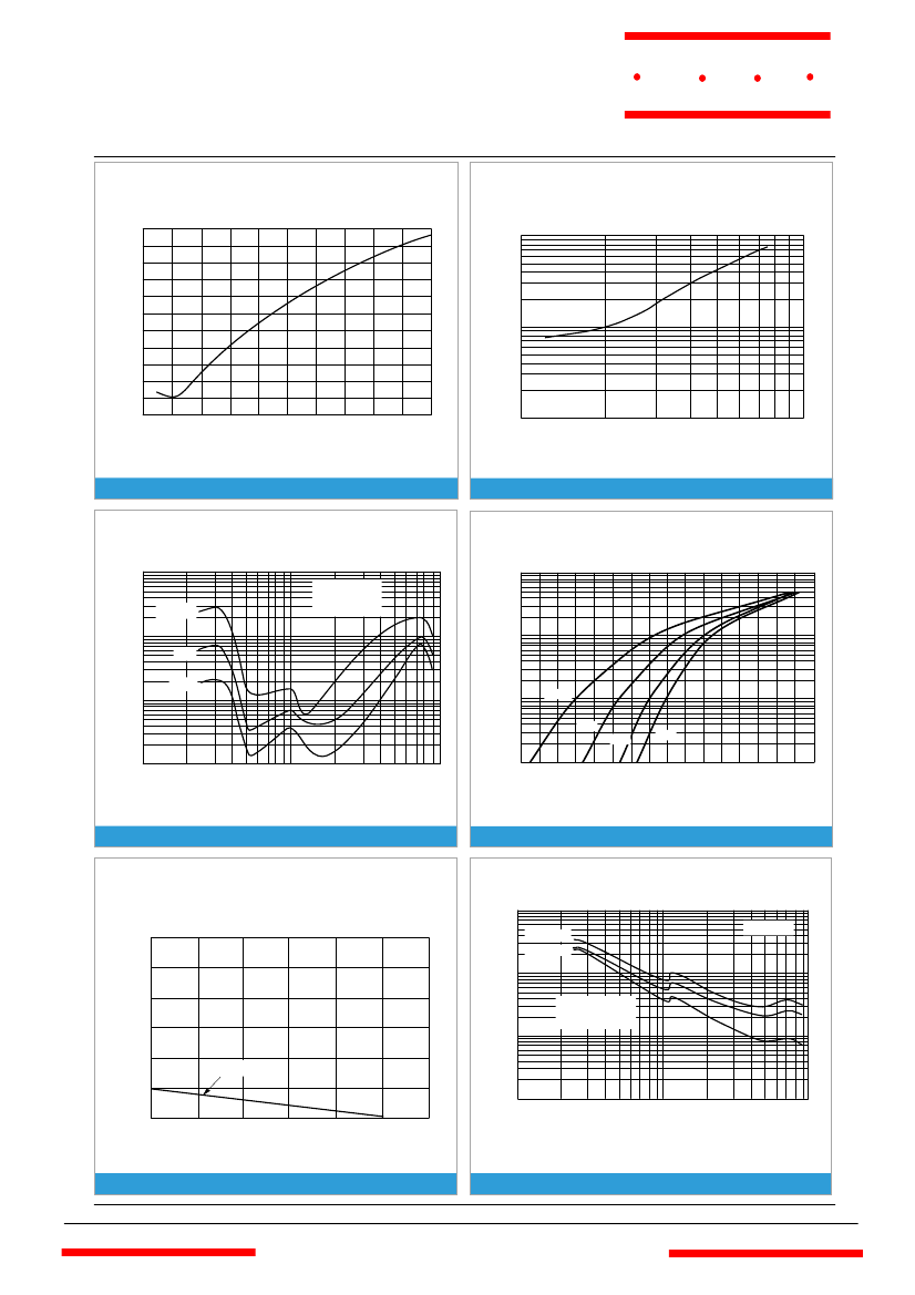

MMXZ5221B
THRU
MMXZ5259B
200 mW
Zener Diodes
2.4 to 39 Volts
Lead Free Finish/RoHS Compliant ("P" Suffix
designates RoHS Compliant. See ordering information)
Planar Die construction
Zener Voltages from 2.4V - 39V
and 200mW Power Dissipation
Ideally Suited for Automated Assembly Processes
Mechanical Data
Epoxy meets UL 94 V-0 flammability rating
Moisture Sensitivity Level 1
Approx. Weight: 0.008 gram
Mounting Position: Any
Storage & Operating Junction Temperature: -55 C to +150 C
o
o
SOD-323
Maximum Ratings @ 25
o
C Unless Otherwise Specified
Forward Current
Maximum Forward
1.2
Voltage
Power Dissipation
(AV)
mWatt
(No te s A)
Peak Forward S urge
FSM
2.0
Amps
Current (Not e s B)
NOTES:
A. Mounted on 5.0mm2(.013mm thick) land areas.
B. Measured on 8.3ms, single half sine-wave or equivalent
square wave, duty cycle = 4 pulses per minute maximum
DIM
DIMENSIONS
INCHES
MM
MIN
MAX
MIN
MAX
.090
.107
2.30
2.70
.063
.071
1.60
1.80
.045
.053
1.15
1.35
.031
.045
0.80
1.15
.010
.016
0.25
0.40
.004
.018
0.10
0.45
.004
.010
0.10
0.25
.006
0.15
SUGGESTED SOLDER
PAD LAYOUT
0.074"
NOTE
0.027”
0.022”
Revision:
www.mccsemi.com
1 of 5
2011/01/01
