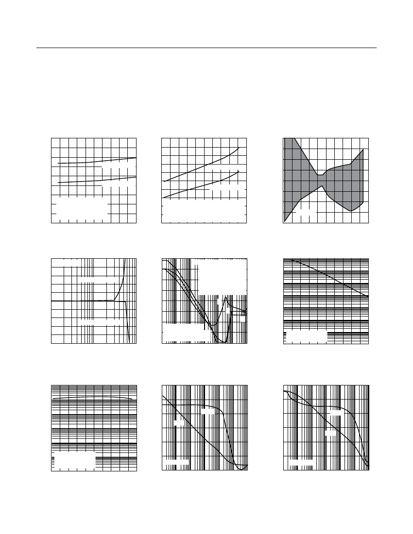

MAX951–MAX954
Ultra-Low-Power, Single-Supply
Op Amp + Comparator + Reference
General Description
The MAX951–MAX954 feature combinations of a micro-
power operational amplifier, comparator, and reference
in an 8-pin package. In the MAX951 and MAX952, the
comparator’s inverting input is connected to an internal
1.2V ±2% bandgap reference. The MAX953 and MAX954
are offered without an internal reference. The MAX951/
MAX952 operate from a single 2.7V to 7V supply with a
typical supply current of 7μA, while the MAX953/MAX954
operate from 2.4V to 7V with a 5μA typical supply current.
Both the op amp and comparator feature a common-
mode input voltage range that extends from the negative
supply rail to within 1.6V of the positive rail, as well as
output stages that swing Rail-to-Rail
The op amps in the MAX951/MAX953 are internally com-
pensated to be unity-gain stable, while the op amps in the
MAX952/MAX954 feature 125kHz typical bandwidth, 66V/
ms slew rate, and stability for gains of 10V/V or greater.
These op amps have a unique output stage that enables
them to operate with an ultra-low supply current while
maintaining linearity under loaded conditions. In addition,
they have been designed to exhibit good DC character-
istics over their entire operating temperature range, mini-
mizing input-referred errors.
The comparator output stage of these devices continu-
ously sources as much as 40mA. The comparators elimi-
nate power-supply glitches that commonly occur when
changing logic states, minimizing parasitic feedback and
making the devices easier to use. In addition, they contain
±3mV internal hysteresis to ensure clean output switch-
ing, even with slow-moving input signals.
Op Amp + Comparator + Reference in an 8-Pin
μMAX Package (MAX951/MAX952)
● 7μA Typical Supply Current (Op Amp + Comparator +
Reference)
Comparator and Op Amp Input Range Includes
Ground
Outputs Swing Rail to Rail
2.4V to 7V Supply Voltage Range
Unity-Gain Stable and 125kHz Decompensated
≥ 10V/V Op Amp Options
Internal 1.2V ±2% Bandgap Reference
Internal Comparator Hysteresis
Op Amp Capable of Driving up to 1000pF Load
