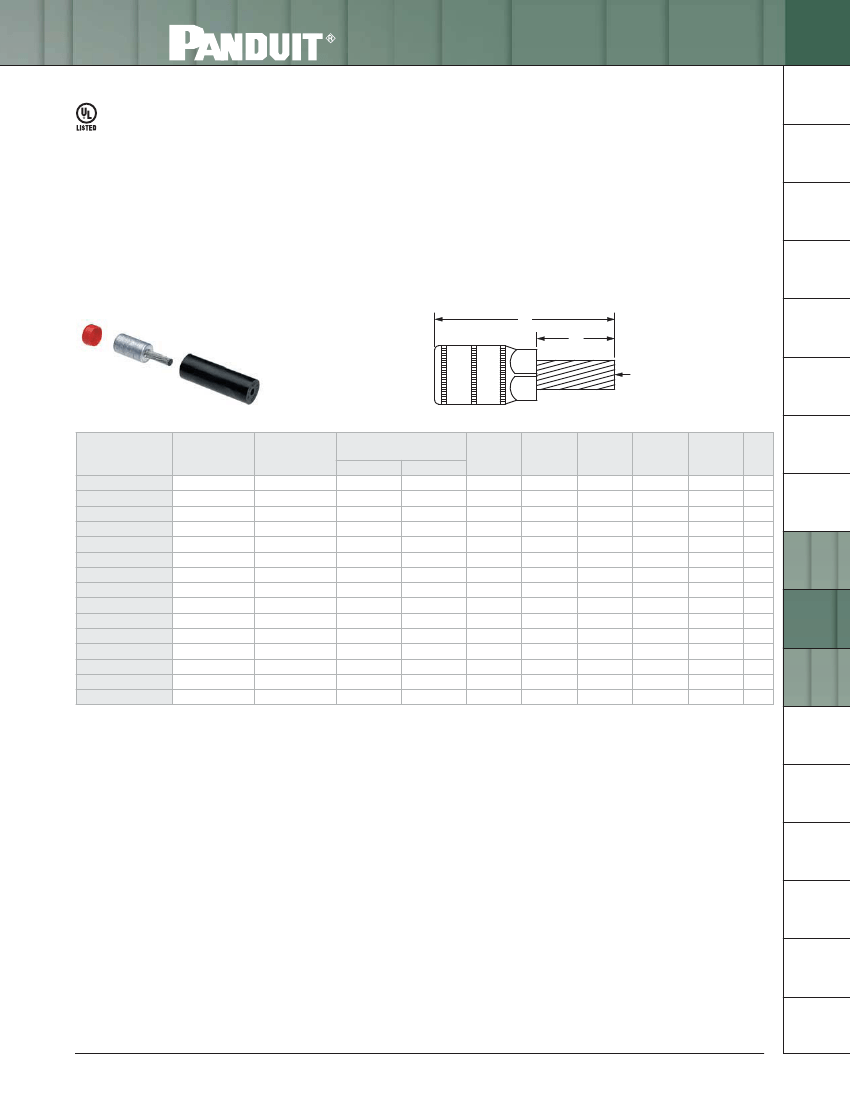

ELECTRICAL SOLUTIONS
Code Conductor, Aluminum, Bi-Metallic Pin Connector
Provides Copper Pigtail for Connecting Aluminum Conductors
to a Copper or Aluminum/Copper Rated Mechanical Lug
Type BPC
• Factory pre-filled with joint compound and sealed with easy
pull-out end plug to inhibit corrosion
• Color-coded end plug and Panduit die index number marked
on barrel for proper crimp die selection
• Insulating rubber sleeve included to insulate aluminum barrel
from contact with copper connector when attached to pin
• Tin-plated to inhibit corrosion
• UL Listed per UL 486B; temperature rated 90°C and for use up
to 600 V when crimped with Panduit and specified competitor
crimping tools and dies
B2.
Cable
Accessories
A.
System
B1.
Cable Ties
B3.
Stainless
Steel Ties
COPPER
PIGTAIL
CONDUCTOR
C1.
Wiring
Duct
C2.
Surface
Raceway
BPC6-L
BPC4-L
BPC2-L
BPC1-X
BPC1/0-X
BPC2/0-X
BPC3/0-X
BPC4/0-X
BPC250-X
BPC300-X
BPC350-X
BPC400-X
BPC500-X
BPC600-6
BPC750-6
Aluminum
Conductor
Size
#6 AWG
#4 AWG
#2 AWG
#1 AWG
1/0 AWG
2/0 AWG
3/0 AWG
4/0 AWG
250 kcmil
300 kcmil
350 kcmil
400 kcmil
500 kcmil
600 kcmil
750 kcmil
Copper Pigtail
Size
#8 AWG
#6 AWG
#4 AWG
#3 AWG
#2 AWG
#1 AWG
1/0 AWG
2/0 AWG
3/0 AWG
4/0 AWG
4/0 AWG
250 kcmil
350 kcmil
350 kcmil
500 kcmil
Figure Dimensions
(In.)
2.45
2.45
2.45
2.58
3.33
3.33
3.46
3.46
3.71
4.10
4.10
4.35
4.35
4.77
4.90
0.88
0.88
0.88
1.00
1.25
1.25
1.38
1.38
1.50
1.63
1.63
1.88
1.88
1.88
2.00
Panduit
Color
Code
Tan
Tan
Tan
Tan
Red
Red
Red
Red
Green
Green
Green
Black
Black
Red
Red
Panduit
Die Index
No.‡
P50
P50
P50
P50
P71
P71
P71
P71
P94
P94
P94
P106
P106
P125
P125
Burndy
Die Index
No.‡
296
296
296
296
298
298
298
298
299
299
299
936
936
T&B
Die Index
No.‡
76
76
76
76
99, 87
99, 87
99, 87
106
106
115
115
Wire Strip Std.
Length
Pkg.
(In.)
Qty.
1 1/16
1 1/16
1 1/16
1 1/16
1 5/16
1 5/16
1 5/16
1 5/16
1 7/16
1 7/16
1 7/16
1 7/16
1 7/16
1 15/16
1 15/16
C3.
Abrasion
Protection
C4.
Cable
Management
D1.
Terminals
D2.
Power
Connectors
D3.
Grounding
Connectors
‡See pages D3.88 – D3.89 for tool and die information.
See pages D2.118 for Panduit joint compounds recommended for pad to pad and conductor connections.
E1.
Labeling
Systems
E2.
Labels
E3.
Pre-Printed
& Write-On
Markers
E4.
Permanent
Identification
E5.
Lockout/
Tagout
& Safety
Solutions
F.
Index
For technical assistance in the U.S., call 866-405-6654 (outside the U.S., see inside back cover for directory)
