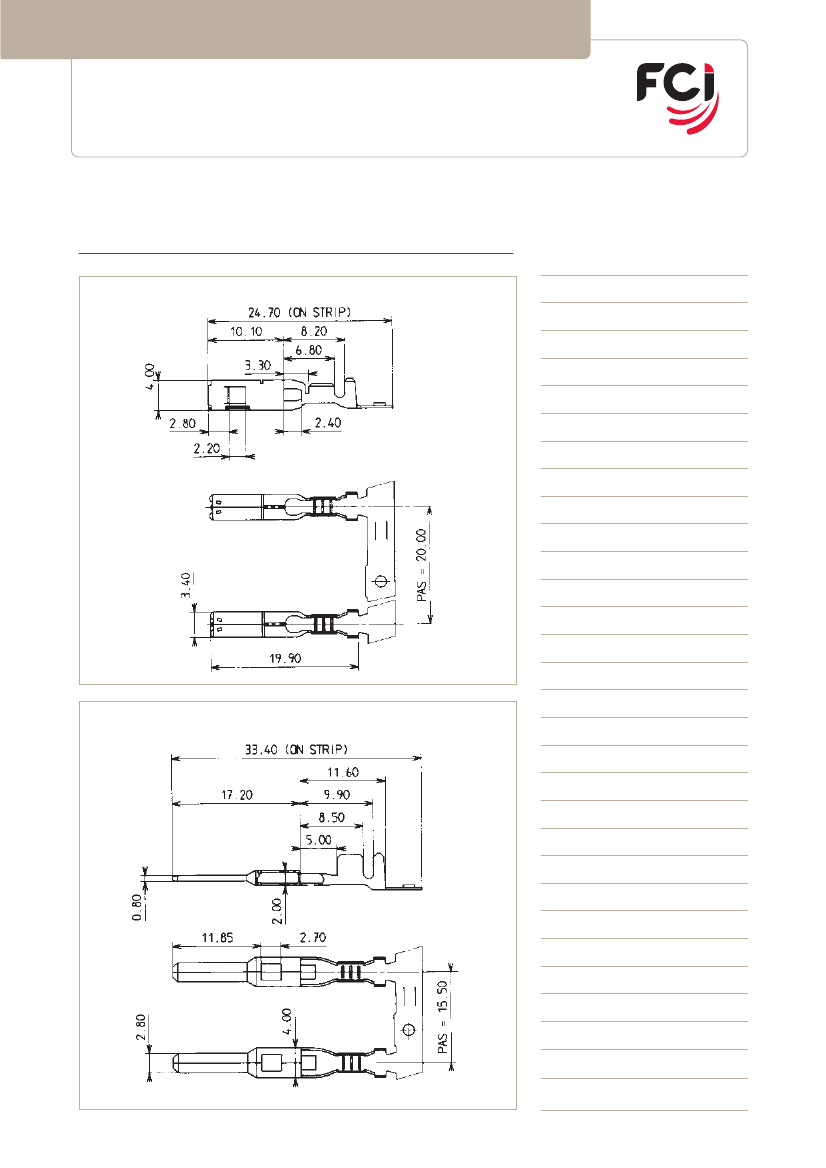

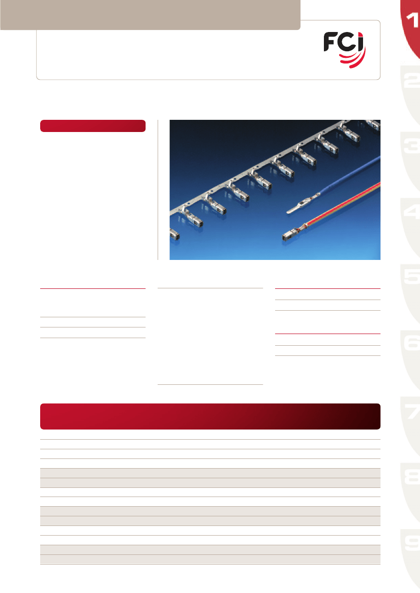

Terminal Systems
Sicma-3
2.8 mm female and male terminals
Sicma-3 technology
One-piece construction
5 mm pitch
High current carrying capacity
Low contact mating force
Compatible with a large range of
connector sealing technologies
(single wire sealing, mat-seal)
Available in brass and copper iron
Suitable for secondary lock
Selective gold-plated versions
available
Performance characteristics
Contact resistance:
< 1.5 mΩ for CuFe terminals
< 2 mΩ for CuZn terminals
Contact mating force:
Contact unmating force:
<6N
< 1.5 N
Packing
Current carrying capacity
at 23°C up to approx.:
- 25 A for CuFe/CuSn terminals
- 18 A for CuZn/CuSn terminals
at 85°C up to approx.:
- 16 A for CuFe/CuSn terminals
- 5 A for CuZn/CuSn terminals
at 100°C up to approx.:
- 13 A for CuFe/CuSn terminals
at 125°C up to approx.:
- 6 A for CuFe/CuSn terminals
No. of terminals per reel:Consult us
No. of reels per packing:Consult us
Tooling
Manual crimping tool:
Mini applicator:
Consult us
Consult us
Part Numbers
Wire size range
(in mm2)
Min.
Max.
Insulation Ø
(in mm)
Max.
Material
Plating
211 CC3S1150
211 CC3S2150
211 CC3S1160
211 CC3S2160
211 CC3S1161 (SWS)
211 CC3S2161 (SWS)
211 CC3S1460
211 CC3S2460
211 CL3S1160
211 CL3S2160
211 CL3S1161 (SWS)
211 CL3S2161 (SWS)
211 CL3S1460
211 CL3S2460
Female
Female
Female
Female
Female
Female
Female
Female
Male
Male
Male
Male
Male
Male
0.35
1.00
0.35
1.00
0.35
1.00
0.35
1.00
0.35
1.00
0.35
1.00
0.35
1.00
0.75
2.50
0.75
2.50
0.75
2.50
0.75
2.50
0.75
2.50
0.75
2.50
0.75
2.50
1.80
2.80
1.80
2.80
1.80
2.80
1.80
2.80
1.80
2.80
1.80
2.80
1.80
2.80
CuZn
CuZn
CuFe
CuFe
CuFe
CuFe
CuFe
CuFe
CuSn
CuSn
CuSn
CuSn
CuFe
CuFe
Sn
Sn
Sn
Sn
Sn
Sn
Au 1.27 µm
Au 1.27 µm
Sn
Sn
Sn
Sn
Au 1.27 µm
Au 1.27 µm
SWS: Single Wire Seal
Rev 06/04
