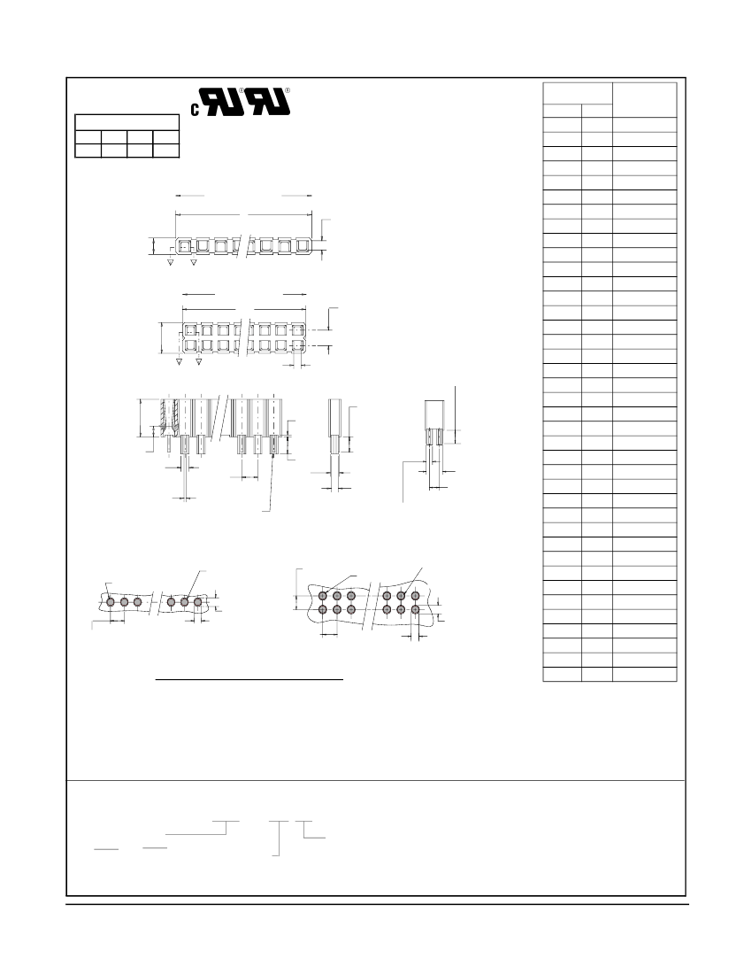

1. It is recommended that the plated thru-hole on the ends be .062″ [1.57] to .063″ [1.60]. This will prevent the connector from floating during the wave soldering
process.
2. Integral solder mask plugs are removed after soldering by using the 3M™ Hand Tool 929013 with the 3M™ Molded Head 929025-0X-XX or 3M™ Hand Tool
929012 with the 3M™ Press 929050.
3. Do not hand solder this connector because the solder heat and volume of solder cannot be adequately controlled. This wouldmake the integral plugs difficult
or impossible to remove.
4. The connector should be flow soldered such that it enters the solder wave, end first (width).
Ordering Information
929XXX-01-XX-XX
Plating Options:
2 Row
1 Row
841 = Gold 842 = Gold
Contact Quantity:
(per row) see table
Gold Plating Thickness:
10 = Wiping Area 10 µ" [0.25 µm] gold with tin-lead tails (RIA E3 & C2 apply)
30 = Wiping Area 30 µ" [0.76 µm] gold with tin-lead tails (RIA E3 & C2 apply)
RA = 10 µ" [0.25 µm] gold wiping area with matte tin tails (RIA E1 & C1 apply)
RB = 30 µ" [0.76 µm] gold wiping area with matte tin tails (RIA E1 & C1 apply)
IS
Recommended Mounting Hole Pattern
.160
[ 4.06 ]
.100 Ref
[ 2.54 ]
.005 Typ
.002
.085 Typ
[ 2.16 ]
Pad Size
.125
[ 3.18 ]
1/
+.010
-.005
Recommended Solder
Flow Direction

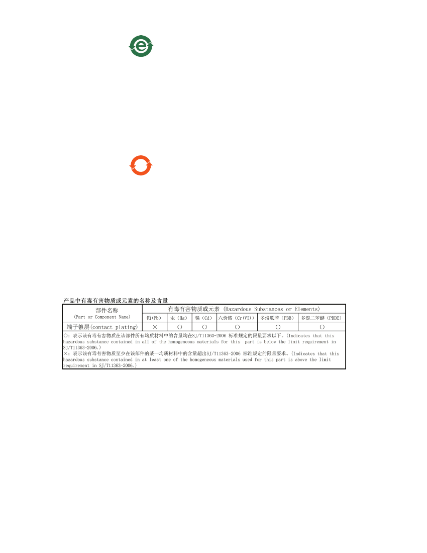

CHINA
Appendix C1: China RoHS
Electronic Industry Standard of the People’s Republic of China, SJ/T11363-2006, Requirements for Concentration Limits
for Certain Hazardous Substances in Electronic Information Products.
This symbol, per Marking for the Control of Pollution Caused by Electronic Information Products, SJ/T11364-2006,
means that the product or part
does not
contain any of the following substances in excess of the following maximum
concentration values in any homogeneous material: (a) 0.1% (by weight) for lead, mercury, hexavalent chromium,
polybrominated biphenyls or polybrominated diphenyl ethers; or (b) 0.01% (by weight) for cadmium. Unless otherwise
stated by 3M in writing, this information represents 3M’s best knowledge and belief based upon information provided by
third party suppliers to 3M.
In the event any product is proven not to conform with 3M’s Regulatory Information Appendix, then 3M’s entire liability
and Buyer’s exclusive remedy will be in accordance with the Warranty stated below.
