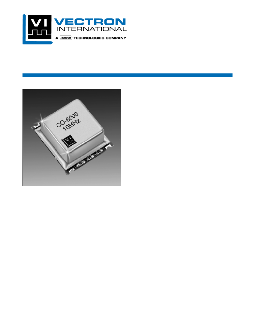

Product Data Sheet
CO-6000 Series
Surface Mount Oven Controlled Crystal Oscillators
• 5 MHz, 10MHz, 13MHz Standard, Other
Frequencies Available from 4.8 MHz to 40 MHz.
• Stability as high as ± 5 x 10
-9
over 0°C to +50°C
• Aging: 5 x 10
-9
/ day to 5 x 10
-10
/day
• Package: 1.0” x 0.9” x 0.42” (25.4 x 22.0 x 10.3 mm)
• Low Profile, Surface Mount Design
• Supply voltage: +5 volts or +3.3 volts
• Telecommunication Systems
• Wireless Communication Equipment
• Data Communications
• Instrumentation
Vectron International has introduced a series of low
profile, surface mount, oven controlled crystal oscillators
(OCXOs) available in frequencies from 4.8 MHz to 40 MHz.
The model CO-6000 series provides exceptionally low
aging rates and high temperature stabilities and is pack-
aged as a surface mount device (SMD), measuring 1.0”
x 0.9” x 0.42” (25.4 mm x 22.0 mm x 10.3 mm).
The oscillators provide an aging rate of 1 x 10
-9
/day with
temperature stabilities as high as ±5 x 10
-9
over 0°C to
50°C. They operate from a supply voltage of +5Vdc or +3.3
Vdc at a stabilized power of 1.0 watts.
The product finds application in telecommunications,
data communications, frequency synthesizers, timing,
navigation, telemetry and instrumentation systems.
