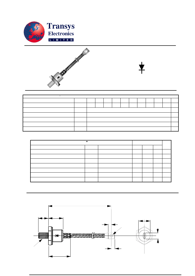

1N3288(R)-1N3297(R)
High Current Rectifier
RRM
= 50-1400V, I
F(AV)
= 100 A ,VF = 1.2V
K
Cathode to Stud Shown
(Anode to Stud add Suffix R)
Cathode to Stud Symbol
MAXIMUM RATINGS
(Tj = 25 C unless stated otherwise)
Repetitive Peak Reverse Voltage
Maximum Average On-State Current
Peak Forward Surge Current
Maximum I
T for Fusing
Maximum Storage Temperature Range
Maximum Junction Temperature Range
1N3288 1N3289 1N3290 1N3291 1N3292 1N3293 1N3294 1N3295 1N3296 1N3297 Unit
1600
10700
-65 to +200
-65 to +200
600
800
1000
1200
1400
Volt
Amp
Amp
RRM
(AV)
FSM
(STG)
Tj
/S
O
O
ELECTRICAL CHARACTERISICS at
Maximum Forward Voltage
Repetitive Peak Off- State Current (1)
Repetitive Peak Off- State Current (2)
Operating Frequency
Thermal Resistance (Junction to Case)
Mounting Torque
Weight
Tj = 25 C Maximum. Unless stated Otherwise
FM
DRM(1)
DRM(2)
f
(MAX)
TH (J-c)
M
Wt
Condition
FM
= 200 Amps
= V
RRM
= V
RRM
,Tj = 150
O
Min
Value
Typ
1.2
20.0
7.5
0.40
11.3
78
Max
Volt
µA
KHz
O
C/W
NM
grms
117.47(4.625)
111.13(4.375)
16.25(0.640)
15.50(0.610)
18.80 (0.740)
16.76 (0.660)
10.41(0.410)
8.90(0.350)
7.39(0.291)
6.89(0.271)
21.47(0.843)
21.20(0.835)
15.24(0.60)
12.70(0.50)
3/8"-24UNF-2A
39.37 (1.550)
Max
8.30(0.327)
7.55(0.297)
D0-8
