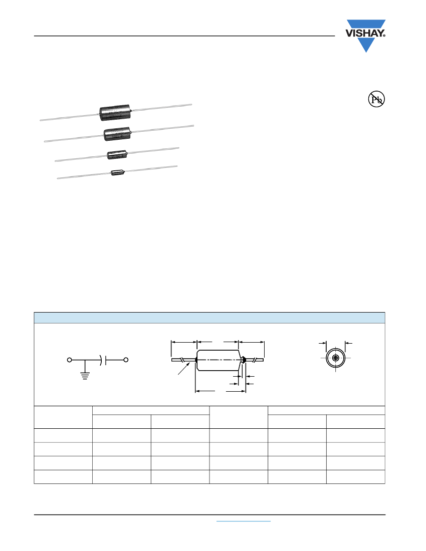

DIMENSIONS
in inches [millimeters]
1.500 ± 0.250
[38.10 ± 6.35]
1.500 ± 0.250
[38.10 ± 6.35]
DIA.
SOLID TINNED
NICKEL LEADS
MAX
0.047 [1.19] MAX.
0.125 [3.18] MAX.
WITH INSULATING SLEEVE
(1)
CASE CODE
0.135 ± 0.016
[3.43 ± 0.41]
0.185 ± 0.016
[4.70 ± 0.41]
0.289 ± 0.016
[7.34 ± 0.41]
0.351 ± 0.016
[8.92 ± 0.41]
0.286 ± 0.031
[7.26 ± 0.79]
0.474 ± 0.031
[12.04 ± 0.79]
0.686 ± 0.031
[17.42 ± 0.79]
0.786 ± 0.031
[19.96 ± 0.79]
J (MAXIMUM)
0.422
[10.720]
0.610
[15.490]
0.822
[20.880]
0.922
[23.420]
AWG
NO.
24
24
22
22
LEAD SIZE
NOMINAL
DIAMETER
0.020
[0.51]
0.020
[0.51]
0.025
[0.64]
0.025
[0.64]
Note
(1)
When a shrink-fitted insulation is used, it shall lap over the ends of the capacitor body
* Pb containing terminations are not RoHs compliant, exemptions may apply
www.vishay.com
tantalum@vishay.com
Document Number: 40015
Revision: 25-Mar-09
