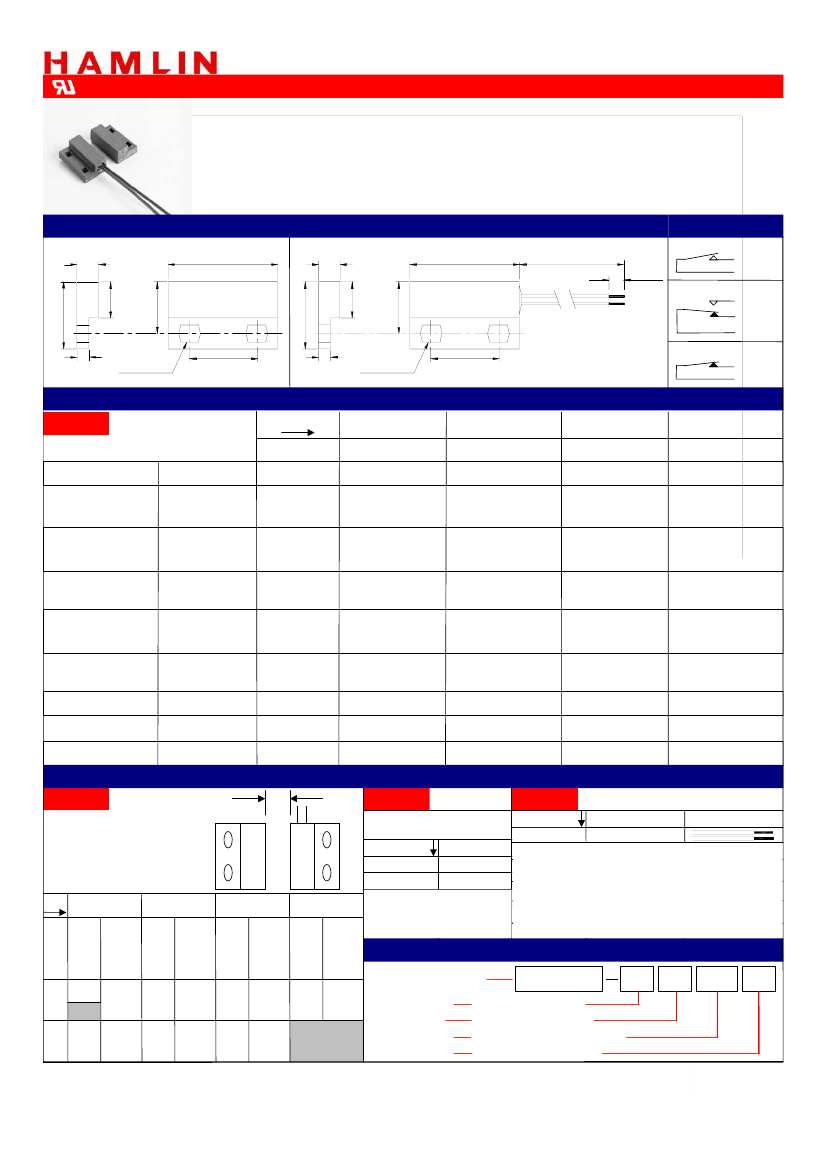

59140 and 59141 MINI FLANGE MOUNT SERIES
Benefits
Magnetically operated position sensor
No standby power requirement
Position and limit sensing
Matching actuator available
Operates through non-ferrous
Security system switch
materials such as wood, plastic
Compact size requires only 3.2cm²
Linear actuators
or aluminium
board space
Door switch
Hermetically sealed, magnetically
Screw down or adhesive mounting
operated contacts continue to
Customer defined sensitivity
operate long after optical and other
Choice of cable length and connector
technologies fail due to contamination
Leads can exit from LH or RH side
DIMENSIONS
(in) mm
Actuator
(.236)
6.00
(.906)
23.00
SCHEMATICS
Sensor (2 wire versions)
(.236)
6.00
(.906)
23.00
(Not including encapsulant)
Table3 ±(.393) 10.00
(.250)
6.35 Nom.
(.295)
(.295)
(.433)
(.433)
11.00
(.551)
(.551)
14.00
14.00
11.00
Switch Types 1 & 2
Black
Black
Switch Type 3
Black
Blue
White
7.50
7.50
(.118)
3.00
Slot (.126x.150)
3.20x3.81 Typ.
(.551)
14.00
(.118)
3.00
Slot (.126x.150)
3.20x3.81 Typ.
(.551)
14.00
Note: 59140 shown
59141 leads exit opposite side
Switch Type
Black
Black
CUSTOMER OPTIONS - Switching Specifications
TABLE 1
Switch Type
Select Option
Contact Type
Contact Rating
Voltage
Power
Switching
Breakdown
Current
Switching
Carry
Resistance
Contact, Initial
Insulation
Temperature
Operating
Storage
Time
Operate
Release
Capacitance
Shock
Vibration
Contact
11ms ½ sine
50-2000 Hz.
Watts - max
Vdc - max.
Vdc - min.
A - max.
A - max.
Ohms - max.
Ohms - min.
ms - max.
ms - max.
pF - typ.
G - max.
G - max.
Normally Open
250
1.2
0.2
-40 to +105
-65 to + 105
0.3
Normally Open High V.
450
0.2
-20 to +105
-65 to +105
0.2
Change Over
175
0.25
0.2
-40 to +105
-65 to +105
3.0
3.0
0.3
Normally Closed
175
0.25
0.2
-40 to +105
-65 to +105
3.0
3.0
0.3
CUSTOMER OPTIONS - Sensitivity, Cable Length and Termination Specifications
TABLE 2
Sensitivity
d
TABLE 3
Cable Length
TABLE 4
Select Option
Termination
(2 wire versions shown)
Diagram
Activate distances (d) are
approximate using Hamlin
57140-000 actuator as illustrated.
Switch AT before modification
Select
Option
(Cable 24AWG 7/32 PVC
105°C
UL1430 / ULl569)
Select Option
Length(in)mm
A or F
Tinned or untinned
02
05
U
(11,81)
(39,37)1,000
(19.69) 500
(29.53) 750
(39.37) 1,000
6.35mm fastons
AMP MTE 2.54mm
JST XHP 2.5mm
Pull-In Activate Pull-In Activate Pull-In Activate Pull-In Activate
AT Distance AT Distance AT Distance AT Distance
Range
(d)
Range
(d)
Range (d)
Range
(d)
(in)mm
(in)mm
(in)mm
(in)mm
12-18
(.453)
11.5
15-20
(.413)
10.5
17-23
(.374)
9.5
(.354)
9.0
22-28
(.315)
8.0
(.295)
7.5
27-33
(.295)
7.5
03
04
05
Hamlin USA
Hamlin UK
Hamlin Germany
Hamectrol France
Hamlin China
Switch Type
Untinned leads
ORDERING INFORMATION
Series 59140/59141
Switch Type
Sensitivity
Cable Length
Termination
59140/59141
X
X
XX
X
20-25
25-30
Table 1 (1, 2, 3 or 4)
Table 2 (S, T, U or V)
Table 3 (02 or 05)
Table 4 (A or F)
Tel: +1 920 648 3000 Fax: +1 920 648 3001 Email: sales.us@hamlin.com
DETAILS ON THIS DATA SHEET ARE PROVIDED FOR INFORMATION PURPOSES ONLY &
SHOULD NOT BE RELIED UPON AS BEING ACCURATE FOR ANY PARTICULAR PURPOSE
Tel: +44 (0) 1379 649700 Fax: +44 (0) 1379 649702 Email: sales.uk@hamlin.com
Product performance may be affected by the application that the part is used for.
Upon request Hamlin will assist purchasers by providing information specific to a particular application.
liability whatsoever for any purchaser’s reliance upon the information
Tel: +49 (0)
6142 923920
Fax: +49 (0) 6142
923921
Email: sales.de@hamlin.com
Hamlin disclaims allsheet without further consultation with Hamlin’s authorised representatives.
contained in this data
Tel: +33 (0) 1
6047 3000
Fax: +33 (0) 1
6015 9136
Email: sales.fr@hamlin.com
Issue:AC
13/08/09
DCR:B6359
Tel: +86 (0) 512 69365 800 Fax: +86 (0) 512 69365 811 Email:sales.cn@hamlin.com
