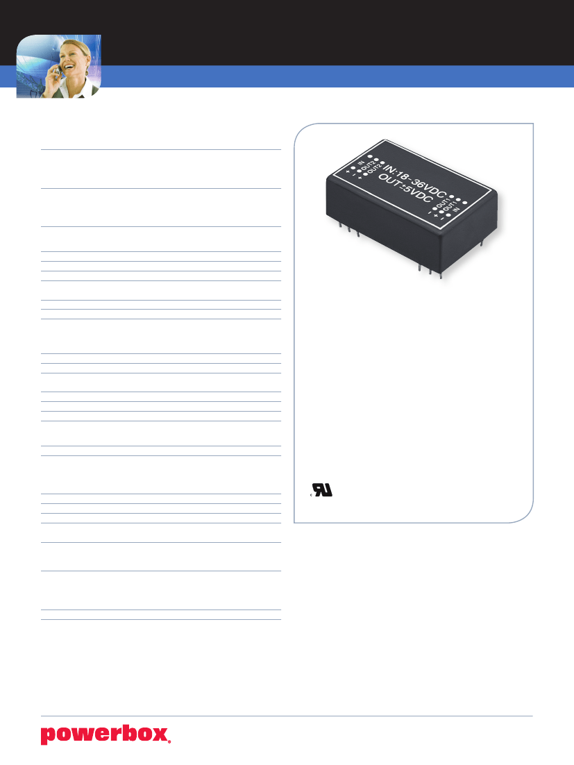

• 3W isolated output
• 24-pin DIP package
• Efficiency to 87%
• 2:1 input range
• Regulated outputs
• Pi input filter
• Continuous short circuit protection
• Meet EMI EN55022 class A (“-E” model)
• No tantalum capacitor inside (“-E” model)
• Wide operating temperature range (“-E” model)
• UL60950-1 approval for H/HM versions only
and “-E” model

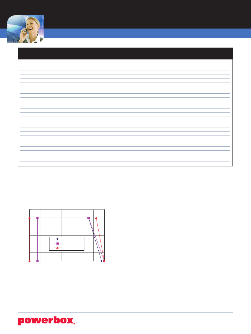

Operating ambient temp. –25 to +71°C. “-E” models –40 to +85°C.
Power derating curve
See figure 1.
Derating above 71°C
Linearly to zero power at 95°C (plastic case).
Linearly to zero power at 100°C (copper case).
