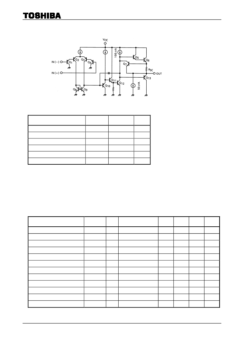

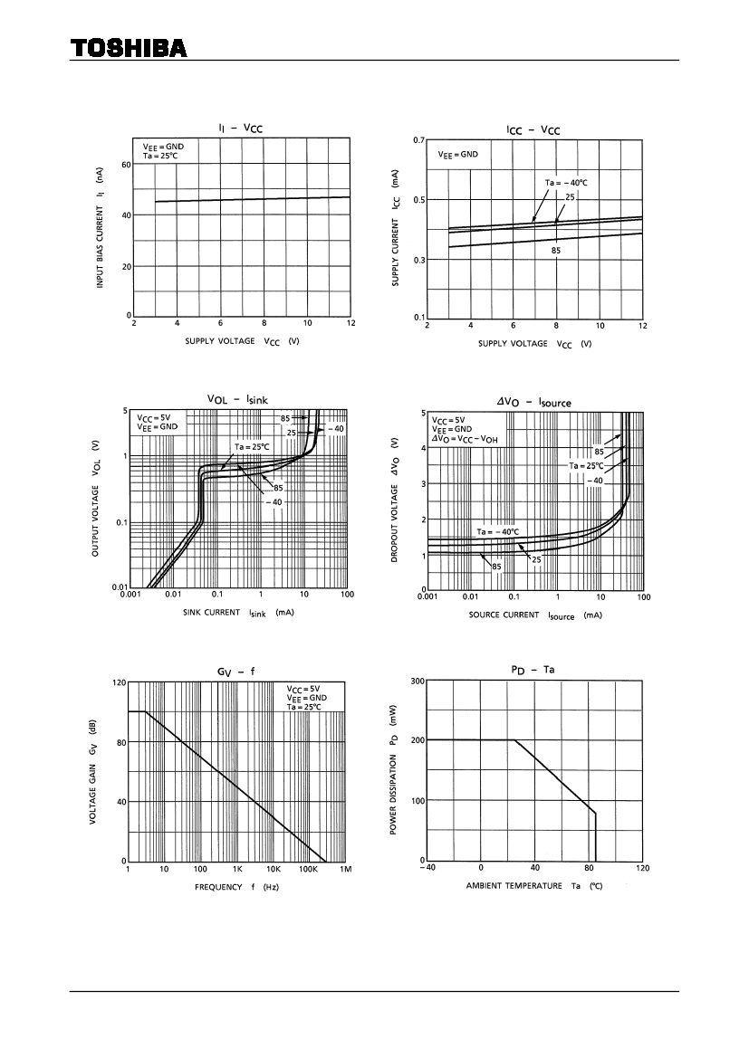

TA75S01F
TOSHIBA Bipolar Linear Integrated Circuit
Silicon Monolithic
TA75S01F
Single Operational Amplifier
In the linear mode the input common mode voltage range includes
ground.
The internally compensated Operational Amplifier is small package.
Low power dissipation and power drain suitable for battery operation.
Differential input voltage range equal to the power supply voltage.
Wide power supply voltage range and single power supply is possible.
Single supply 3V
DC
to 12V
DC
or dual supplies ±1.5V
DC
to ±6V
DC
Large output voltage swing: 0V
DC
to 3.4V
DC
(V
DC
= 5V)

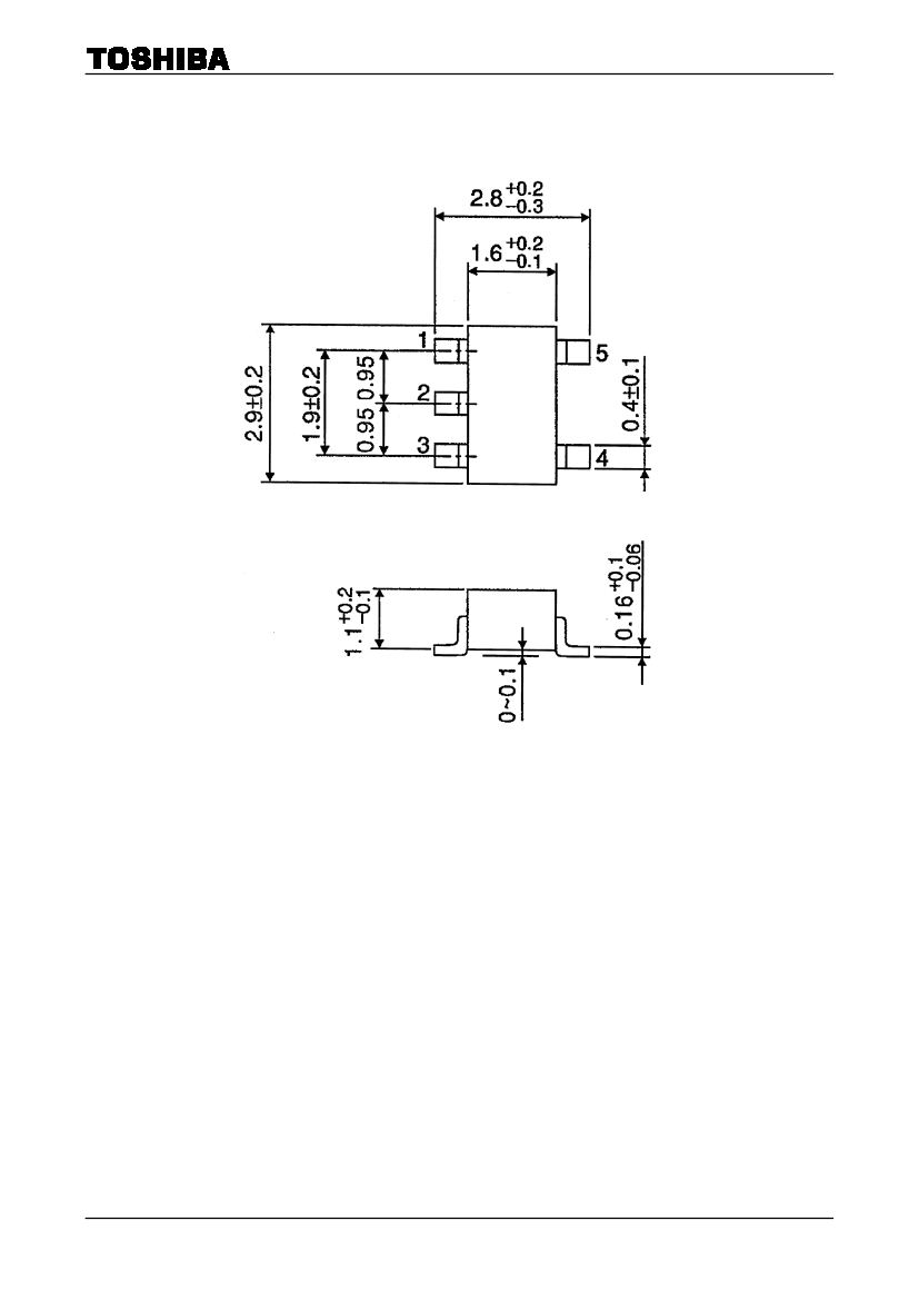

Unit: mm
Marking
(Top View)
Weight:0.014g (typ.)
