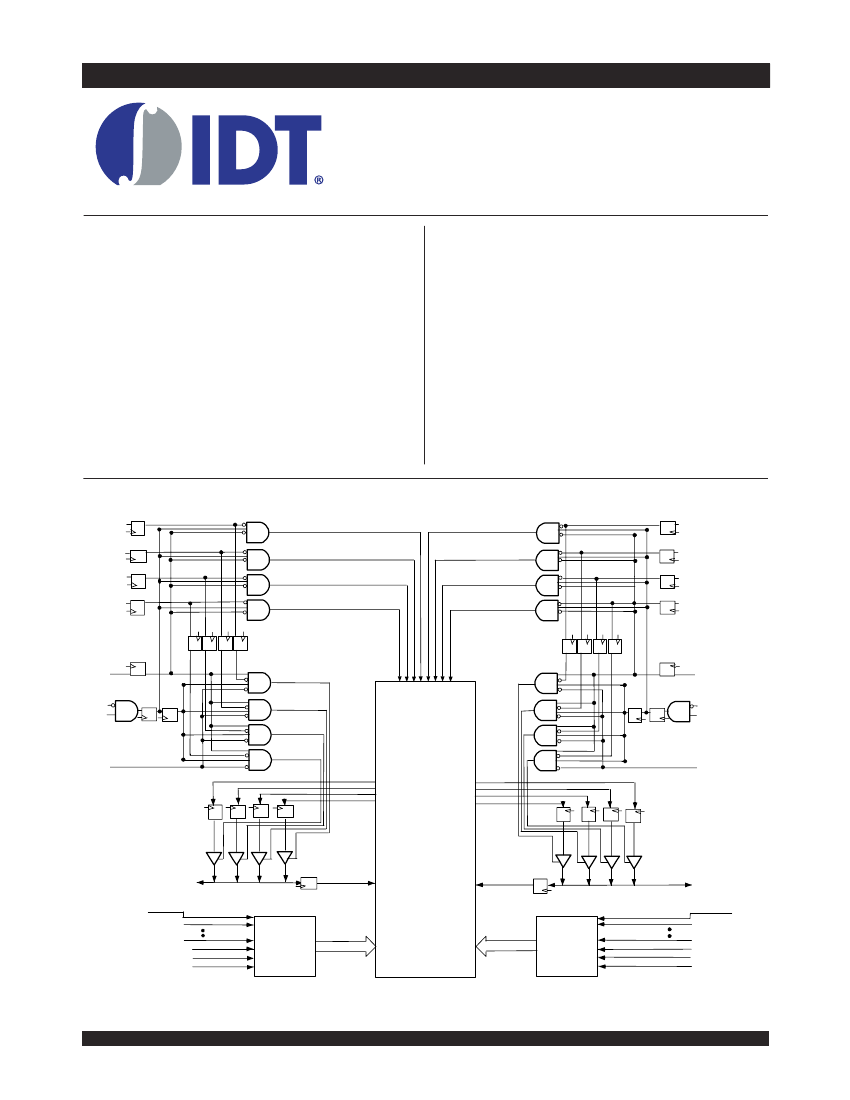

Functional Block Diagram
BE
3L
BE
3R
BE
2L
BE
1L
BE
0L
BE
2R
BE
1R
BE
0R
R/W
B B
WW
1 2
L L
B B BB B
W W WW W
3 3 2 1 0
L R RR R
R/W
CE
0L
CE
1L
CE
0R
CE
1R
OE
Dout0-8_L
Dout9-17_L
Dout18-26_L
Dout27-35_L
Dout0-8_R
Dout9-17_R
Dout18-26_R
Dout27-35_R
OE
32K x 36
MEMORY
ARRAY
I/O
0L
- I/O
35L
Din_L
Din_R
I/O
0R
- I/O
35R
CLK
14L
0L
CNTRST
ADS
CNTEN
CLK
Counter/
Address
Reg.
14R
ADDR_L
ADDR_R
Counter/
Address
Reg.
0R
CNTRST
ADS
CNTEN
4830 tbl 01
