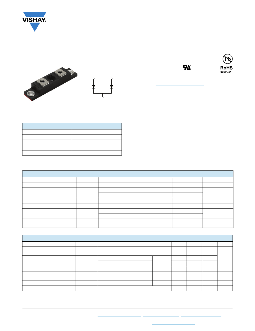

VS-HFA280NJ60CPbF
www.vishay.com
Vishay Semiconductors
HEXFRED
Ultrafast Soft Recovery Diode, 280 A
• Very low Q
rr
and t
rr
Lug
terminal
anode 1
Lug
terminal
anode 2
• UL approved file E222165
• Designed and qualified for industrial level
please see
www.vishay.com/doc?99912
BENEFITS
TO-244
Base common
cathode
• Reduced RFI and EMI
• Reduced snubbing
DESCRIPTION / APPLICATIONS
PRIMARY CHARACTERISTICS
F(AV)
F(DC)
at T
Package
Circuit configuration
280 A
600 V
149 A at 100 °C
TO-244
Two diodes common cathode
HEXFRED
diodes are optimized to reduce losses and
EMI/RFI in high frequency power conditioning systems. An
extensive characterization of the recovery behavior for
different values of current, temperature and dI
/dt simplifies
the calculations of losses in the operating conditions. The
softness of the recovery eliminates the need for a snubber in
most applications. These devices are ideally suited for
power converters, motors drives and other applications
where switching losses are significant portion of the total
losses.

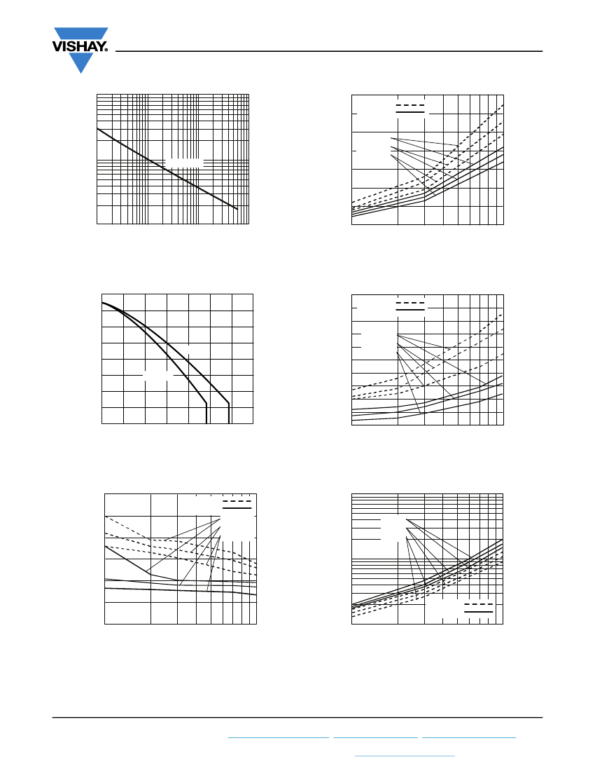

- Instantaneous Forward Current (A)
1000
10 000
= 150 °C
- Reverse Current (µA)
1000
= 125 °C
= 150 °C
= 125 °C
= 25 °C
= 25 °C
0.2
0.7
1.2
1.7
2.2
2.7
3.2
600
FM
- Forward Voltage Drop (V)
Fig. 1 - Maximum Forward Voltage Drop vs.
Instantaneous Forward Current (Per Leg)
- Reverse Voltage (V)
Fig. 2 - Typical Reverse Current vs. Reverse Voltage
(Per Leg)
Revision: 11-Jan-18
Document Number: 94067
For technical questions within your region:
DiodesAmericas@vishay.com, DiodesAsia@vishay.com, DiodesEurope@vishay.com
www.vishay.com/doc?91000
VS-HFA280NJ60CPbF
www.vishay.com
= 125 °C
= 25 °C
10 000
- Junction Capacitance (pF)
RRM
(A)
1000
= 25 °C
= 200 A
= 140 A
= 50 A
1000
1000
Fig. 3 - Typical Junction Capacitance vs. Reverse Voltage (Per Leg)
dI
/dt (A/µs)
Fig. 6 - Typical Recovery Current vs. dI
/dt (Per Leg)
160
140
5000
= 125 °C
= 25 °C
4000
= 200 A
= 140 A
= 50 A
Maximum Allowable
Case Temperature (°C)
120
DC
D = 0.50
Q
rr
(nC)
3000
2000
1000
250
350
1000
F(AV)
- DC Forward Current (A)
Fig. 4 - Maximum Allowable Case Temperature vs. DC Forward
Current (Per Leg)
250
= 125 °C
= 25 °C
dI
/dt (A/µs)
Fig. 7 - Typical Stored Charge vs. dI
/dt (Per Leg)
10 000
dI
(rec)M
/dt (A/µs)
= 200 A
= 140 A
= 50 A
200 A
140 A
50 A
rr
(ns)
1000
= 125 °C
= 25 °C
1000
1000
dI
/dt (A/µs)
Fig. 5 - Typical Reverse Recovery Time vs. dI
/dt (Per Leg)
dI
/dt (A/µs)
Fig. 8 - Typical dI
(rec)M
/dt vs. dI
/dt (Per Leg)
