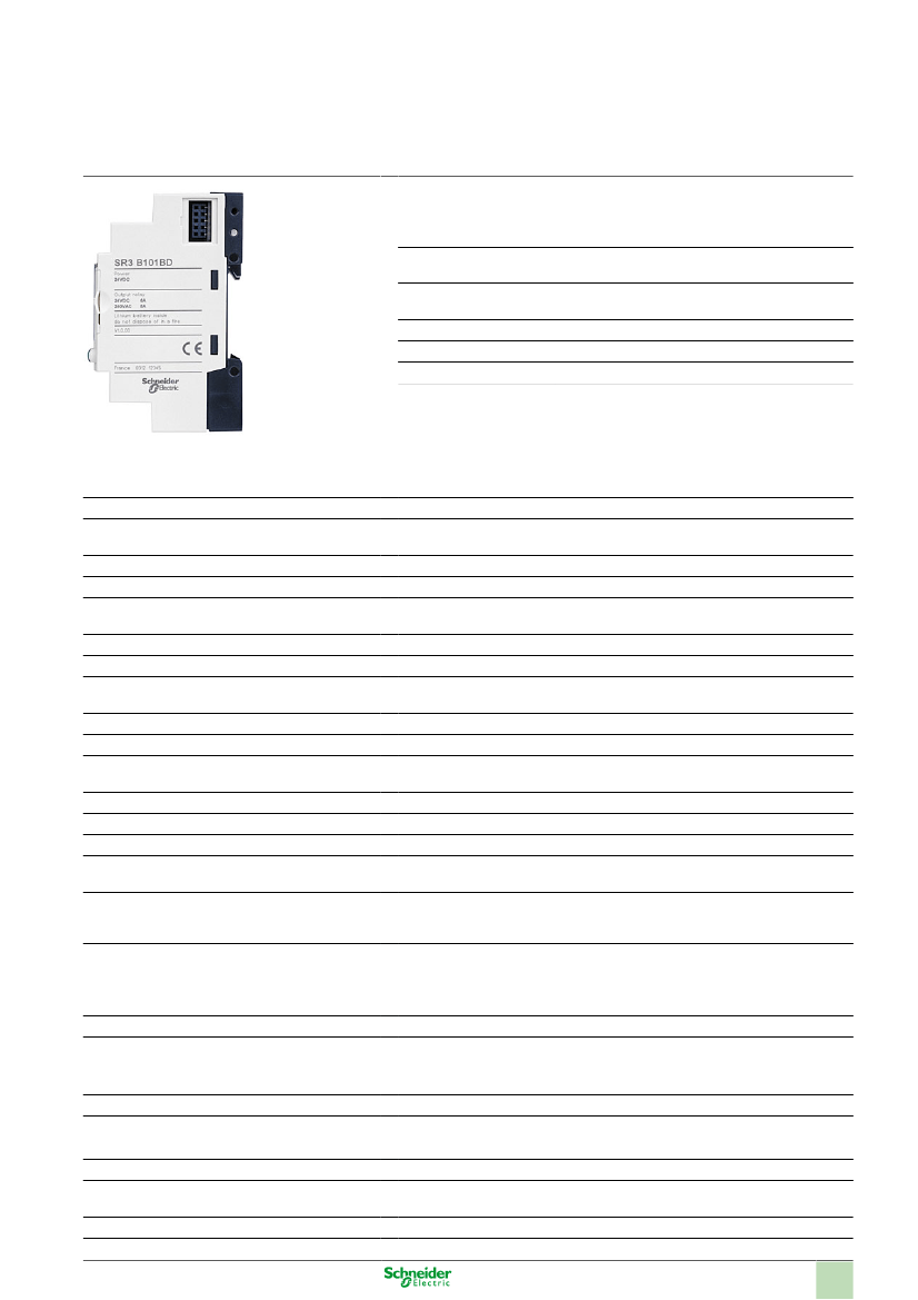

Product data sheet
Characteristics
SR3B101BD
modular smart relay Zelio Logic - 10 I O - 24 V
DC - clock - display
Main
Range of product
Product or component
type
[Us] rated supply volt-
age
Discrete input number
Analogue input number
Number of outputs
Zelio Logic
Modular smart relay
24 V DC
6 EN/IEC 61131-2 type 1
4 relay
Complementary
Local display
