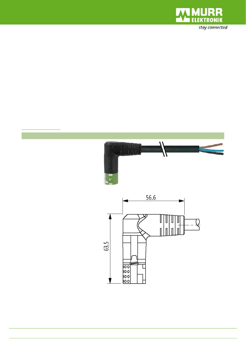

INT ERNET DAT A SHEET for Article Number 7000-P8232-P233000
MQ15-X-Power f emale 90°lef t , wit h cable
PVC 4x2,5 bk UL/CSA 30,0m
Female 90°
MQ15, 4-pole
Quick connection technology
without cable sleeves
Plastic housings with good resistance against chemicals and oils. The resistance to
aggressive media should be individually tested for your application. Further details on
request. Further cable lengths on request.
Link t o Product
Illustra tio n

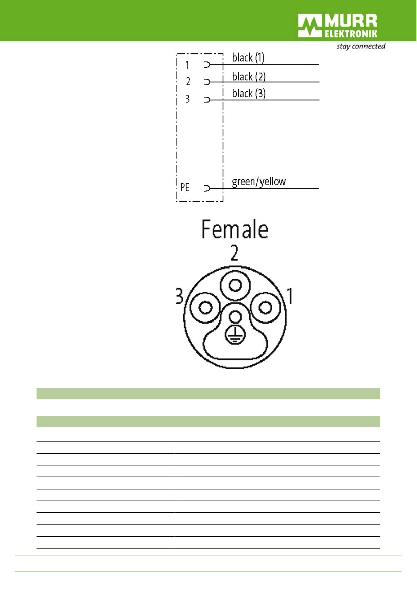

T ec hnic a l da ta
Op erating vo ltag e
Rated surg e vo ltag e
Op erating current p er co ntact
Material g ro up
No . o f p o les
Co nfig uratio n
LED d isp lay
Lo cking o f p o rts
Pro tectio n
Material
