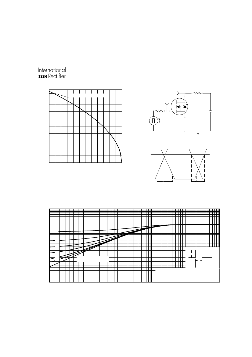

IRFBA90N20D
LIMITED BY PACKAGE
GS
DS
D.U.T.
DD
, Drain Current (A)
10V
Pulse Width
≤ 1
µs
Duty Factor
≤ 0.1 %
Fig 10a.
Switching Time Test Circuit
DS
90%
75
125
175
, Case Temperature
( °C)
10%
GS
d(on)
r
d(off)
f
Fig 9.
Maximum Drain Current Vs.
Case Temperature
Fig 10b.
Switching Time Waveforms
(Z
thJC
D = 0.50
0.1
0.20
Thermal Response
0.10
0.05
0.01
0.02
0.01
SINGLE PULSE
(THERMAL RESPONSE)
Notes:
1. Duty factor D =
2. Peak T
0.001
0.00001
/ t
= P
DM
x Z
thJC
DM
+T
0.0001
0.001
0.01
0.1
, Rectangular Pulse Duration (sec)
Fig 11.
Maximum Effective Transient Thermal Impedance, Junction-to-Case
www.irf.com
