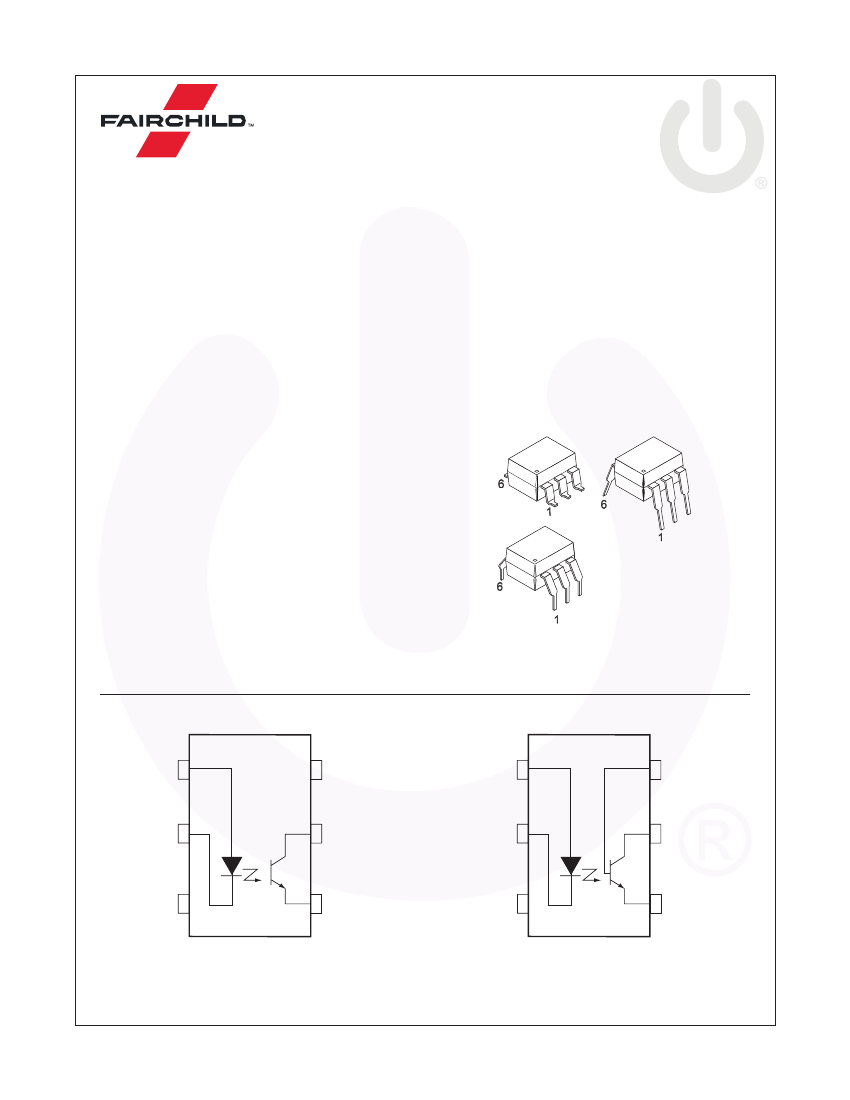

CNY17XM, CNY17FXM, MOC8106M — 6-Pin DIP High BV
CEO
Phototransistor Optocouplers
October 2014
CNY171M, CNY172M, CNY173M, CNY174M,
CNY17F1M, CNY17F2M, CNY17F3M, CNY17F4M,
MOC8106M
6-Pin DIP High BV
CEO
High BV
CEO
: 70 V Minimum (CNY17XM, CNY17FXM,
The CNY17XM, CNY17FXM, and MOC8106M devices
consist of a gallium arsenide infrared emitting diode
coupled with an NPN phototransistor in a dual in-line
package.
MOC8106M)
Closely Matched Current Transfer Ratio (CTR)
Minimizes Unit-to-Unit Variation
Current Transfer Ratio In Select Groups
Very Low Coupled Capacitance Along With
No Chip-to-Pin 6 Base Connection for Minimum Noise
Susceptability (CNY17FXM, MOC8106M)
Safety and Regulatory Approvals:
– UL1577, 4,170 VAC
RMS
for 1 Minute
– DIN-EN/IEC60747-5-5, 850 V Peak Working
Insulation Voltage
Package Outlines
Power Supply Regulators
Digital Logic Inputs
Microprocessor Inputs
Appliance Sensor Systems
Industrial Controls
Figure 1. Package Outlines
Schematics
ANODE 1
6 NC
ANODE 1
6 BASE
CATHODE 2
5 COLLECTOR
CATHODE 2
5 COLLECTOR
NC 3
4 EMITTER
NC 3
4 EMITTER
CNY17F1M/2M/3M/4M
MOC8106M
CNY171M/2M/3M/4M
Figure 2. Schematics

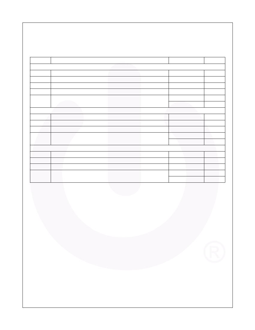

CEO
Absolute Maximum Ratings
Stresses exceeding the absolute maximum ratings may damage the device. The device may not function or be
operable above the recommended operating conditions and stressing the parts to these levels is not recommended.
In addition, extended exposure to stresses above the recommended operating conditions may affect device reliability.
The absolute maximum ratings are stress ratings only.
TOTAL DEVICE
STG
SOL
EMITTER
(pk)
DETECTOR
CEO
ECO
Storage Temperature
Parameters
Value
-40 to +125
-40 to +100
-40 to +125
260 for 10 seconds
270
2.94
120
1.41
1.76
Units
ºC
mW
mW/°C
mW
mW/°C
mW
mW/°C
Ambient Operating Temperature
Junction Temperature
Lead Solder Temperature
Total Device Power Dissipation @ 25°C (LED plus detector)
Derate Linearly From 25°C
Continuous Forward Current
Reverse Voltage
Forward Current – Peak (1 µs pulse, 300 pps)
LED Power Dissipation 25°C Ambient
Continuous Collector Current
Collector-Emitter Voltage
Emitter Collector Voltage
Detector Power Dissipation @ 25°C
Derate Linearly from 25°C

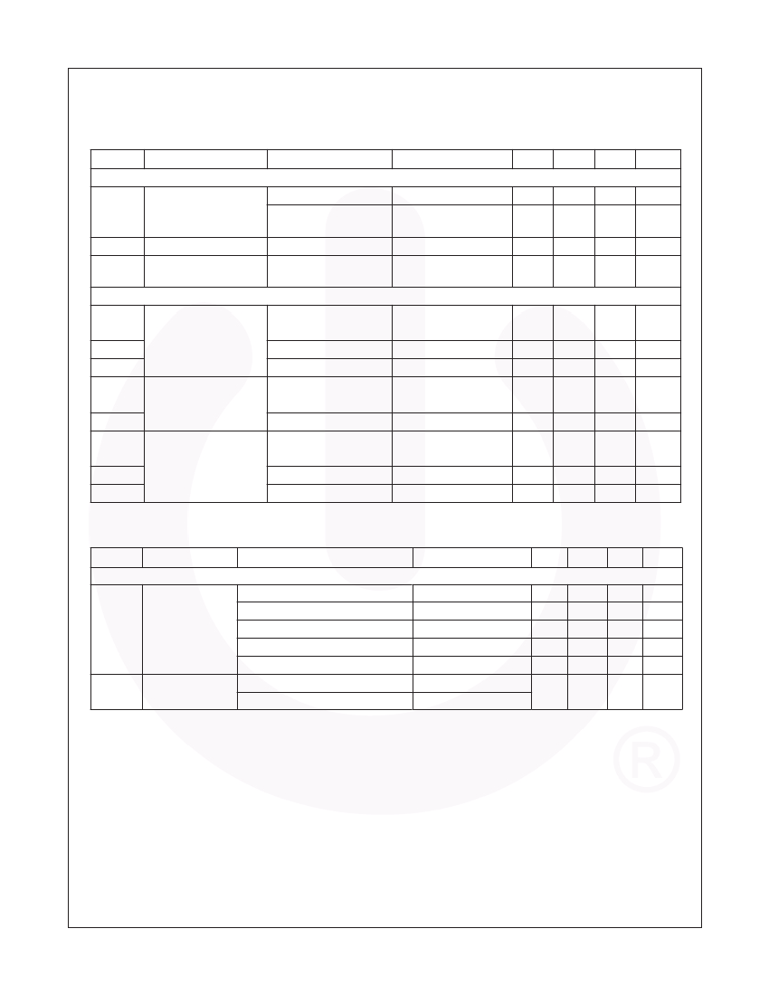

CEO
Electrical Characteristics
= 25°C unless otherwise specified.
Individual Component Characteristics
Parameters
Test Conditions
EMITTER
= 10 mA
Input Forward Voltage
Capacitance
Reverse Leakage
Current
Breakdown Voltage
BV
CEO
BV
CBO
BV
ECO
CEO
CBO
CE
CB
EB
Collector-to-Emitter
Collector-to-Base
Emitter-to-Collector
Leakage Current
Collector-to-Base
Capacitance
Collector-to-Base
Emitter-to-Base
CE
= 0, f = 1 MHz
CB
= 0, f = 1 MHz
EB
= 0, f = 1 MHz
CE
= 10 V, I
= 0
CB
= 10 V, I
= 0
= 1 mA, I
= 0
= 10 µA, I
= 0
= 100 µA, I
= 0
= 60 mA
= 0 V, f = 1.0 MHz
= 6 V
Device
All Devices
CNY17XM,
CNY17FXM
All Devices
All Devices
Min.
Typ.
1.15
1.35
0.001
Max.
1.50
1.65
Units
pF
µA
DETECTOR
All Devices
CNY17XM
All Devices
All Devices
CNY17XM
All Devices
CNY17XM
CNY17XM
120
nA
nA
pF
pF
pF
Transfer Characteristics
COUPLED
= 10 mA, V
CE
= 10 V
CTR
Current Transfer
Ratio
= 10 mA, V
CE
= 5 V
= 10 mA, V
CE
= 5 V
= 10 mA, V
CE
= 5 V
= 10 mA, V
CE
= 5 V
CE(SAT)
Collector-Emitter I
= 0.5 mA, I
= 5 mA
Saturation Voltage I
= 2.5 mA, I
= 10 mA
MOC8106M
CNY171M, CNY17F1M
CNY172M, CNY17F2M
CNY173M, CNY17F3M
CNY174M, CNY17F4M
MOC8106M
CNY17XM/CNY17FXM
63
160
125
320
0.4
Parameters
Test Conditions
Device
Min.
Typ.
Max. Units

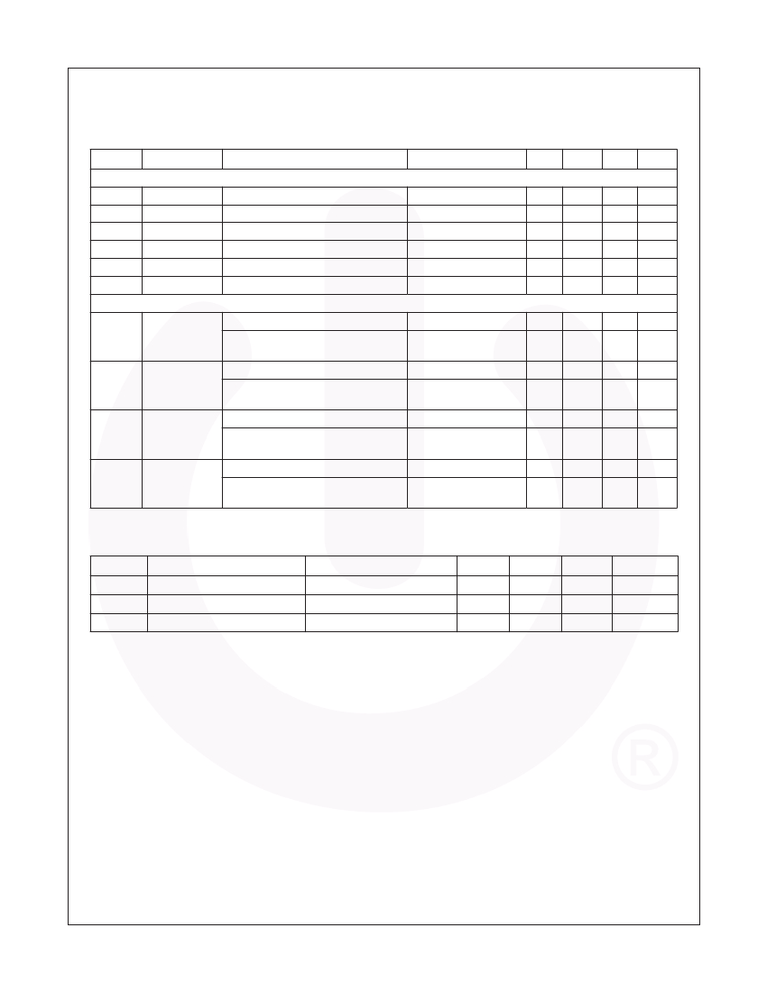

CEO
(Continued)
AC Characteristics
on
off
d
r
s
f
Parameters
Turn-On Time
Turn-Off Time
Delay Time
Rise Time
Storage Time
Fall Time
Test Conditions
= 2.0 mA, V
CC
= 10 V, R
= 100
Ω
= 2.0 mA, V
CC
= 10 V, R
= 100
Ω
= 10 mA, V
CC
= 5 V, R
= 75
Ω
= 10 mA, V
CC
= 5 V, R
= 75
Ω
= 10 mA, V
CC
= 5 V, R
= 75
Ω
= 10 mA, V
CC
= 5 V, R
= 75
Ω
= 20 mA, V
CC
= 5 V, R
= 1 kΩ
Device
All Devices
All Devices
CNY17XM/CNY17FXM
CNY17XM/CNY17FXM
CNY17XM/CNY17FXM
CNY17XM/CNY17FXM
CNY171M/F1M
CNY172M/3M/4M
CNY17F2M/F3M/F4M
CNY171M/F1M
CNY172M/3M/4M
CNY17F2M/F3M/F4M
CNY171M/F1M
CNY172M/3M/4M
CNY17F2M/F3M/F4M
CNY171M/F1M
CNY172M/3M/4M
CNY17F2M/F3M/F4M
Min.
Typ.
2.0
3.0
Max. Units
10.0
10.0
5.6
4.0
4.1
3.5
5.5
8.0
4.0
6.0
34.0
39.0
20.0
24.0
µs
µs
µs
µs
µs
µs
µs
µs
µs
µs
µs
µs
µs
µs
NON-SATURATED SWITCHING TIME
SATURATED SWITCHING TIMES
d
Delay Time
= 10 mA, V
CC
= 5 V, R
= 1 kΩ
= 20 mA, V
CC
= 5 V, R
= 1 kΩ
r
Rise Time
= 10 mA, V
CC
= 5 V, R
= 1 kΩ
= 20 mA, V
CC
= 5 V, R
= 1 kΩ
s
Storage Time
= 10 mA, V
CC
= 5 V, R
= 1 kΩ
= 20 mA, V
CC
= 5 V, R
= 1 kΩ
f
Fall Time
= 10 mA, V
CC
= 5 V, R
= 1 kΩ
Isolation Characteristics
ISO
ISO
ISO
Characteristic
Isolation Capacitance
Isolation Resistance
Test Conditions
I-O
= 0 V, f = 1 MHz
I-O
= ±500 VDC, T
= 25°C
Min.
4170
Typ.
0.2
Max.
Units
VAC
RMS
pF
Ω
Input-Output Isolation Voltage t = 1 Minute
