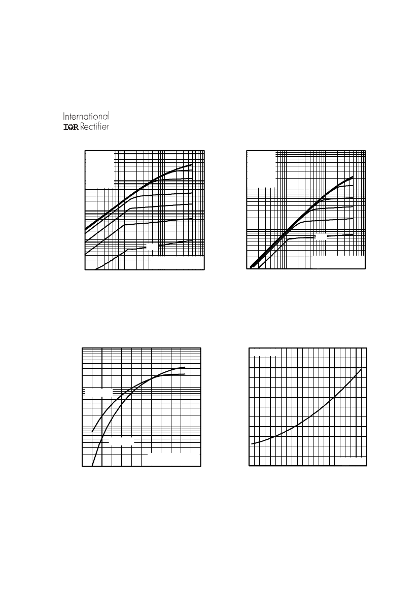

IRF740A
VGS
15V
10V
8.0V
7.0V
6.0V
5.5V
5.0V
BOTTOM 4.5V
TOP
, Drain-to-Source Current (A)
VGS
15V
10V
8.0V
7.0V
6.0V
5.5V
5.0V
BOTTOM 4.5V
TOP
0.1
4.5V
4.5V
20µs PULSE WIDTH
= 25
0.01
0.1
0.1
0.1
20µs PULSE WIDTH
= 150
DS
, Drain-to-Source Voltage (V)
DS
Fig 1.
Typical Output Characteristics
Fig 2.
3.0
= 10A
DS(on)
, Drain-to-Source On Resistance
(Normalized)
2.5
2.0
= 150
= 25
V DS = 50V
20µs PULSE WIDTH
5.0
6.0
7.0
8.0
9.0
10.0
0.1
4.0
0.0
-60 -40 -20
GS
= 10V
80 100 120 140 160
GS
, Gate-to-Source Voltage (V)
, Junction Temperature (
C)
Fig 3.
Typical Transfer Characteristics
Fig 4.
Normalized On-Resistance
Vs. Temperature
www.irf.com

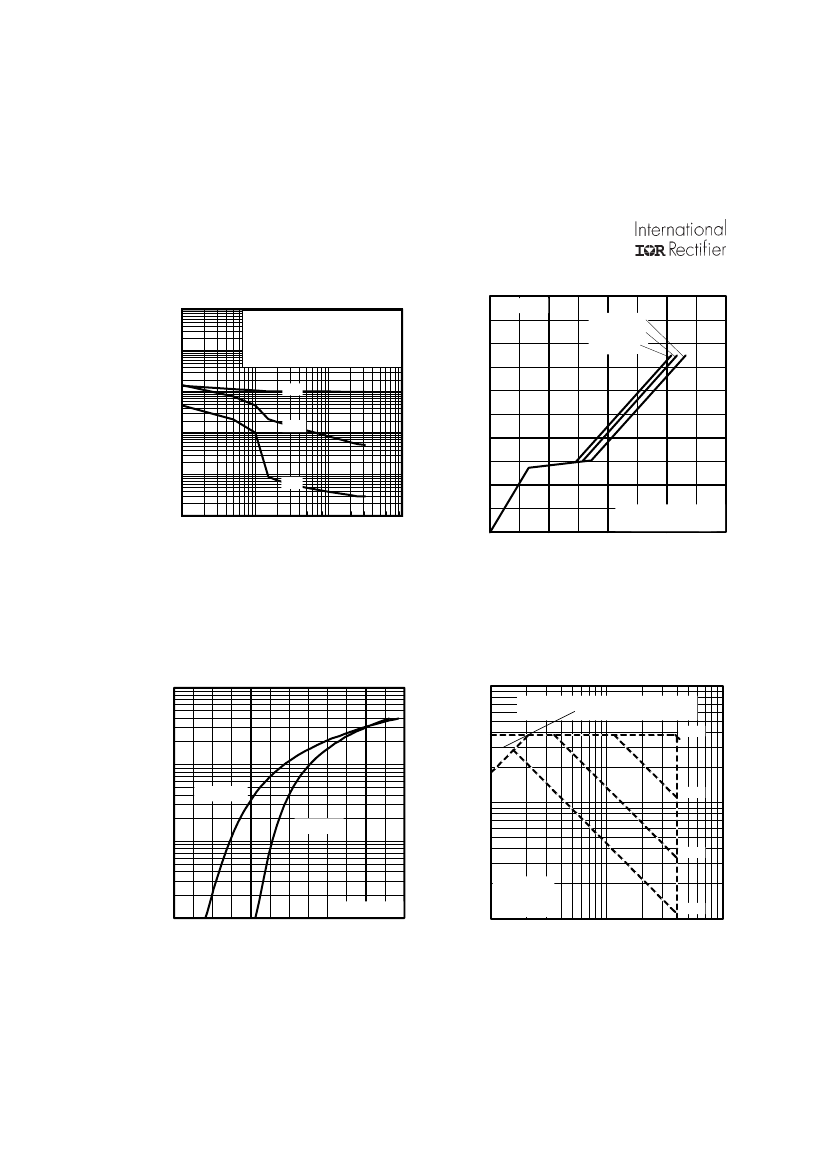

IRF740A
100000
= 10A
DS
= 320V
DS
= 200V
DS
= 80V
GS
10000
VGS = 0V,
f = 1 MHZ
Ciss = C + Cgd , C
gs
ds SHORTED
Crss = C
gd
Coss = C + C
ds gd
C, Capacitance(pF)
1000
Ciss
Coss
Crss
1000
FOR TEST CIRCUIT
SEE FIGURE 13
VDS, Drain-to-Source Voltage (V)
Q
, Total Gate Charge (nC)
Fig 5.
Typical Capacitance Vs.
Fig 6.
Typical Gate Charge Vs.
OPERATION IN THIS AREA LIMITED
BY R
DS(on)
SD
, Reverse Drain Current (A)
10us
, Drain Current (A)
= 150
= 25
100us
1ms
0.1
0.2
GS
= 0 V
0.4
0.6
0.8
1.2
1.4
= 25 ° C
= 150 ° C
Single Pulse
10ms
1000
SD
,Source-to-Drain Voltage (V)
DS
Fig 7.
Typical Source-Drain Diode
Forward Voltage
Fig 8.
Maximum Safe Operating Area
www.irf.com

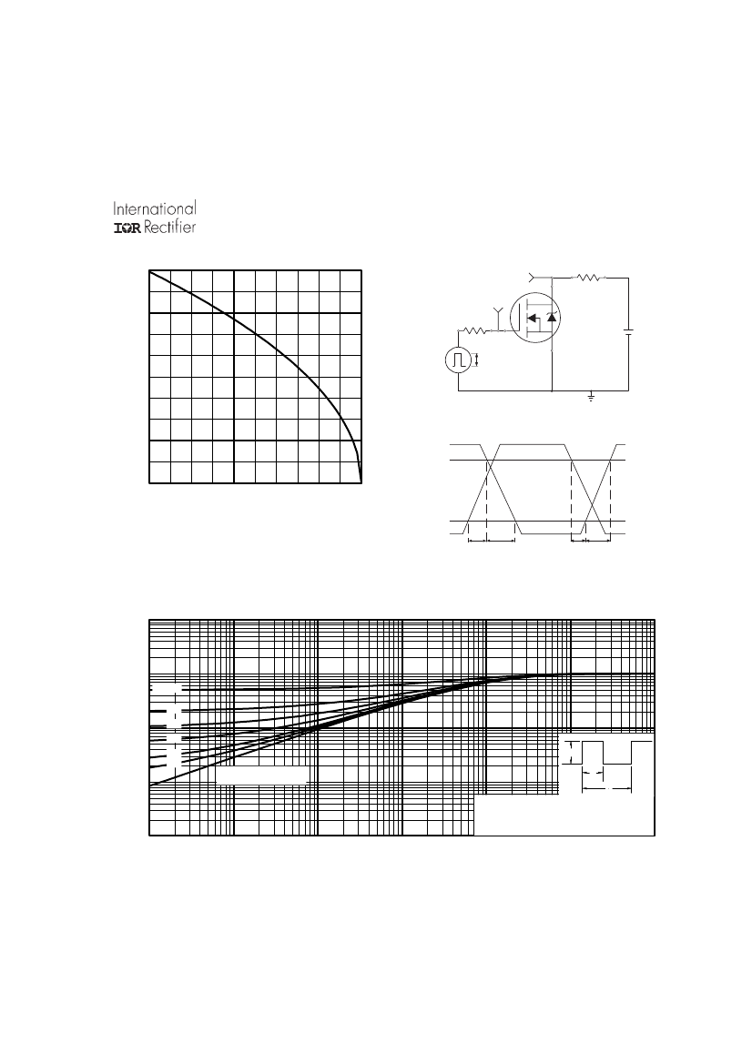

IRF740A
10.0
DS
GS
8.0
D.U.T.
, Drain Current (A)
DD
6.0
10V
Pulse Width
≤ 1
µs
Duty Factor
≤ 0.1 %
4.0
Fig 10a.
Switching Time Test Circuit
2.0
DS
90%
0.0
75
125
, Case Temperature
( °C)
10%
GS
Fig 9.
Maximum Drain Current Vs.
Case Temperature
d(on)
r
d(off)
f
Fig 10b.
Switching Time Waveforms
Thermal Response (Z
thJC
D = 0.50
0.20
0.1
0.10
0.05
0.02
0.01
SINGLE PULSE
(THERMAL RESPONSE)
DM
Notes:
1. Duty factor D = t
/ t
2. Peak T
= P
DM
x Z
thJC
+ T
0.0001
0.001
0.01
0.1
0.01
0.001
0.00001
, Rectangular Pulse Duration (sec)
Fig 11.
Maximum Effective Transient Thermal Impedance, Junction-to-Case
www.irf.com
