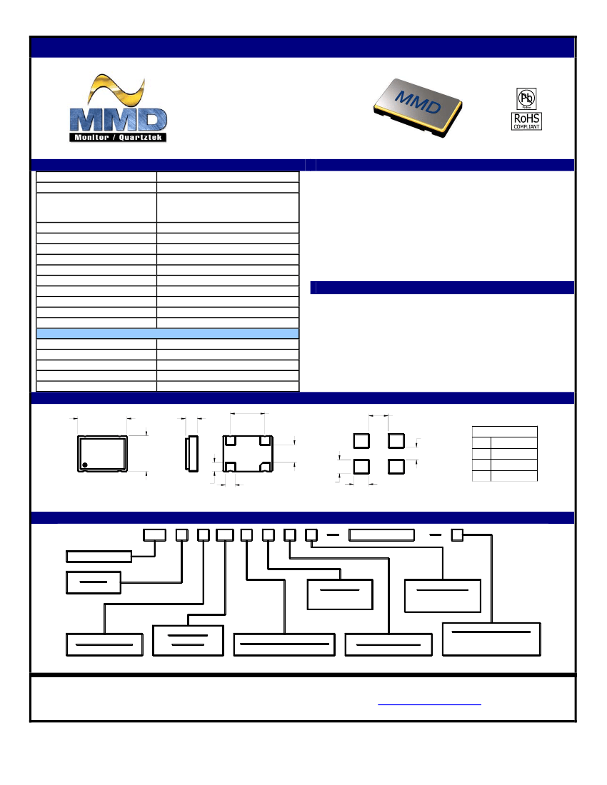

MILH Series
5mm x 7mm x 1.7mm
SMD Package
3.3 Volts
-55°c to +125°c
Tape and Reel Packaging
ELECTRICAL SPECIFICATIONS:
Frequency
Frequency Tolerance @ +25°C
Frequency Stability (Inclusive
of Temperature, Load, Voltage,
and Aging)
Operating Temperature Range
Storage Temperature Range
Output
Logic “0”
Logic “1”
Symmetry (50% of waveform)
Output Load
Rise/Fall Time
Start Up Time
Supply Voltage (Vdd)
Supply Current
1.500 MHz – 20.000 MHz
21.000 MHz – 50.000 MHz
51.000 MHz - max
Shock, Survival
Vibration, Survival
1.500 MHz to 155.520 MHz
±25ppm
±100ppm
-55°C to +125°C
-55°C to +125°C
HCMOS
10% Vdd max
90% Vdd min
(See Part Number Guide)
15pF
5nSec max
10mSec max
+3.3 VDC ±5%
12 mA max
15 mA max
40mA max
3000 g Peak 0.3 mSec, ½ Sine
20 g RMS 10-2000 Hz Random
5.08 [.200]
MARKING:
Line 1: MXX.XXX
XX.XXX = Frequency in MHz
Line 2: SYYMML
S = Internal Code
YYMM = Date Code (Year/Month)
L = Denotes RoHS Compliant
TRI-STATE OPERATION:
Logic “1” or NC = Oscillation
Logic “0” or GND = High Impedance
MECHANICAL DETAILS:
7.20 [.283]
MAX
1.70 [.067]
MAX
2.88 [.113]
Pin Connections
Pin 1 Tri-state
Pin 2 Case Ground
Pin 3 Output
2.00 [.079]
Pin 4 Supply Voltage
2.20 [.087]
Recommended Land
Pattern
1.81 [.071]
MARKING
5.20 [.205]
MAX
2.60 [.102]
1.30 [.051]
Dimension in Brackets are in Inches
External Bypass Capacitor is Recommended
1.40 [.055]
PART NUMBER GUIDE:
MIL
5 x 7 Ceramic SMD
Output
H = HCMOS
55
Frequency
Symmetry
Blank = 40/60%
A = 45/55%
Frequency
Stability
100 = ±100 ppm
Special Specs
M = MIL-STD-883
V = 100KRADsi
Value Added Options
Supply Voltage
3 = +3.3 VDC
55 = -55°C to +125°C
Pin 1 Connection
H = Tri-state
Blank = No Added Options
T = Tape and Reel
Please Consult with MMD sales department for any other parameters or options.
MMD Components,
30400 Esperanza, Rancho Santa Margarita, CA, 92688
Phone: (949) 709-5075, Fax: (949) 709-3536,
www.mmdcomp.com
Sales@mmdcomp.com
Specifications subject to change without notice
Revision 01/02/07 I
