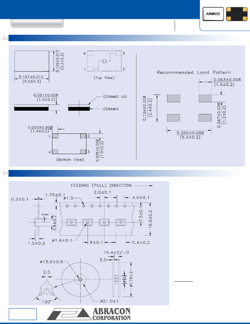

物理尺寸L5.0XB3.2XH1.3 (mm)/L0.197XB0.126XH0.051 (inch)
