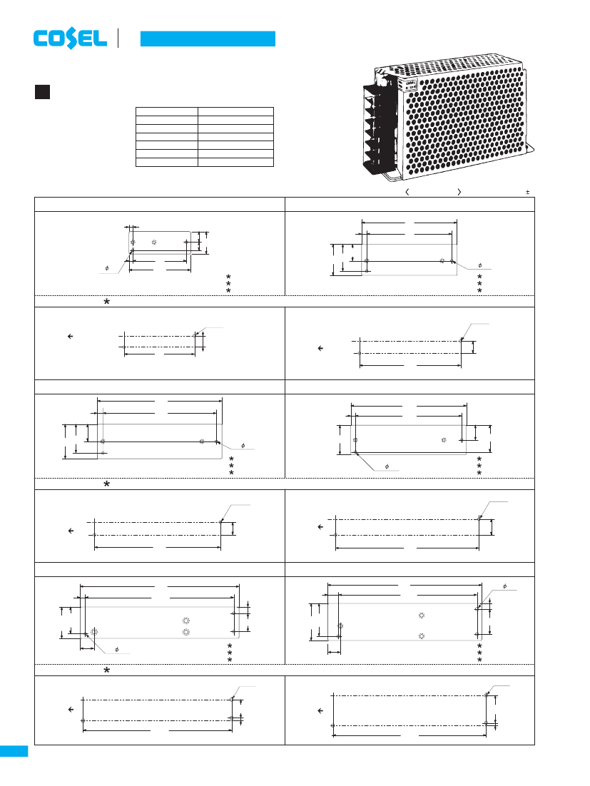

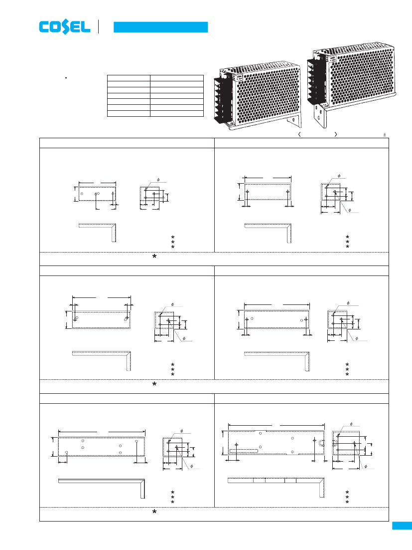

Optional Parts
R Series Attachment
BASE Attachment
Plate model
Applicable models
F-R10-1
F-R15-1
F-R25-1
F-R50-1
F-R100-1
F-R150-1
R10A
R15A
R25A
R50A
R100
R150
Example
(R100)
TOP VIEW
(Unit : mm) (Tolerance : 1)
F-R10-1
13.5
F-R15-1
Size
27
26
94
84
Size
4.5
2 - 3.5
68
77.5
Material : SPCC
Thickness : 2.0
Weight : 40g max
2 - 3.5
Material : SPCC
Thickness : 2.0
Weight : 50g max
M3 Flat screw is requested when mounting. Please check the instruction manual for the size of screw.
Mounting hole size
2-M3
Mounting hole size
2-M3
FRONT
68
FRONT
84
F-R25-1
Size
15.5
114
104
F-R50-1
Size
33
129
119
16.5
2 - 3.5
Material : SPCC
Thickness : 2.0
Weight : 80g max
31
26
2 - 3.5
Material : SPCC
Thickness : 2.0
Weight : 65g max
Mounting hole size
2-M3
Mounting hole size
2-M3
119
10.5
FRONT
104
FRONT
F-R100-1
Size
6.5
34.5
29.5
172
159.5
F-R150-1
Size
13.5
44.5
39.5
187
167.5
3 - 4.5
15.5
Material : SPCC
Thickness : 2.0
Weight : 150g max
3 - 4.5
Material : SPCC
Thickness : 2.0
Weight : 110g max
M4 Flat screw is requested when mounting. Please check the instruction manual for the size of screw.
Mounting hole size
FRONT
159.5
3-M4
Mounting hole size
FRONT
167.5
2.5
Option
Option-2
2.5
3-M4
13.5
