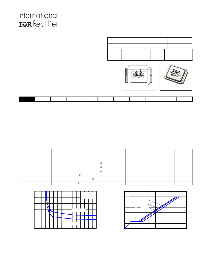

The IRF6811STRPbF combines the latest HEXFET
Power MOSFET Silicon technology with the advanced DirectFET
packaging to achieve
improved performance in a package that has the footprint of a MICRO-8 and only 0.7 mm profile. The DirectFET
package is compatible with
existing layout geometries used in power applications, PCB assembly equipment and vapor phase, infra-red or convection soldering tech-
niques, when application note AN-1035 is followed regarding the manufacturing methods and processes. The DirectFET
package allows
dual sided cooling to maximize thermal transfer in power systems, improving previous best thermal resistance by 80%.
The IRF6811STRPbF has low gate resistance and low charge along with ultra low package inductance providing significant reduction in
switching losses. The reduced losses make this product ideal for high efficiency DC-DC converters that power the latest generation of
processors operating at higher frequencies. The IRF6811STRPbF has been optimized for the control FET socket of synchronous buck
operating from 12 volt bus converters.
Absolute Maximum Ratings
DS
GS
@ T
= 25°C
@ T
= 70°C
@ T
= 25°C
DM
AS
AR
Typical RDS(on) (mΩ)
Max.
Units
Drain-to-Source Voltage
Gate-to-Source Voltage
Continuous Drain Current, V
GS
@ 10V
GS
@ 10V
GS
@ 10V
Pulsed Drain Current
Single Pulse Avalanche Energy
Avalanche Current
g
e
e
f
Ãg
h
VGS, Gate-to-Source Voltage (V)
±16
19
74
32
14.0
12.0
10.0
8.0
6.0
4.0
2.0
0.0
ID= 15A
VDS= 20V
mJ
T J = 25°C
ID = 19A
TJ = 125°C
VDS= 13V
VDS= 5.0V
0 1 2 3 4 5 6 7 8 9 10 11 12 13 14 15 16
VGS, Gate -to -Source Voltage (V)
Fig 1.
Typical On-Resistance vs. Gate Voltage
Notes:
Click on this section to link to the appropriate technical paper.
Click on this section to link to the DirectFET Website.
Surface mounted on 1 in. square Cu board, steady state.
QG Total Gate Charge (nC)
Fig 2.
Typical Total Gate Charge vs Gate-to-Source Voltage
measured with thermocouple mounted to top (Drain) of part.
Repetitive rating; pulse width limited by max. junction temperature.
Starting T
= 25°C, L = 0.28mH, R
= 50Ω, I
AS
= 15A.
www.irf.com
01/28/11
IRF6811SPbF

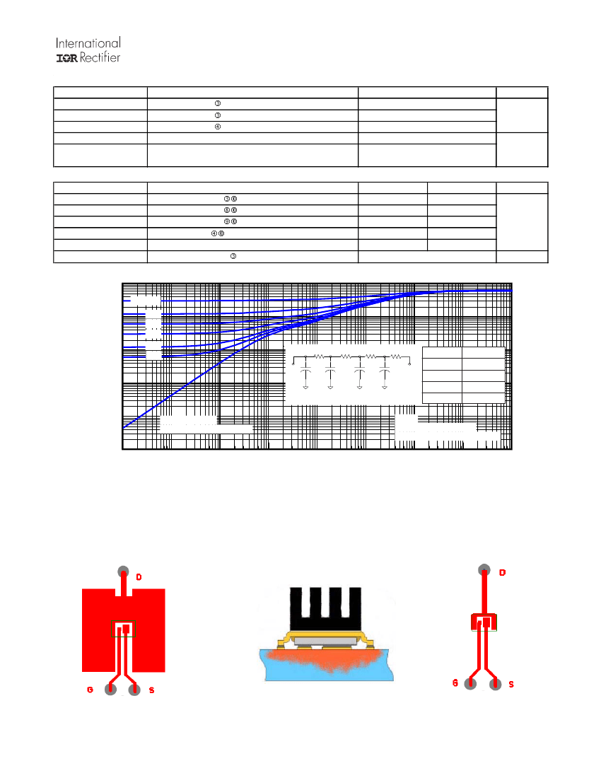

Thermal Resistance
θJA
θJA
θJA
θJC
θJ-PCB
Junction-to-Ambient
Junction-to-Ambient
Junction-to-Ambient
Junction-to-Case
Junction-to-PCB Mounted
Linear Derating Factor
D = 0.50
Thermal Response ( Z thJA )
el
jl
kl
fl
Typ.
12.5
0.017
Max.
3.9
Units
°C/W
eÃ
W/°C
0.20
0.10
0.05
0.02
0.01
τ
τ
τ
τ
τ
τ
τ
τ
Ri (°C/W)
21.298
24.844
3.3632
10.411
2.002815
0.296144
0.000886
0.027621
τi
(sec)
0.1
τ
τ
τ
τ
Ci=
τi/Ri
Ci=
τi/Ri
0.01
SINGLE PULSE
( THERMAL RESPONSE )
Notes:
1. Duty Factor D = t1/t2
2. Peak Tj = P dm x Zthja + Tc
0.001
0.01
0.1
0.001
1E-006
1E-005
0.0001
t1 , Rectangular Pulse Duration (sec)
Fig 3.
Maximum Effective Transient Thermal Impedance, Junction-to-Ambient
Used double sided cooling, mounting pad with large heatsink.
Mounted on minimum footprint full size board with metalized
back and with small clip heatsink.
Notes:
θ
is measured at
of approximately 90°C.
(still air).
Mounted to a PCB
with
small clip heatsink (still air)
Mounted on minimum
metalized back and with small
www.irf.com

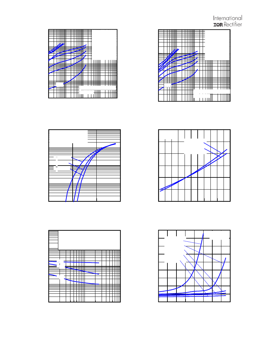

1000
TOP
VGS
10V
5.0V
4.5V
3.5V
3.3V
3.0V
2.8V
2.5V
1000
TOP
VGS
10V
5.0V
4.5V
3.5V
3.3V
3.0V
2.8V
2.5V
ID, Drain-to-Source Current (A)
BOTTOM
BOTTOM
2.5V
2.5V
60µs PULSE WIDTH
Tj = 25°C
60µs PULSE WIDTH
Tj = 150°C
0.1
1000
V DS, Drain-to-Source Voltage (V)
0.1
0.1
1000
VDS, Drain-to-Source Voltage (V)
Fig 4.
Typical Output Characteristics
1000
VDS = 15V
≤60µs
PULSE WIDTH
TJ = 150°C
TJ = 25°C
TJ = -40°C
Typical RDS(on) (Normalized)
Fig 5.
2.0
ID = 19A
V GS = 10V
V GS = 4.5V
0.1
-60 -40 -20 0
20 40 60 80 100 120 140 160
T J , Junction Temperature (°C)
Fig 6.
Typical Transfer Characteristics
100000
VGS = 0V,
f = 1 MHZ
C iss = C gs + C gd, C ds SHORTED
C rss = C gd
Fig 7.
Normalized On-Resistance vs. Temperature
45
35
T J = 25°C
Vgs = 3.5V
Vgs = 4.0V
Vgs = 4.5V
Vgs = 5.0V
Vgs = 10V
Typical RDS(on) ( mΩ)
10000
C, Capacitance(pF)
C oss = C ds + C gd
Ciss
1000
Coss
Crss
100 120 140 160
Fig 8.
Typical Capacitance vs.Drain-to-Source Voltage
Fig 9.
Drain Current and Gate Voltage
ID, Drain Current (A)
www.irf.com

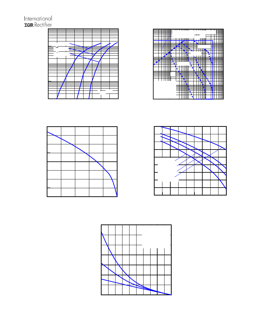

75
125
T C , Case Temperature (°C)
Fig11.
Maximum Safe Operating Area
2.4
2.2
2.0
1.8
1.6
1.4
1.2
0.8
0.6
-75 -50 -25
75 100 125 150
T J , Temperature ( °C )
ID = 25µA
ID = 250µA
ID = 1.0mA
ID = 1.0A
Fig 12.
Maximum Drain Current vs. Case Temperature
140
EAS , Single Pulse Avalanche Energy (mJ)
Fig 13.
Typical Threshold Voltage vs. Junction
Temperature
ID
TOP
1.4A
2.2A
BOTTOM 15A
120
75
125
Starting T J , Junction Temperature (°C)
Fig 14.
Maximum Avalanche Energy vs. Drain Current
www.irf.com
