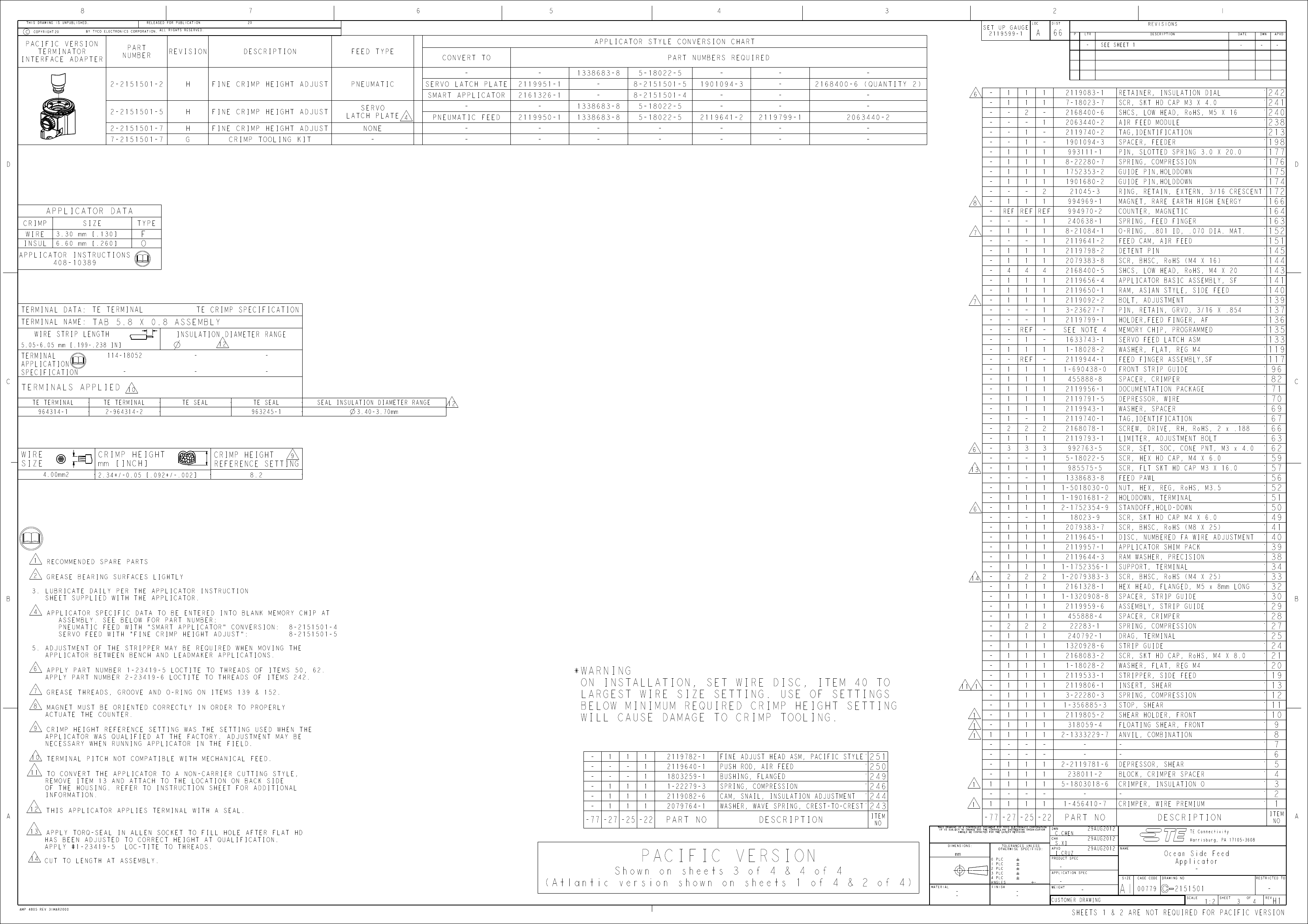

THIS DRAWING IS UNPUBLISHED.
RELEASED FOR PUBLICATION
BY TYCO ELECTRONICS CORPORATION.
ALL RIGHTS RESERVED.
SET UP GAUGE
2119599-1
LOC
DIST
REVISIONS
LTR
DESCRIPTION
DATE
DWN
APVD
COPYRIGHT
ATLANTIC VERSION
TERMINATOR
INTERFACE ADAPTER
PART
NUMBER
REVISION
DESCRIPTION
FEED TYPE
APPLICATOR STYLE CONVERSION CHART
CONVERT TO
SERVO LATCH PLATE
SMART APPLICATOR
PNEUMATIC FEED
2119951-1
2161326-1
1338683-8
PART NUMBERS REQUIRED
8- 2151501 -5
5-18022-5
5-18022-5
5-18022-5
1901094-3
2119799-1
2168400-6
(QUANTITY 2)
66
H1
ECR-16-011679
ECR-18-012024
15AUG2016
27JUL2018
MR
FL
GB
CT
2151501 -2
2151501 -5
2151501 -6
7- 2151501 -7
2151501 -7
FINE CRIMP HEIGHT ADJUST
NON-CRIMP HEIGHT ADJUST
CRIMP TOOLING KIT
PNEUMATIC
SERVO
LATCH PLATE
SERVO
LATCH PLATE
NONE
2119950-1
1338683-8
8- 2151501 -4
1338683-8
2119641-1
2063440-2
CRIMP
WIRE
INSUL
APPLICATOR DATA
3.30 mm [.130]
6.60 mm [.260]
SIZE
TYPE
APPLICATOR INSTRUCTIONS
408-10389
O
REF
REF REF REF
REF REF
TERMINAL DATA:
TERMINAL NAME:
5.05-6.05 mm [.199-.238 IN]
WIRE STRIP LENGTH
TAB 5.8 X 0.8 ASSEMBLY
n
TE TERMINAL
TE CRIMP SPECIFICATION
REF REF
INSULATION DIAMETER RANGE
TERMINAL
APPLICATION
SPECIFICATION
114-18052
TERMINALS APPLIED
TE TERMINAL
964314-1
C1__DWG_PN_1_0
C1__DWG_PN_1_1
TE TERMINAL
2-964314-2
C1__DWG_PN_2_0
TE SEAL
C1__DWG_PN_3_0
C1__DWG_PN_2_1
TE SEAL
963245-1
C1__DWG_PN_4_0
SEAL INSULATION DIAMETER RANGE
C1__DWG_PN_4_1
WIRE
SIZE
4.00mm2
CRIMP HEIGHT
mm [INCH]
W1__DWG_WGAUGE_1
2.34+/-0.05 [.092+/-.002]
CRIMP HEIGHT
REFERENCE SETTING
W1__DWG_CRIMP_HT_1
W1__FA_SETTING_1
8.2
RECOMMENDED SPARE PARTS
GREASE BEARING SURFACES LIGHTLY
2151501 -4
2151501 -5
2151501 -6
3. LUBRICATE DAILY PER THE APPLICATOR INSTRUCTION
SHEET SUPPLIED WITH THE APPLICATOR.
APPLICATOR SPECIFIC DATA TO BE ENTERED INTO BLANK MEMORY CHIP AT
ASSEMBLY. SEE BELOW FOR PART NUMBER:
PNEUMATIC FEED WITH "SMART APPLICATOR" CONVERSION: 8-
SERVO FEED WITH "FINE CRIMP HEIGHT ADJUST":
8-
SERVO FEED WITH "NON-CRIMP HEIGHT ADJUST":
8-
5. ADJUSTMENT OF THE STRIPPER MAY BE REQUIRED WHEN MOVING THE
APPLICATOR BETWEEN BENCH AND LEADMAKER APPLICATIONS.
APPLY PART NUMBER 1-23419-5 LOCTITE TO THREADS OF ITEMS 50, 62.
APPLY PART NUMBER 2-23419-6 LOCTITE TO THREADS OF ITEMS 242.
FOR -6 ONLY APPLY PART NUMBER 1-23419-5 LOCTITE TO THREADS OF ITEMS 37.
GREASE THREADS, GROOVE AND O-RING ON ITEMS 35 & 252.
MAGNET, ITEM 166 MUST BE ORIENTED CORRECTLY IN ORDER TO PROPERLY
ACTUATE THE COUNTER.
CRIMP HEIGHT REFERENCE SETTING WAS THE SETTING USED WHEN THE
APPLICATOR WAS QUALIFIED AT THE FACTORY. ADJUSTMENT MAY BE
NECESSARY WHEN RUNNING APPLICATOR IN THE FIELD.
TERMINAL PITCH NOT COMPATIBLE WITH MECHANICAL FEED.
TO CONVERT THE APPLICATOR TO A NON-CARRIER CUTTING STYLE,
REMOVE ITEM 13 AND ATTACH TO THE LOCATION ON THE BACK SIDE
OF THE HOUSING. REFER TO INSTRUCTION SHEET FOR ADDITIONAL
INFORMATION.
WHEN ASSEMBLING -6 NON-CRIMP HEIGHT ADJUST APPLICATOR
USE SHIM PACK 2119957-2 TO ALIGN APPLICATOR'S MAXIMUM
WIRE CRIMP HEIGHT AT NORMAL TERMINATOR SHUT HEIGHT
THIS APPLICATOR APPLIES TERMINAL WITH A SEAL.
APPLY TORQ-SEAL IN ALLEN SOCKET TO FILL HOLE AFTER FLAT HD
HAS BEEN ADJUSTED TO CORRECT HEIGHT AT QUALIFICATION.
APPLY #1-23419-5 LOC-TITE TO THREADS.
*WARNING
ON INSTALLATION, SET WIRE DISC, ITEM 40 TO
LARGEST WIRE SIZE SETTING. USE OF SETTINGS
BELOW MINIMUM REQUIRED CRIMP HEIGHT SETTING
WILL CAUSE DAMAGE TO CRIMP TOOLING.

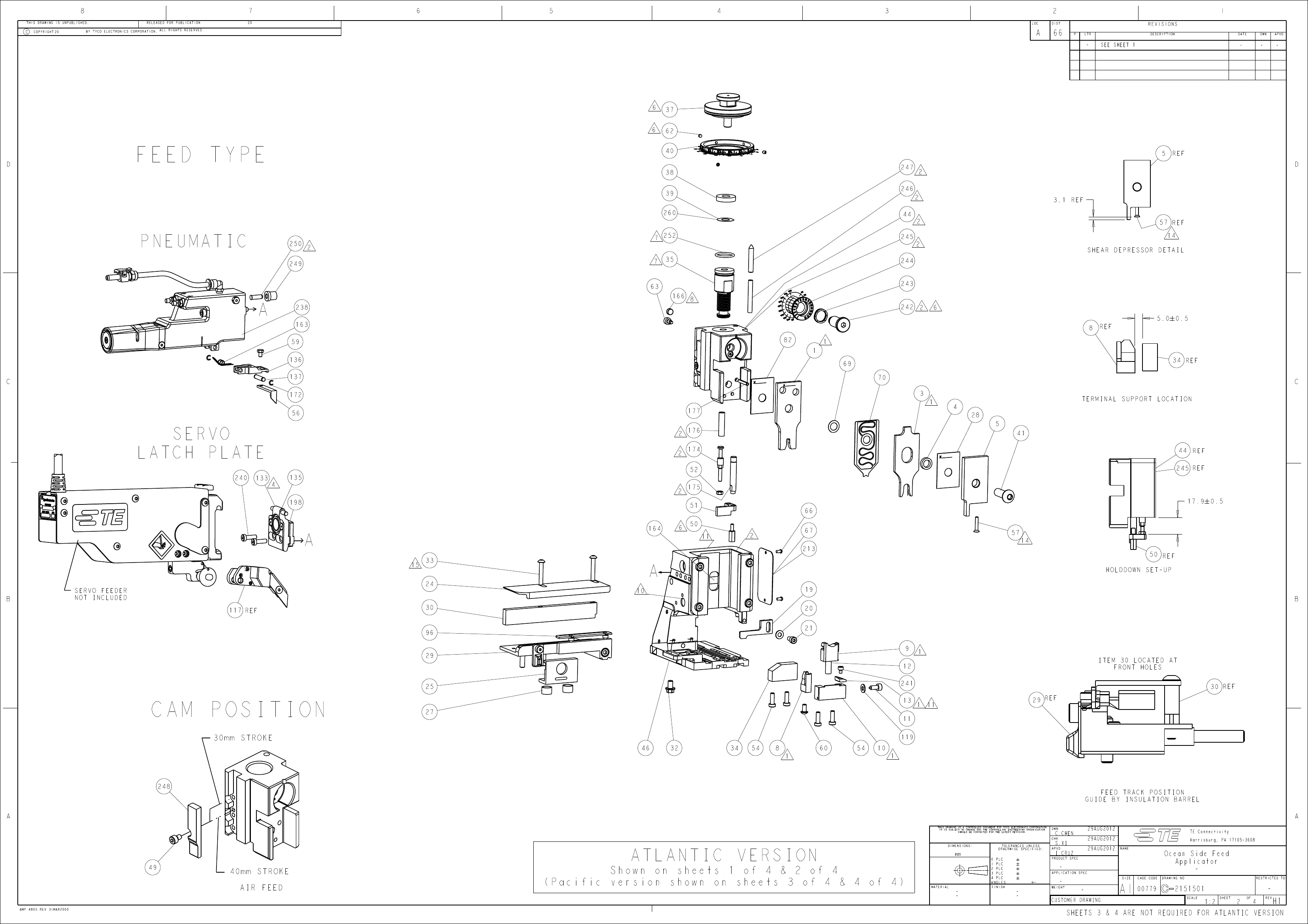

LOC
DIST
REVISIONS
LTR
DESCRIPTION
DATE
DWN
APVD
COPYRIGHT
66
SEE SHEET 1
37
62
38
39
260
247
246
REF
FEED TYPE
3.1 REF
57 REF
SHEAR DEPRESSOR DETAIL
44
245
244
243
PNEUMATIC
250
249
7 252
63
35
166
238
163
59
136
242
REF
5.0
82
69
TERMINAL SUPPORT LOCATION
28
34 REF
137
172
56
177
2 176
133
135
198
174
52
175
51
164
66
67
213
33
24
96
29
SERVO
LATCH PLATE
240
41
44
REF
245 REF
17.9
SERVO FEEDER
NOT INCLUDED
117 REF
57
50 REF
HOLDDOWN SET-UP
19
21
ITEM 30 LOCATED AT
FRONT HOLES
30 REF
241
29 REF
CAM POSITION
30mm STROKE
27
119
46
32
34
54
54
248
FEED TRACK POSITION
GUIDE BY
INSULATION BARREL
THIS DRAWING IS A CONTROLLED DOCUMENT FOR TYCO ELECTRONICS CORPORATION
IT IS SUBJECT TO CHANGE AND THE CONTROLLING ENGINEERING ORGANIZATION
SHOULD BE CONTACTED FOR THE LATEST REVISION.
DWN
CHK
C.CHEN
S.XI
I.CRUZ
29AUG2012
29AUG2012
29AUG2012
NAME
TE Connectivity
Harrisburg, PA 17105-3608
49
40mm STROKE
AIR FEED
Shown on sheets 1 of 4
& 2 of 4
(Pacific version shown on sheets 3 of 4
ATLANTIC VERSION
DIMENSIONS:
mm
TOLERANCES UNLESS
OTHERWISE SPECIFIED:
APVD
& 4 of 4)
MATERIAL
0 PLC
1 PLC
2 PLC
3 PLC
4 PLC
ANGLES
FINISH
PRODUCT SPEC
APPLICATION SPEC
WEIGHT
CUSTOMER DRAWING
A1
SIZE
CAGE CODE
DRAWING NO
Ocean Side Feed
Applicator
2151501
SCALE
RESTRICTED TO
00779
AMP 4805 REV 31MAR2000
1:2
SHEET
OF
REV
SHEETS 3
& 4 ARE NOT REQUIRED FOR ATLANTIC VERSION
H1
SET UP GAUGE
2119599-1
LOC
DIST
REVISIONS
LTR
DESCRIPTION
DATE
DWN
APVD
COPYRIGHT
PACIFIC VERSION
TERMINATOR
INTERFACE ADAPTER
PART
NUMBER
REVISION
DESCRIPTION
FEED TYPE
CONVERT TO
SERVO LATCH PLATE
SMART APPLICATOR
PNEUMATIC FEED
2119951-1
2161326-1
2119950-1
1338683-8
8- 2151501 -5
5-18022-5
5-18022-5
5-18022-5
1901094-3
2168400-6
(QUANTITY 2)
66
SEE SHEET 1
2- 2151501 -2
2- 2151501 -5
2- 2151501 -7
7- 2151501 -7
CRIMP TOOLING KIT
PNEUMATIC
SERVO
LATCH PLATE
NONE
1338683-8
1338683-8
8- 2151501 -4
REF
REF
2119641-2
2119799-1
2063440-2
CRIMP
WIRE
INSUL
APPLICATOR DATA
3.30 mm [.130]
6.60 mm [.260]
REF REF
SIZE
TYPE
408-10389
O
TERMINAL DATA:
TERMINAL NAME:
TE TERMINAL
WIRE STRIP LENGTH
n
TERMINAL
APPLICATION
SPECIFICATION
114-18052
REF
TERMINALS APPLIED
TE TERMINAL
964314-1
C1__DWG_PN_1_0
C1__DWG_PN_1_1
TE TERMINAL
2-964314-2
C1__DWG_PN_2_0
TE SEAL
C1__DWG_PN_3_0
C1__DWG_PN_2_1
963245-1
TE SEAL
C1__DWG_PN_4_0
C1__DWG_PN_4_1
WIRE
SIZE
4.00mm2
W1__DWG_WGAUGE_1
CRIMP HEIGHT
mm [INCH]
CRIMP HEIGHT
REFERENCE SETTING
W1__DWG_CRIMP_HT_1
W1__FA_SETTING_1
8.2
2151501 -4
2151501 -5
8-
GREASE THREADS, GROOVE AND O-RING ON ITEMS 139
MAGNET MUST BE ORIENTED CORRECTLY IN ORDER TO PROPERLY
REMOVE ITEM 13 AND ATTACH TO THE LOCATION ON BACK SIDE
INFORMATION.
& 152.
*WARNING
2119782-1
2119640-1
1803259-1
1-22279-3
2119082-6
2079764-1
FINE ADJUST HEAD ASM, PACIFIC STYLE
PUSH ROD, AIR FEED
BUSHING, FLANGED
SPRING, COMPRESSION
CAM, SNAIL, INSULATION ADJUSTMENT
WASHER, WAVE SPRING, CREST-TO-CREST
2119782
2119640-1
1803259
1-22279-3_SIMP
2119082-6
2079764
-77 -27 -25 -22
PART NO
DESCRIPTION
251
250
249
246
244
243
ITEM
NO
2119083-1
7-18023-7
2168400-6
2063440-2
2119740-2
1901094-3
993111-1
8-22280-7
1752353-2
1901680-2
21045-3
994969-1
994970-2
240638-1
8-21084-1
2119641-2
2119798-2
2079383-8
2168400-5
2119656-4
2119650-1
2119092-2
3-23627-7
2119799-1
SEE NOTE 4
1633743-1
1-18028-2
2119944-1
1-690438-0
455888-8
2119956-1
2119791-5
2119943-1
2119740-1
2168078-1
2119793-1
992763-5
5-18022-5
985575-5
1338683-8
1-5018030-0
1-1901681-2
2-1752354-9
18023-9
2079383-7
2119645-1
2119957-1
2119644-3
1-1752356-1
1-2079383-3
2161328-1
1-1320908-8
2119959-6
455888-4
22283-1
240792-1
1320928-6
2168083-2
1-18028-2
2119533-1
2119806-1
3-22280-3
1-356885-3
2119805-2
318059-4
2-1333229-7
2-2119781-6
238011-2
5-1803018-6
1-456410-7
RETAINER, INSULATION DIAL
SCR, SKT HD CAP M3 X 4.0
SHCS, LOW HEAD, RoHS, M5 X 16
AIR FEED MODULE
TAG,IDENTIFICATION
SPACER, FEEDER
PIN, SLOTTED SPRING 3.0 X 20.0
SPRING, COMPRESSION
GUIDE PIN,HOLDDOWN
GUIDE PIN,HOLDDOWN
RING, RETAIN, EXTERN, 3/16 CRESCENT
MAGNET, RARE EARTH HIGH ENERGY
COUNTER, MAGNETIC
SPRING, FEED FINGER
O-RING, .801 ID, .070 DIA. MAT.
FEED CAM, AIR FEED
DETENT PIN
SCR, BHSC, RoHS (M4 X 16)
SHCS, LOW HEAD, RoHS, M4 X 20
APPLICATOR BASIC ASSEMBLY, SF
RAM, ASIAN STYLE, SIDE FEED
BOLT, ADJUSTMENT
PIN, RETAIN, GRVD, 3/16 X .854
HOLDER,FEED FINGER, AF
MEMORY CHIP, PROGRAMMED
SERVO FEED LATCH ASM
WASHER, FLAT, REG M4
FEED FINGER ASSEMBLY,SF
FRONT STRIP GUIDE
SPACER, CRIMPER
DOCUMENTATION PACKAGE
DEPRESSOR, WIRE
WASHER, SPACER
TAG,IDENTIFICATION
SCREW, DRIVE, RH, RoHS, 2 x .188
LIMITER, ADJUSTMENT BOLT
SCR, SET, SOC, CONE PNT, M3 x 4.0
SCR, HEX HD CAP, M4 X 6.0
SCR, FLT SKT HD CAP M3 X 16.0
FEED PAWL
NUT, HEX, REG, RoHS, M3.5
HOLDDOWN, TERMINAL
STANDOFF,HOLD-DOWN
SCR, SKT HD CAP M4 X 6.0
SCR, BHSC, RoHS (M8 X 25)
DISC, NUMBERED FA WIRE ADJUSTMENT
APPLICATOR SHIM PACK
RAM WASHER, PRECISION
SUPPORT, TERMINAL
SCR, BHSC, RoHS (M4 X 25)
HEX HEAD, FLANGED, M5 x 8mm LONG
SPACER, STRIP GUIDE
ASSEMBLY, STRIP GUIDE
SPACER, CRIMPER
SPRING, COMPRESSION
DRAG, TERMINAL
STRIP GUIDE
SCR, SKT HD CAP, RoHS, M4 X 8.0
STRIPPER, SIDE FEED
INSERT, SHEAR
SPRING, COMPRESSION
STOP, SHEAR
SHEAR HOLDER, FRONT
FLOATING SHEAR, FRONT
ANVIL, COMBINATION
DEPRESSOR, SHEAR
BLOCK, CRIMPER SPACER
CRIMPER, INSULATION O
CRIMPER, WIRE PREMIUM
2119083
7-18023-7
2168400-6
2063440-2
2119740-2
1901094-3
993111-1
8-22280-7_SIMP
1752353-2
1901680-2
21045-3
994969-1_GATD
COUNTER_994970
240638
8-21084-1_GATD
2119641-2
2119798-2
2079383-8
2168400-5
2119656-4
2119650
2119092-2
3-23627-7
2119799
1901689_EMPTY_OCEAN_SF
1633743-1
1-18028-2
2119944-1
1-690438-0
455888-8
2119956-1
2119791-5
2119943-1
2119740-1
2168078-1
2119793
992763-5
5-18022-5
985575-5
1338683-8
1-5018030-0
1-1901681-2
2-1752354-9
18023-9
2079383-7
2119645
2119957-1
2119644-3
1-1752356-1
1-2079383-3
2161328
1-1320908-8
2119959-6
455888-4
SIMP_22283-1
240792-1
1320928-6
2168083-2
1-18028-2
2119533
2119806
SIMP_3-22280-3
1-356885-3
2119805-2
318059-4
2-1333229-7
ITEM_7
ITEM_6
2-2119781-6
238011-2
5-1803018-6
ITEM_2
1-456410-7
-77 -27 -25 -22
PART NO
DWN
CHK
C.CHEN
S.XI
I.CRUZ
29AUG2012
29AUG2012
29AUG2012
NAME
DESCRIPTION
TE Connectivity
242
241
240
238
213
198
177
176
175
174
172
166
164
163
152
151
145
144
143
141
140
139
137
136
135
133
119
117
96
82
71
69
67
66
63
62
59
57
56
52
51
49
41
39
38
34
33
32
29
28
27
24
21
19
ITEM
NO
14 CUT TO LENGTH AT ASSEMBLY.
Shown on sheets 3 of 4
& 4 of 4
(Atlantic version shown on sheets 1 of 4
PACIFIC VERSION
DIMENSIONS:
mm
TOLERANCES UNLESS
APVD
& 2 of 4)
MATERIAL
0 PLC
1 PLC
2 PLC
3 PLC
4 PLC
ANGLES
FINISH
PRODUCT SPEC
APPLICATION SPEC
WEIGHT
CUSTOMER DRAWING
A1
SIZE
CAGE CODE
DRAWING NO
Ocean Side Feed
Applicator
2151501
SCALE
RESTRICTED TO
00779
SHEETS 1
& 2 ARE NOT REQUIRED FOR PACIFIC VERSION
1:2
SHEET
OF
REV
H1

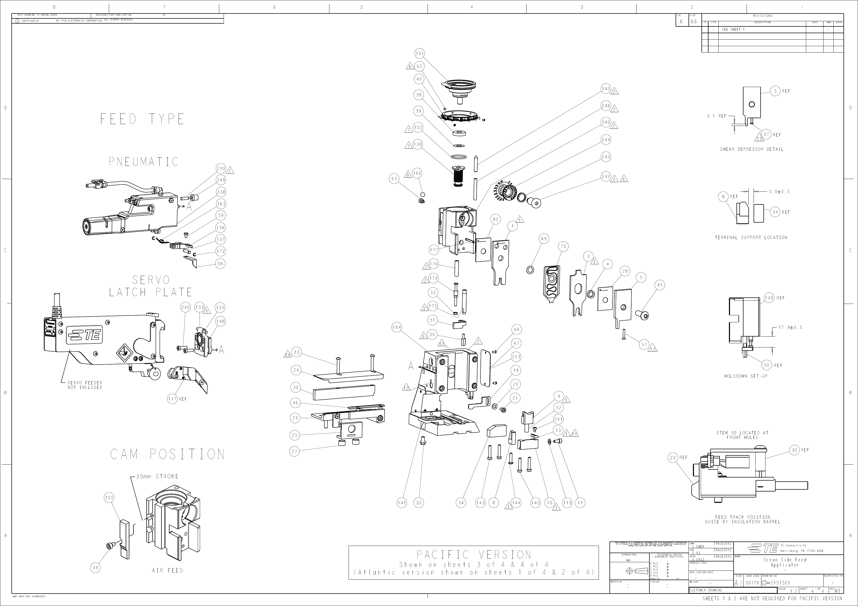

LOC
DIST
REVISIONS
LTR
DESCRIPTION
DATE
DWN
APVD
COPYRIGHT
66
SEE SHEET 1
251
62
38
145
REF
FEED TYPE
PNEUMATIC
250
249
238
163
59
136
137
39
152
246
140
3.1 REF
7 139
244
57
REF
243
63
166
242
5.0
REF
34
82
REF
69
177
176
174
52
172
56
28
41
140
REF
SERVO
LATCH PLATE
240
133
135
198
164
175
51
66
67
213
19
21
241
ITEM 30 LOCATED AT
FRONT HOLES
HOLDDOWN SET-UP
57
17.9
SERVO FEEDER
NOT INCLUDED
117 REF
33
REF
24
96
29
CAM POSITION
30mm STROKE
151
27
29
REF
REF
141
32
34
143
144
143
119
FEED TRACK POSITION
GUIDE BY
INSULATION BARREL
DWN
CHK
DIMENSIONS:
TOLERANCES UNLESS
49
AIR FEED
& 4 of 4
PACIFIC VERSION
C.CHEN
S.XI
I.CRUZ
29AUG2012
29AUG2012
29AUG2012
NAME
TE Connectivity
mm
APVD
& 2 of 4)
MATERIAL
0 PLC
1 PLC
2 PLC
3 PLC
4 PLC
ANGLES
FINISH
PRODUCT SPEC
APPLICATION SPEC
WEIGHT
CUSTOMER DRAWING
A1
SIZE
CAGE CODE
DRAWING NO
Ocean Side Feed
Applicator
2151501
SCALE
RESTRICTED TO
00779
SHEETS 1
1:2
SHEET
OF
REV
H1
