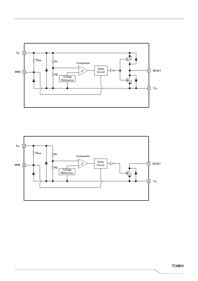

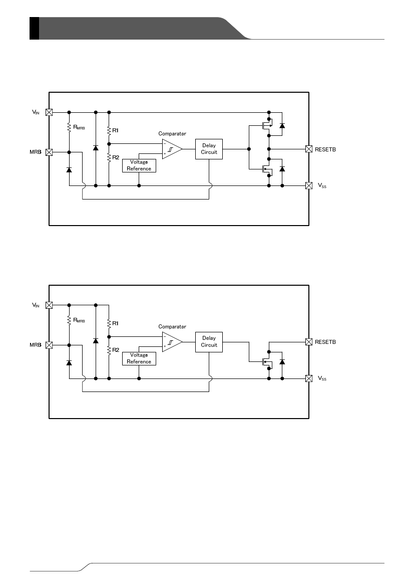

XC6127
■GENERAL
DESCRIPTION
XC6127 series is ultra small highly accurate voltage detector with delay circuit built-in.
ETR0217-007
Ultra Small Voltage Detector with High Precision Delay Circuit and Manual Reset Function
The device includes a highly accurate reference voltage source, manufactured using CMOS process technology and laser
trimming technologies, it maintains high accuracy, low power consumption, and accurate releases delay time over the full
operation temperature range.
The release delay time periods are internally set in a range from 50ms to 800ms.
Moreover, with the manual reset function, reset can be asserted at any time.
The device is available in both CMOS and N-channel open drain output configurations. Also detect logic is available in both
RESETB (Active Low) and RESET (Active High).
Ultra small package USPN-4 is ideally suited for small design of portable devices and high densely mounting applications.
The conventional packages SSOT-24,SOT-25 is also available for upper compatible replacements.
■APPLICATIONS
Microprocessor logic reset circuitry
System battery life and charge voltage monitors
Memory battery back-up circuits
Power-on reset circuits
Power failure Detection
Delay circuit
■FEATURES
High Accuracy
Temperature Characteristics
Low Power Consumption
Operating Voltage Range
Detect Voltage Range
Manual Reset Input
Output Configuration
Output Logic
Release Delay Time
Operating Ambient Temperature
Packages
Environmentally Friendly
±0.8% (25℃)
±50ppm/℃
0.6μA TYP. (Detect: V
DF
=1.8V, V
IN
=1.62V)
0.7μA TYP. (Release: V
DF
=1.8V, V
IN
=1.98V)
0.7V½6.0V
1.5V½5.5V (0.1V increments)
MRB Pin (Built-in Pull-up resistance)
N-channel open drain or CMOS
RESETB (Active Low)
RESET (Active High)
50ms/100ms/200ms/400ms/800ms±15%
-40℃ ~ +85℃
USPN-4, SSOT-24, SOT-25
EU RoHS Compliant, Pb Free
■TYPICAL
APPLICATION CIRCUIT
TYPICAL PERFORMANCE
CHARACTERISTICS
VCC
XC6127 series
IN
MRB
IN
RESET
SW
RESETB
RESET
μP
XC6127x27B½
Release Delay Time: t
DR
(ms)
115
110
105
95
90
85
-50
-25
75
Ambient Temperature: Ta (℃)
IN
=V
DFL
×0.9→V
DFL
×1.1 , MRB=OPEN
RESETB/RESET
INPUT
SS
VSS
CMOS output
Vpull-Up
VCC
XC6127 series
IN
MRB
IN
RESET
SW
RESETB
RESET
Rpull
μP
RESETB/RESET
INPUT
SS
VSS
N-ch open drain output
1/24
