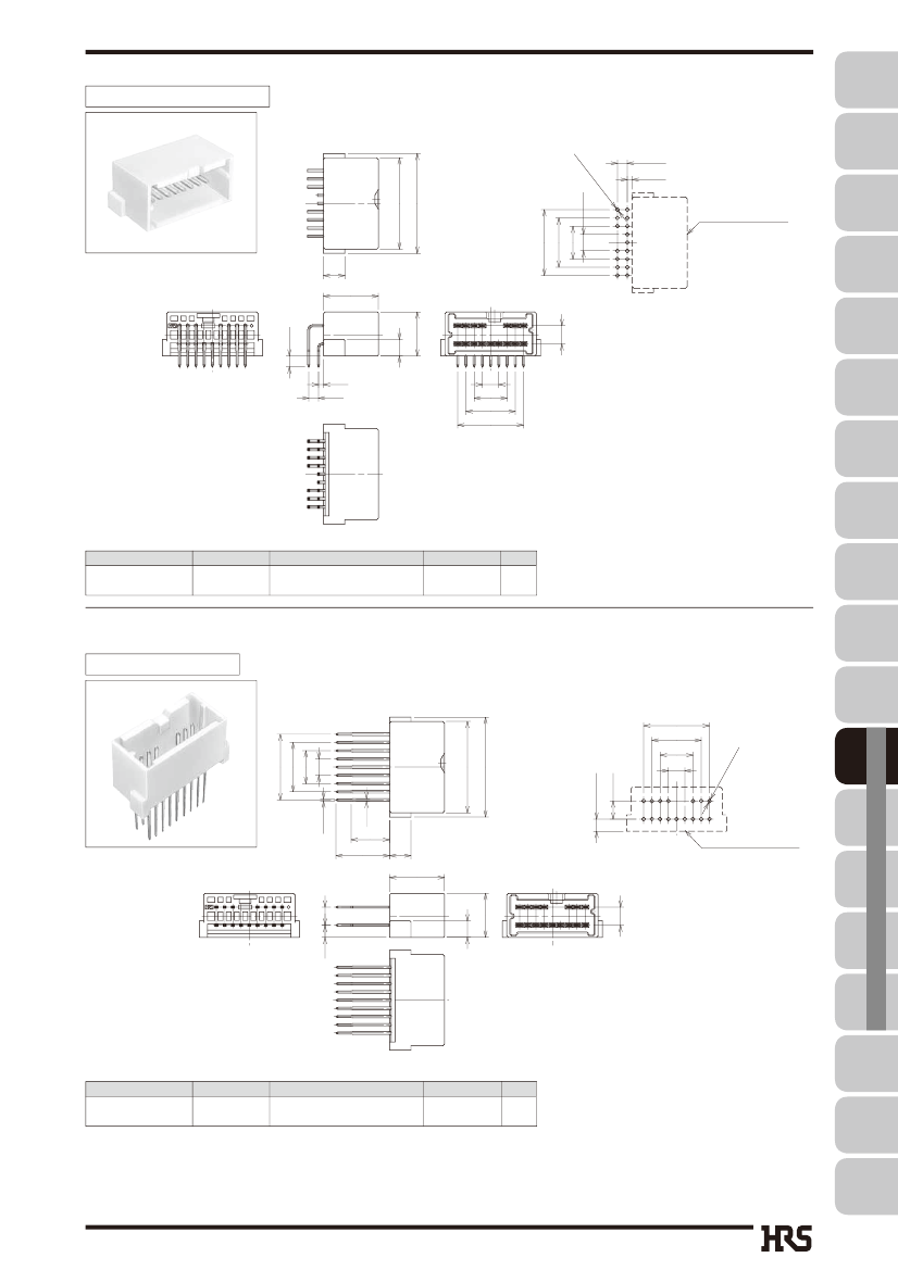

Interface Connector
Available in a low-profile (GT3) and a standard (GT3B) type.
Tab width is size 040.
173
GT10
GT18W
GT25
GT8E
GT9
GT15
GT3 Series
Interface Connector
GT5
M Connectors
Board mounting type
GT13
16 Pos.
16.9
GT16
Recommended PCB
pattern
32.5
26.5
PO5G
24.1
GT19
φ
Interface Connector
Jan.1.2018 Copyright 2018 HIROSE ELECTRIC CO., LTD. All Rights Reserved.
2.
0.64
φ
φ
5.2
GT21
3.
GT36
GT26
GT17
GT11
Part No.
GT3-16DP-2.5DSA(70)
GT3B-16DP-2.5DSA(70)
HRS No.
753-0001-6 70
753-0003-1 70
Material
Plating or Color
Housing
:PBT/
Black
Terminal
Brass
Tin plating
A Dimension B Dimension
17
19
Packaging
RoHS
YES
20 Pos.
Recommended PCB
pattern
16.9
GT3
GT32
37.5
31.5
GT7
29.1
GT10
0.64
φ
φ
φ
5.2
2.
3.
GT8E
GT25
GT18W
GT15
GT9
Part No.
GT3-20DP-2.5DSA(70)
GT3B-20DP-2.5DSA(70)
HRS No.
753-0002-9 70
753-0004-4 70
Material
Plating or Color
Housing
:PBT/
Black
Terminal
Brass
Tin plating
17
19
Packaging
2.5
RoHS
174
22.5
31.5
YES
2.5
17.5

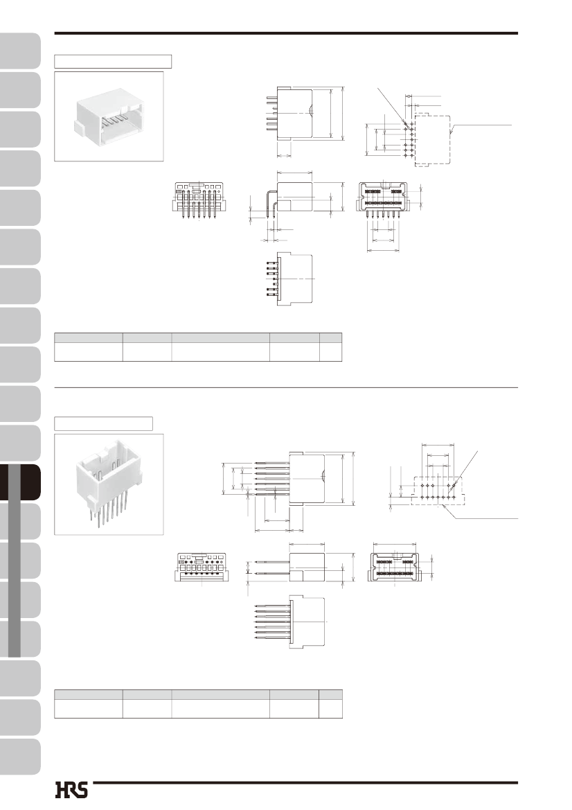

GT3 Series
Interface Connector
GT5
Board mounting type
Recommended PCB pattern
φ
8-
GT13
8-Pos. Right Angle
1.
GT16
17.8
20.4
GT3TK-8DP-DS
PO5G
6.5
16.7
GT19
GT3TK−8DP
13.4
3.3
5.5
GT21
GT26
GT36
Part No.
GT3TK- 8DP-DS
HRS No.
753 -0007-2
Material
Plating or Color
Housing
:PBT/
Brown
Terminal
Brass
Tin plating
Packaging
RoHS
YES
GT11
GT17
8-Pos. Straight
17.8
20.4
3.7
5.5
GT32
φ
8-
1.2
GT3
0.64
11.7
0.8
GT7
16.3
6.5
16.7
Interface Connector
GT3TK-8DP-DSA
GT10
GT3TK−8DP
13.4
5.5
5.5
GT18W
3.7
GT25
GT8E
Part No.
GT3TK- 8DP-DSA
HRS No.
753- 0018- 9
Material
Plating or Color
Housing
:PBT/
Brown
Terminal
Brass
Tin plating
Packaging
RoHS
YES
175
GT9
GT15

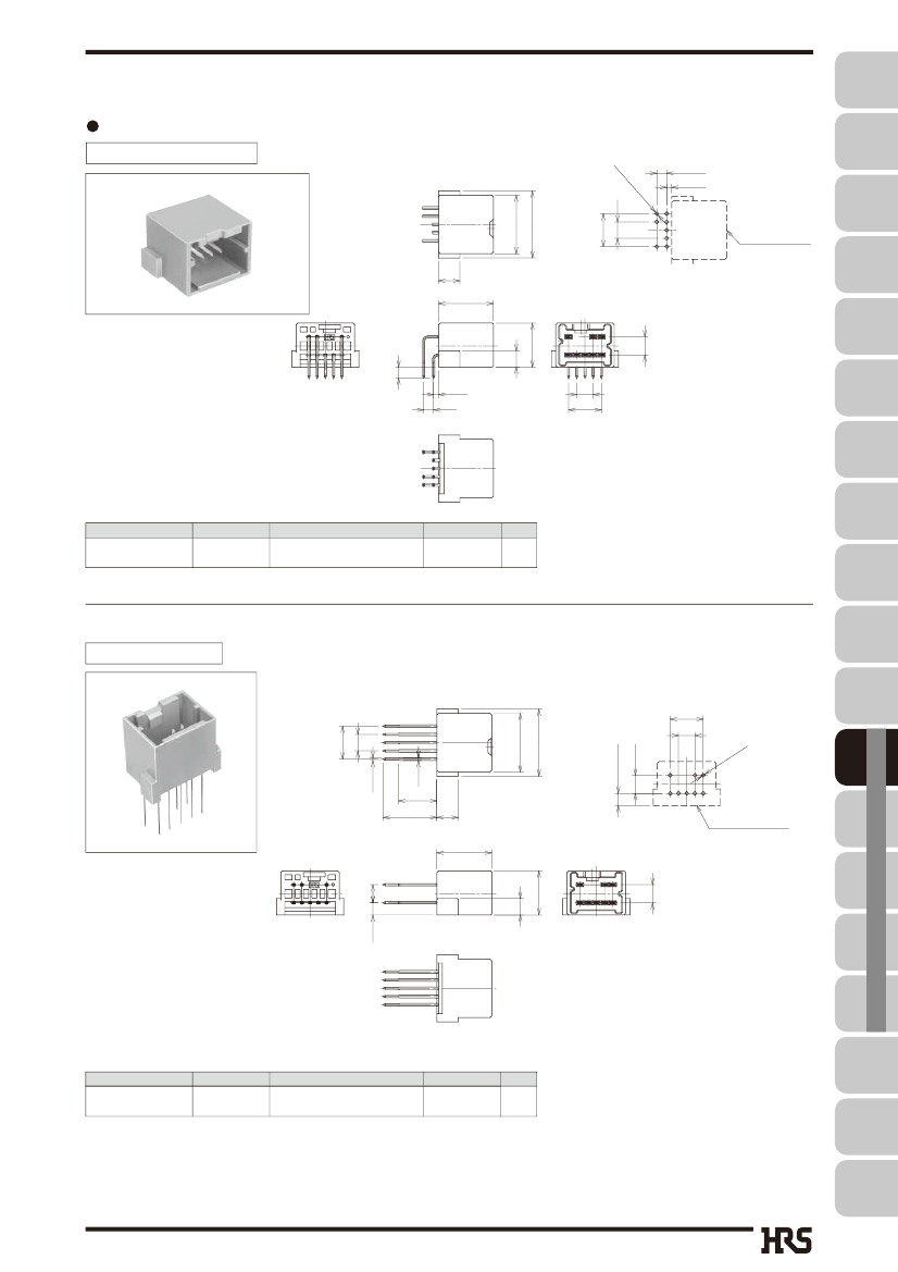

GT3 Series
Interface Connector
GT5
12-Pos. Right Angle
-φ
GT13
GT3TKW-12DP-DS
1.
22.8
25.4
GT16
6.5
PO5G
16.7
GT3TKW−12DP
GT19
Interface Connector
3.3
GT36
GT26
GT21
Part No.
GT3TKW- 12DP -DS
HRS No.
753 - 0010 -7
GT17
GT11
Material
Plating or Color
Housing
:PBT/
Natural
Terminal
Brass
Tin plating
Packaging
RoHS
YES
12-Pos. Straight
GT32
1.2
5.5
>PBT<
13.4
22.8
25.4
3.7
GT3
0.64
0.8
5.5
GT7
11.7
16.3
GT3TKW-12DP-DSA
6.5
16.7
20.4
13.4
GT10
GT3TKW−12DP
5.5
GT8E
GT25
GT18W
Part No.
HRS No.
753- 0015- 0
GT15
GT9
GT3TKW-12DP-DSA
Material
Plating or Color
Housing
:PBT/
Natural
Terminal
Brass
Tin plating
3.7
Packaging
RoHS
YES
176
5.5
>PBT<
-φ
GT3 Series
Interface Connector
GT5
16-Pos. Right Angle
1.
-φ
GT13
GT16
27.8
30.4
GT3TKW-16DP-DS
PO5G
6.5
16.7
GT19
GT3TKW−16DP
3.3
5.5
>PBT<
13.4
GT21
GT26
GT36
Part No.
GT3TKW-16DP -DS
HRS No.
753 - 0011- 0
Material
Plating or Color
Housing
:PBT/
Natural
Terminal
Brass
Tin plating
Packaging
GT11
RoHS
YES
GT17
16-Pos. Straight
3.7
5.5
GT32
GT3
27.8
30.4
-φ
1.2
GT7
0.64
0.8
Interface Connector
11.7
16.3
6.5
16.7
GT3TKW-16DP-DSA
GT10
GT3TKW−16DP
5.5
5.5
>PBT<
13.4
GT18W
3.7
GT25
GT8E
Part No.
GT3TKW-16DP-DSA
HRS No.
753 - 0012- 2
Material
Plating or Color
Housing
:PBT/
Natural
Terminal
Brass
Tin plating
Packaging
RoHS
YES
