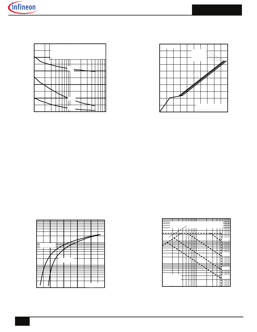

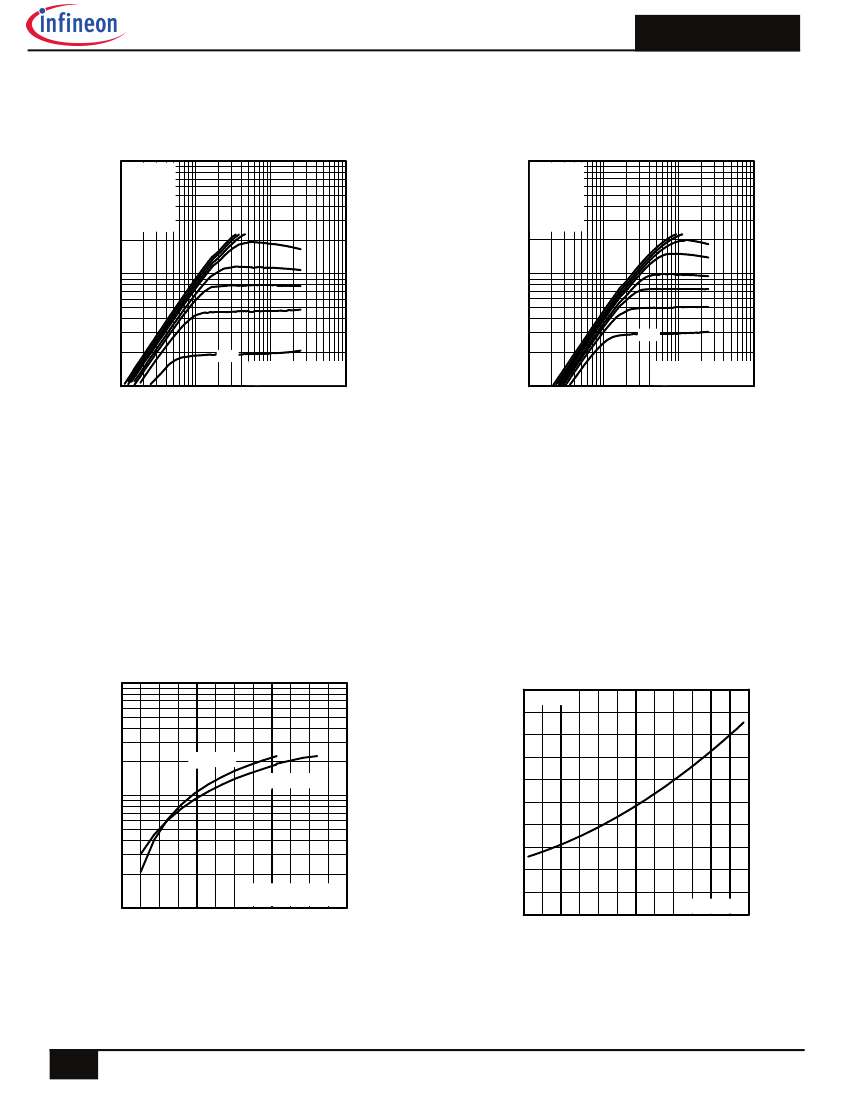

1000
, Drain-to-Source Current (A)
VGS
15V
10V
8.0V
7.0V
6.0V
5.5V
5.0V
BOTTOM 4.5V
TOP
1000
VGS
15V
10V
8.0V
7.0V
6.0V
5.5V
5.0V
BOTTOM 4.5V
TOP
4.5V
20µs PULSE WIDTH
= 175
4.5V
0.1
20µs PULSE WIDTH
= 25
0.1
DS
, Drain-to-Source Voltage (V)
DS
Fig. 1
Typical Output Characteristics
Fig. 2
1000
2.5
DS(on)
, Drain-to-Source On Resistance
(Normalized)
= 56A
2.0
= 25
= 175
4.0
V DS= 25V
20µs PULSE WIDTH
5.0
6.0
7.0
8.0
9.0
10.0
GS
, Gate-to-Source Voltage (V)
0.0
-60 -40 -20 0
GS
= 10V
20 40 60 80 100 120 140 160 180
, Junction Temperature
C)
Fig. 3
Typical Transfer Characteristics
Fig. 4
Normalized On-Resistance
Vs. Temperature
2015-11-19

Fig 5.
Typical Capacitance vs.
Fig 6.
Typical Gate Charge vs.
1000
1000
OPERATION IN THIS AREA LIMITED
BY R
DS(on)
SD
, Reverse Drain Current (A)
, Drain Current (A)
10us
= 175
100us
1ms
T = 25
0.4
GS
= 0 V
0.8
1.2
1.6
2.0
2.4
= 25 ° C
= 175 ° C
Single Pulse
10ms
SD
,Source-to-Drain Voltage (V)
DS
Fig. 7
Typical Source-to-Drain Diode
Forward Voltage
Fig 8.
Maximum Safe Operating Area

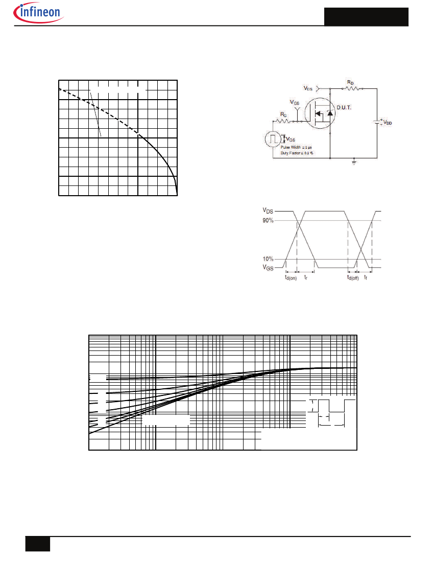

LIMITED BY PACKAGE
, Drain Current (A)
Fig 10a.
Switching Time Test Circuit
75
125
175
, Case Temperature
( ° C)
Fig 9.
Maximum Drain Current Vs.
Case Temperature
Fig 10b.
Switching Time Waveforms
Thermal Response (Z
thJC
D = 0.50
0.20
0.10
DM
SINGLE PULSE
(THERMAL RESPONSE)
Notes:
1. Duty factor D = t
/ t
2. Peak T
= P
DM
x Z
thJC
+ T
0.0001
0.001
0.01
0.1
0.1
0.05
0.02
0.01
0.01
0.00001
, Rectangular Pulse Duration (sec)
Fig 11.
Maximum Effective Transient Thermal Impedance, Junction-to-Case
