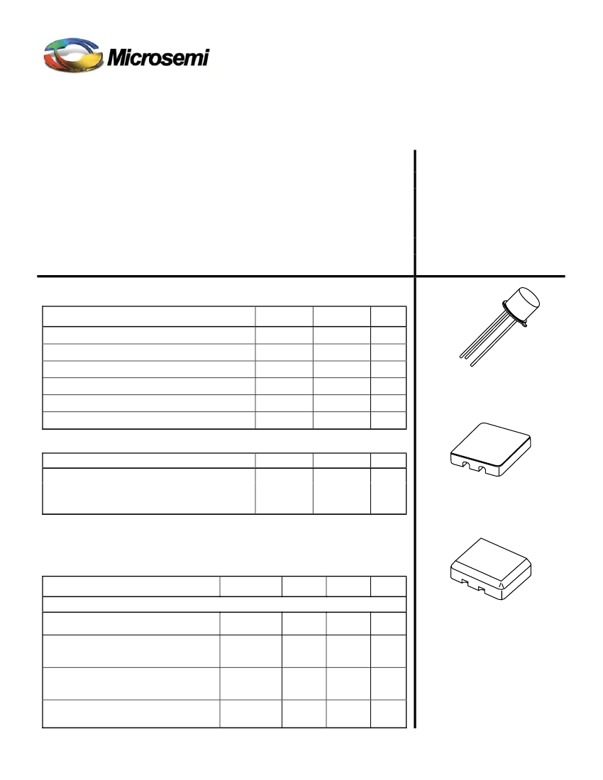

NPN SILICON SWITCHING TRANSISTOR
Qualified per MIL-PRF-19500/255
DEVICES
LEVELS
2N2221A
2N2221AL
2N2221AUA
2N2221AUB
2N2221AUBC *
Available to JANS quality level only.
2N2222A
2N2222AL
2N2222AUA
2N2222AUB
2N2222AUBC *
JAN
JANTX
JANTXV
JANS
ABSOLUTE MAXIMUM RATINGS
(T
= +25°C unless otherwise noted)
Parameters / Test Conditions
Collector-Emitter Voltage
Collector-Base Voltage
Emitter-Base Voltage
Collector Current
Total Power Dissipation @ T
= +25°C
Operating & Storage Junction Temperature Range
CEO
CBO
EBO
op
, T
stg
Value
75
6.0
800
-65 to +200
Vdc
Vdc
Vdc
mAdc
TO-18 (TO-206AA)
2N2221A, 2N2222A
THERMAL CHARACTERISTICS
Max.
325
210
325
°C/W
Thermal Resistance, Junction-to-Ambient
2N2221A, L
2N2222A, L
θJA
2N2221AUA
2N2222AUA
2N2221AUB, UBC
2N2222AUB, UBC
Note:
Consult 19500/255 for thermal performance curves.
1. Derate linearly 3.08mW/°C above T
> +37.5°C
4 PIN
2N2221AUA, 2N2222AUA
2.
Derate linearly 4.76mW/°C above T
> +63.5°C
ELECTRICAL CHARACTERISTICS
(T
= +25°C, unless otherwise noted)
OFF CHARACTERTICS
Collector-Emitter Breakdown Voltage
= 10mAdc
Collector-Base Cutoff Current
CB
= 75Vdc
CB
= 60Vdc
Emitter-Base Cutoff Current
EB
= 6.0Vdc
EB
= 4.0Vdc
Collector-Emitter Cutoff Current
CE
= 50Vdc
T4-LDS-0060 Rev. 2 (100247)
(BR)CEO
CBO
Vdc
μAdc
ηAdc
μAdc
ηAdc
ηAdc
Min.
Max.
3 PIN
2N2221AUB, 2N2222AUB
2N2221AUBC, 2N2222AUBC
(UBC = Ceramic Lid Version)
EBO
CES
Page 1 of 6
