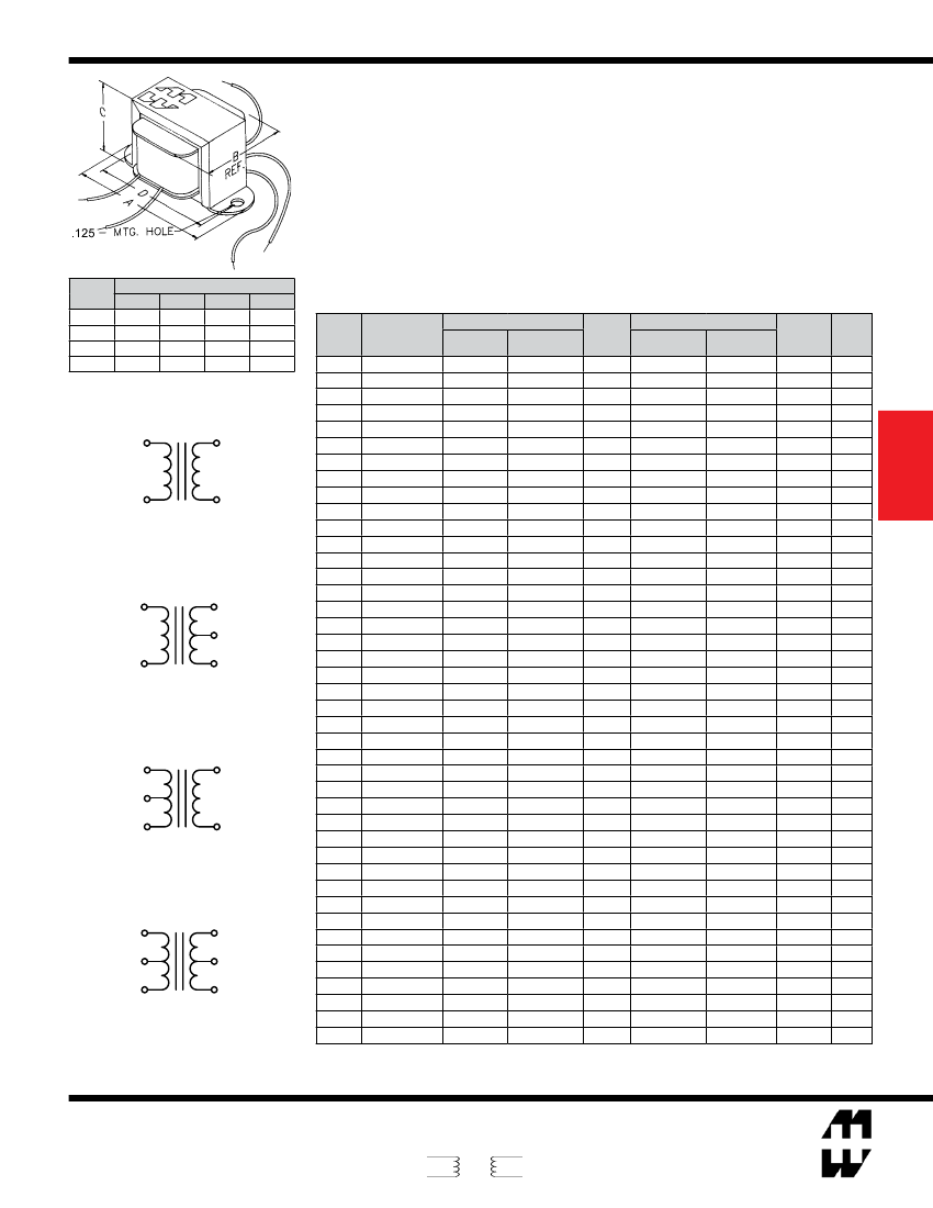

P.C. Board & Chassis Mount (140-141 Series)
LOW PROFILE - P.C. BOARD MOUNT
AUDIO TRANSFORMERS
Pin type (0.25" length & 0.035" diameter), P.C. board mount
Low profile, open type construction
Frequency response 200 Hz. - 15 Khz. (+/- 2 db, ref. @ 1 Khz.)
Net weight 0.6 oz.
PRI
SEC
Part
No.
141B
141D
141F
141H
141M
141P
Nominal Impedance
Primary
200K
3000 C.T.
25K
600 C.T.
30K
1200 C.T.
Secondary
1000
1000 C.T.
600 C.T.
1200 C.T.
Max. Pri.
D.C. ma
D.C. Resistance
Primary
3775
120
1645
32
1100
Secondary
85
51
65
45
47
0.45
Output
Milliwatts
Audio

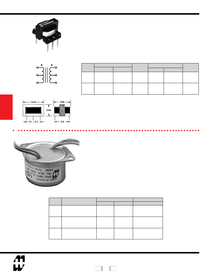

CHASSIS MOUNT - SHIELDED
AUDIO TRANSFORMERS
• Insulated leads 5" long minimum
• Stamped steel case (Diameter of 1.25" and height of 1") for excellent
shielding - low hum pick-up.
Frequency response 70 Hz. - 11 Khz. (+/- 1 db, ref. @ 1 Khz.)
• Case hole mounting centers are 1.6"
Net weight 2 oz.
Part
No.
140A
140B
140C
140H
140K
140M
140N
140P
140Q
Application
Voice Coil to Single Grid
Dyn. MIC. to Single Grid
MIC. to Single Grid
Bridging Line to P.P. Grids
MIC. to Single Grid
CRYS, MIC. to Base
Dyn. MIC to Base
Line to Base
Line to Line
Nominal Impedance
Primary
Secondary
60000
60000
60000
10000
40000 C.T.
60000
100K
1500
1500
150/600
600/2400
600 C.T.
600 C.T.
Overall Turns Ratio
Pri. to Sec.
1:122
1:45
1:34.5
1:2
1:2
8:1
1:5.5
1:2
1:1
