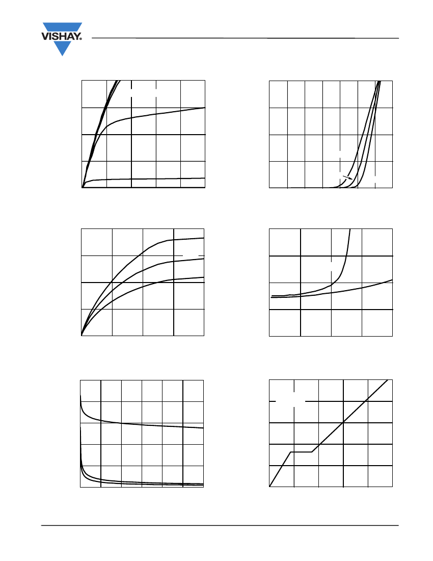

TYPICAL CHARACTERISTICS
25 °C, unless otherwise noted
GS
= 10 V thru 7 V
6V
- Drain Current (A)
- Drain Current (A)
= 125 °C
5V
25 °C
- 55 °C
DS
- Drain-to-Source Voltage (V)
GS
- Gate-to-Source Voltage (V)
Output Characteristics
= - 55 °C
g
fs
- Transconductance (S)
DS(on)
- On-Resistance (Ω)
0.08
Transfer Characteristics
25 °C
0.06
GS
= 6 V
GS
= 10 V
0.04
125 °C
0.02
- Drain Current (A)
0.00
- Drain Current (A)
Transconductance
4000
On-Resistance vs. Drain Current
GS
3200
C - Capacitance (pF)
iss
2400
DS
= 75 V
= 40 A
1600
800
oss
rss
75
125
45
75
DS
Q
g
- Total Gate Charge (nC)
Capacitance
Document Number: 72155
S09-1340-Rev. B, 13-Jul-09
Gate Charge
www.vishay.com
